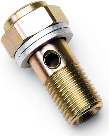

    Also, thanks O Silver Taco for the link on the banjo fitting. Didn't even think about these being a thing. Looks to be an easy tap solution that I'll end up using when I figure out the final method for monitoring.

    https://www.lceperformance.com/Fuel-Pressure-Gauge-Kit-2RZ-3RZ-p/2019121.htm
    but way easier and safer to install thru the fuel press reg fitting....instead of busting into the other end of the fuel rail......those factory fuel hoses are couple hundred each to replace......gentle with those...crispy with age...

    Thanks for the offer! I think I'll end up using the banjo adapter for the sensor port. And that setup sounds nice, but probably more than I want to spend and modify from stock.

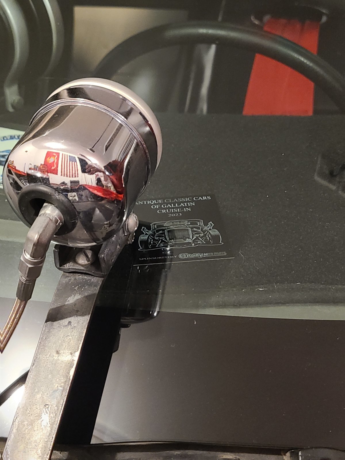

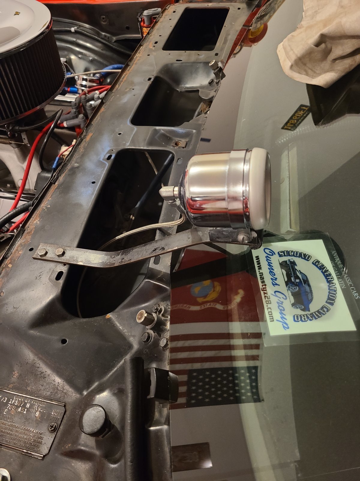

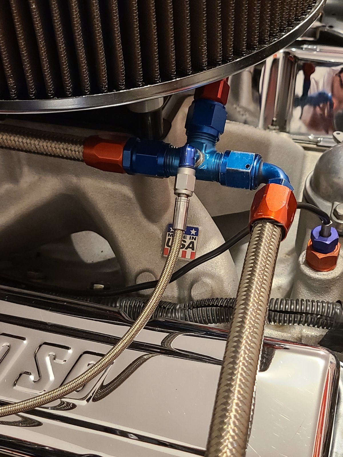

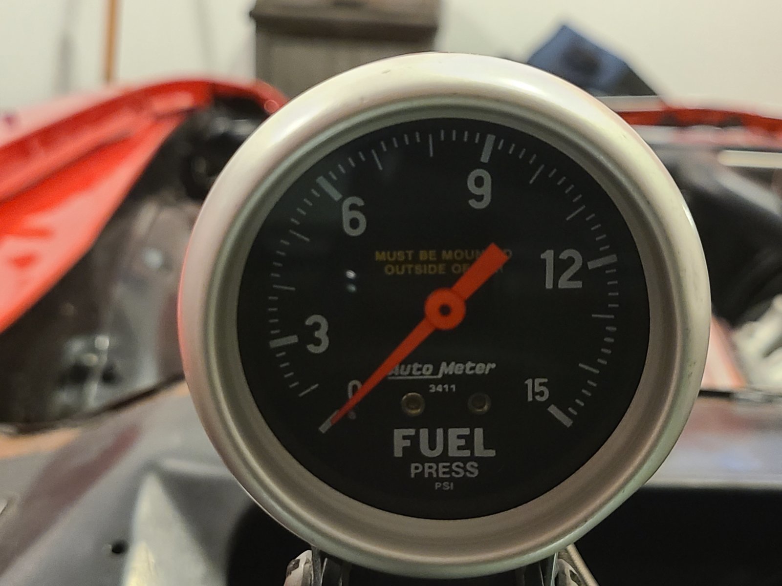

    You could use a set up like what I'm running on my Camaro . You can easily view fuel pressure while the engine is under load
    All the parts are available from Autometer and the Fuel line to the Guage is a -3AN hose
    The gauge is mounted outside on the cowl panel

    Another view of my fuel pressure gauge mounted on the cowl panel

    Thanks for the idea and pics. Afraid I'll get confused and swap in a SBC. Oops. Then I'd be doing burnouts at every stoplight. "Sorry officer, I was just on my way to get a fuel pressure gauge when the back tires made all that smoke." :burnrubber:
    Yabba Dabba don't think I'll be running a fuel line to the inside of my cab lol. But that IS a nice little gauge to keep in mind for the engine bay, considering the price.
