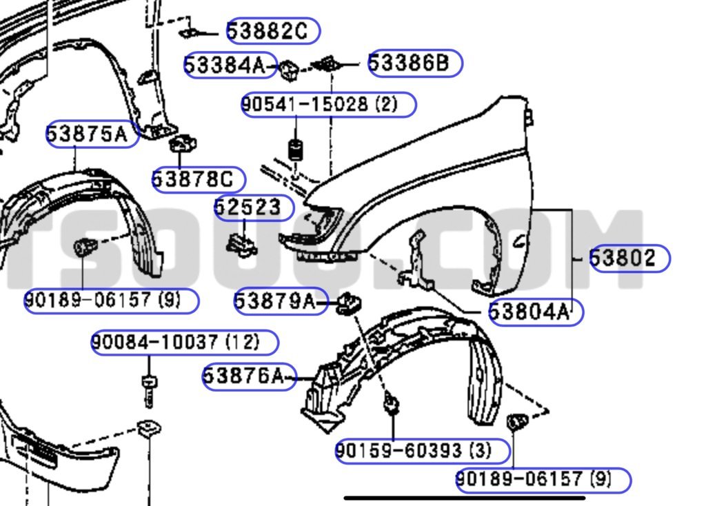

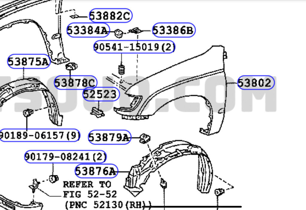

    I am wondering the same. I don’t care about the flare interchange, I just wanna know if the fender shape is the same for all 1st gen. Like: do 99’ 2wd 5lug front fenders and 02’ 4wd 6lug fenders have the same shape and fit? Not thinking about flare mounting.

    The part numbers are different between those years for me too when I do a junkyard search. But then I can compared an 96 ext cab to 02 ext cab on https://partsouq.com/en/catalog/genuine/pick?c=TOYOTA00&model=TACOMA&ssd=$*KwG07umNtbexAAAAAHMMl4c=$ and the part numbers were the same for fenders without flares.

    ugh, maybe I messed up. Well tomorrow I’ll be able to say more, I’ll be able to match them side by side.
    here is the two parts diagrams of 1995 - 00 and 01-04, maybe the part number change is just the addition of the support.

    After matching up I realized that starting in 2000 the bare fender had a small (2”) flat surface around the wheel wheel.
