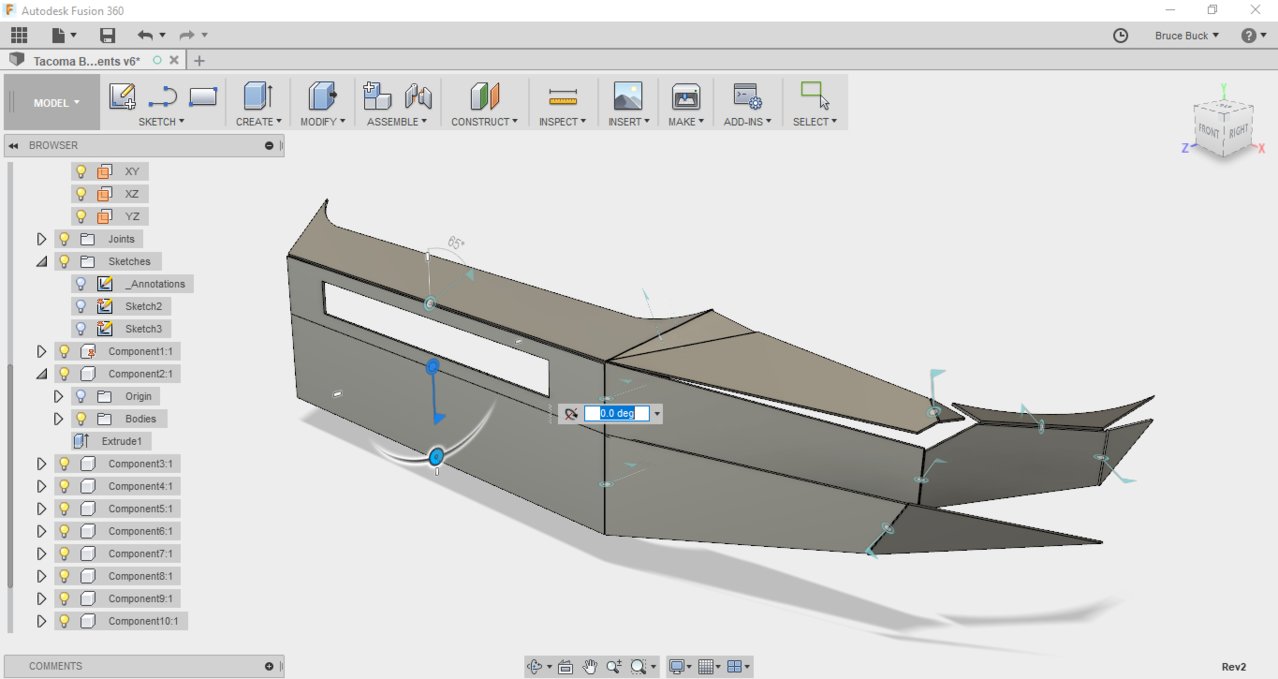

    i made a rough cad for the front bumper i built. It needs some work, but should be a decent start , hopefully. Is anyone interest in trying to finalize it? maybe some 3d modeling or something - im not to familiar with how bumpers drawings are typically made

    Just following up on this. I went ahead and took your drawings and started to model in 3D, but wondering about how the final shape was intended to look. It appears that the outer middle piece, the way it's cut, won't allow for the bottom row to fold in at an angle.
