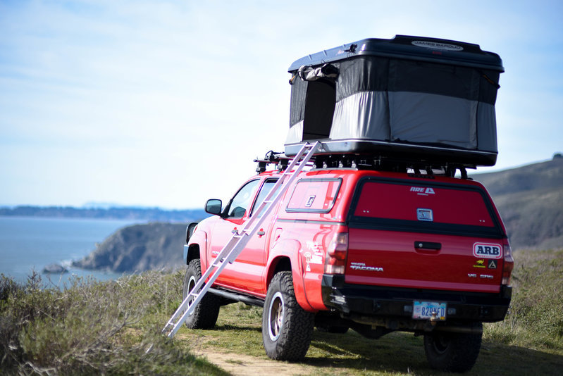

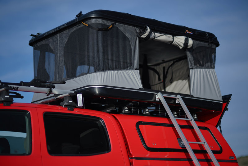

    my JB only weight 135 pounds plus my wife 130 and my kid 30 my self is 200 it over 500 static with two thule rack you will distribute the weight even no need for heavy and expense rack.DSC_2461.jpgDSC_2642.jpg

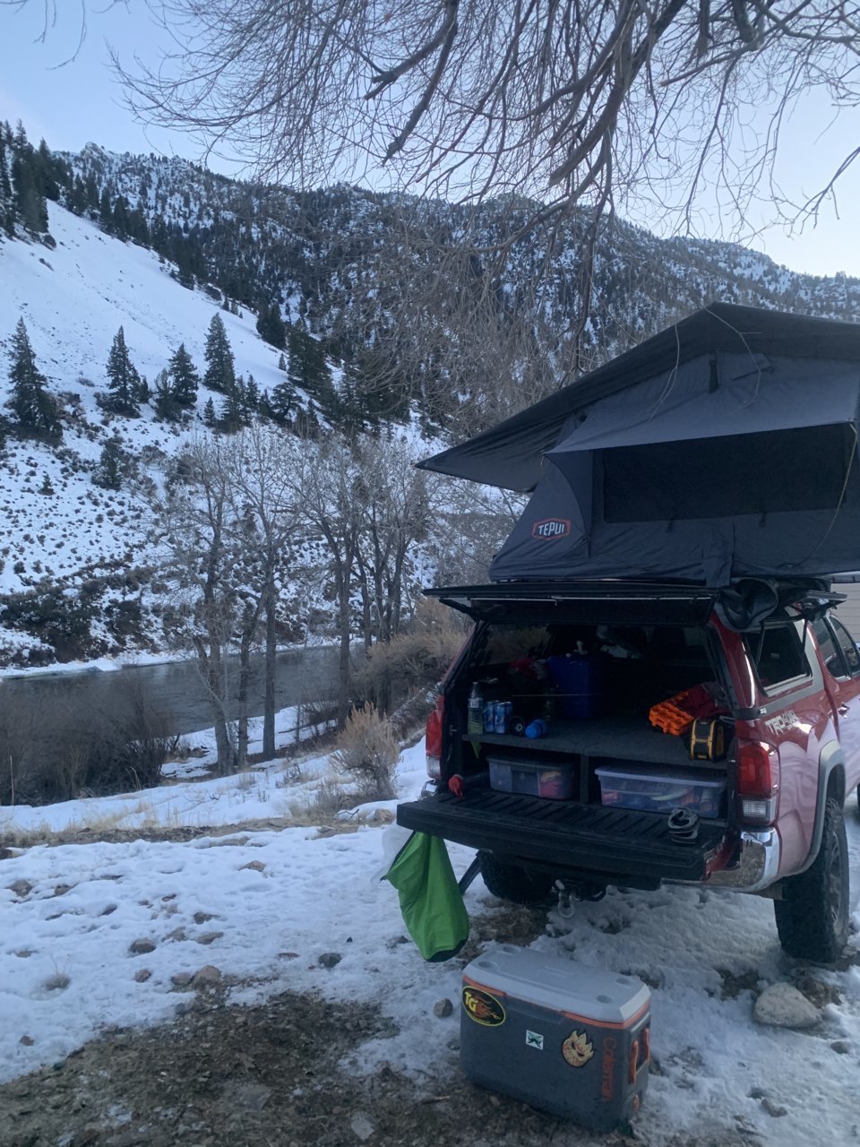

    2018 DCSB Barcelona taco
    So it’s on and holding strong so far. Took it on a 400 mile trip. Time will tell.CDE4AE4E-EC36-45F7-AC24-905DC4EA0C9A.jpg

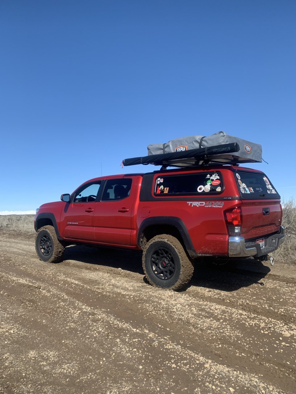

    14546A3A-6E23-476D-BFFC-37521310DAC1.jpg Here’s another pic.
