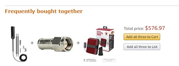

    Yea, thats why I was asking about the antennas being interchangeable. This little mag mounted antenna isnt really suited to be put on the end of a whip type thing and elevated. Im planning on reorganizing the roof rack some soon, have to see how I can finagle this thing for its max visibility. The older soda can antenna allowed for options, this one just doesn't.

    check out the OTR antenna. Its the most powerful one they make, omnidirectional and looks pretty rad. Couple that with folding mount...cherry set up IMO!

    that external antenna is legit!

    The newest version comes with that antenna

    for clarity, which is "that" antenna?

    The small shark fin mag mount one.
    The larger antenna kit showed up today. Trying to workout how to mount it in some adaptable way (allows flipping down when not in use)
    I'm guessing some sort of RAM mount.

    Looks good. Did you find that clip I mentioned on Last Line of Defense rig walk around?
