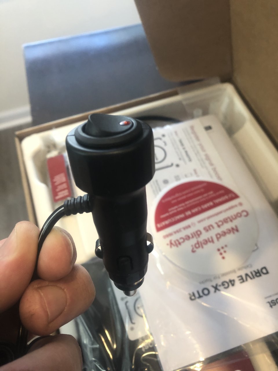

    Just got my 4GX-OTR and BAMF antenna mount the other day. Basically ready to install but looking for info on hardwiring the power cord. Has anyone done it? How have you run the power to the booster? With the kit comes a 12v plug with on/off switch but I’m looking to do something different.

    chuck you also asked about wiring. I clipped the lighter plug and went directly to my aux battery at first. But it had a pretty decent power strain when it was on all the time. So now it’s connected to my SPOD to power on with the ignition. Highly suggest that rout. This way it’s out of site out of mind.

    Great feedback, thanks so much. I was contemplating my own switch but tying into the ignition is a great way to go about it..

    Yep this way, no battery drain and it’s always running in the background

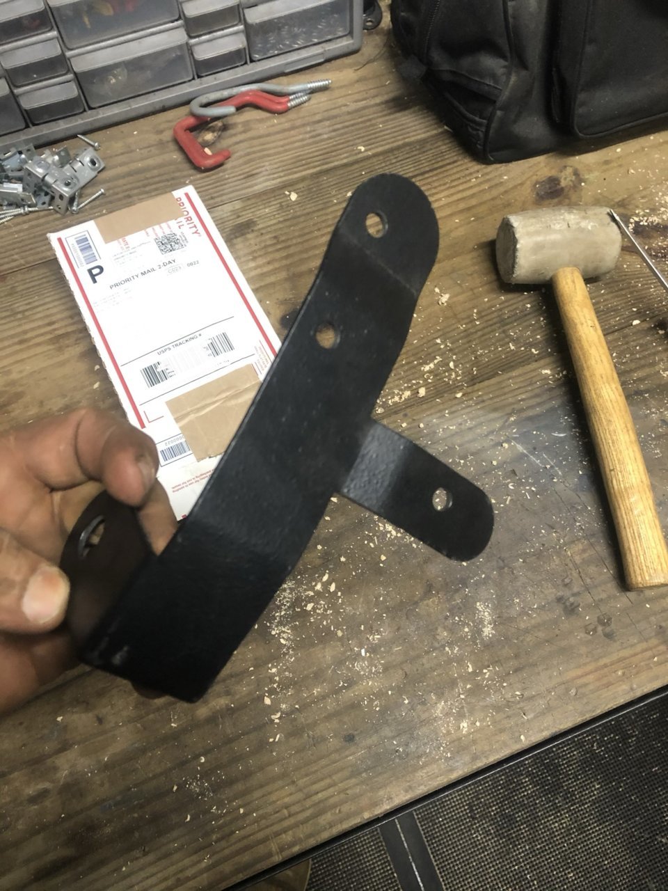

    Thanks for the thread and the photos of the install! I'm planning on doing the exact same thing with the truck antenna in the rear like yours. Right now i have a weBoost Drive 4G-M with a mag mount antenna next to the shark fin, and it makes a huge difference driving around Montana.
    Question for you, was the antenna cable long enough to route inside the cab? Any advice for getting the cable routed into the cab?
    Also, was the 5/8" through hole in the bamf bracket the right size for the weboost antennas? Did you use the antenna spring with all 3 sections attached, even though their manual says not to?

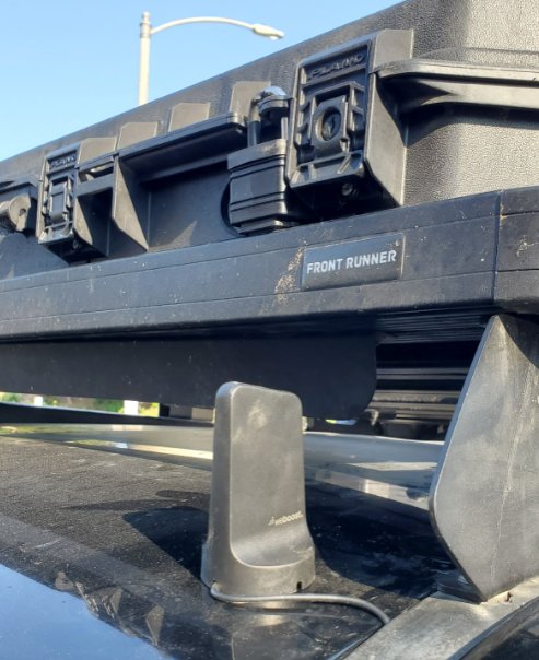

    I actually have the same roof rack. Interestingly enough, I ran the weboost the last 2 weekends in Mammoth and the eastern sierras Calif. and it worked beautifully mounted either right below the rack or just to the front of it. I was actually able to rescue a girl in a jeep who locked her keys in her car. I was able to call AAA from White Mountain trailhead (3rd tallest mountain in Ca). Course... they wouldnt come because "they dont drive on dirt" but it was a great test. Luckily I found the 4 bolts that hold the rear window in on a Rubicon JK and was able to rescue her nonetheless haha. I just had it temp mounted with the cables bunched up on the floor.
    I just finished semi perm cabling mine tonight as well. I ran the antenna cable under the roof left weather stripping, down the left side of the windshield molding, down into the engine bay and back through the firewall gusset, then along the kick panels, under the carpet to meet up with the main unit under the driver seat. There was just enough to do it. Probably have 4-6 in of slack, but it went in nicely.
    Ran some signal tests (LTE is shit by my house for some reason) and still got good results. So <shrug> will have to see how it goes.

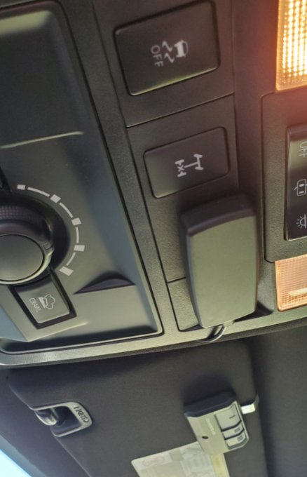

    also for the sake of info following this thread, I had a long talk with tech support the other day about INTERNAL antenna placement. There are a lot of variables mostly in relation to the internal and external antennas being on the same plane. For example, they can be in sight of each other but One should be higher than the other. The other thing I learned is the literature is a little misleading about internal antenna placement. Basically the closer you can get the antenna to your phone, the better. And it will vastly improve things. I’m considering mounting my internal antenna on my dash with Velcro, just behind my unholy ram
    Mount on my vent where the phone is 90% of the time. There is even space in the ram mount itself to slide it behind the phone itself.

    Here is how I mounted the 2. Inside and out respectively.

    I think your internal antenna is fine, especially if you are holding the phone to your right ear while driving. If its in a cradle, measure the line of sight between the two. Closer the better remember (and touching phone and antenna is great!).
    You are not working at full capacity with your external antenna though, and I would highly consider moving it. These are omnidirectional antennas so they are always looking for the closest, strongest cell tower to hop to. Therfor, the extrenal antenna should be unobstructed 360 degrees- meaning, highest point on the truck. Right now, you are missing half of the antennas peek performance. Remember that the signal is not going to the sky to a satelite, its going at a horizontal plane from the cell tower to that antenna. Its hard to tell what is on your rack besides the peli/plano case, but if you tend to carry high loads such as RTT or whatever- they indeed will block your antenna. There was a youtube video of Mike from Last Line of Defense where he did a rig walk around and talked about his fold down/flip up booster antenna. worth a look.
