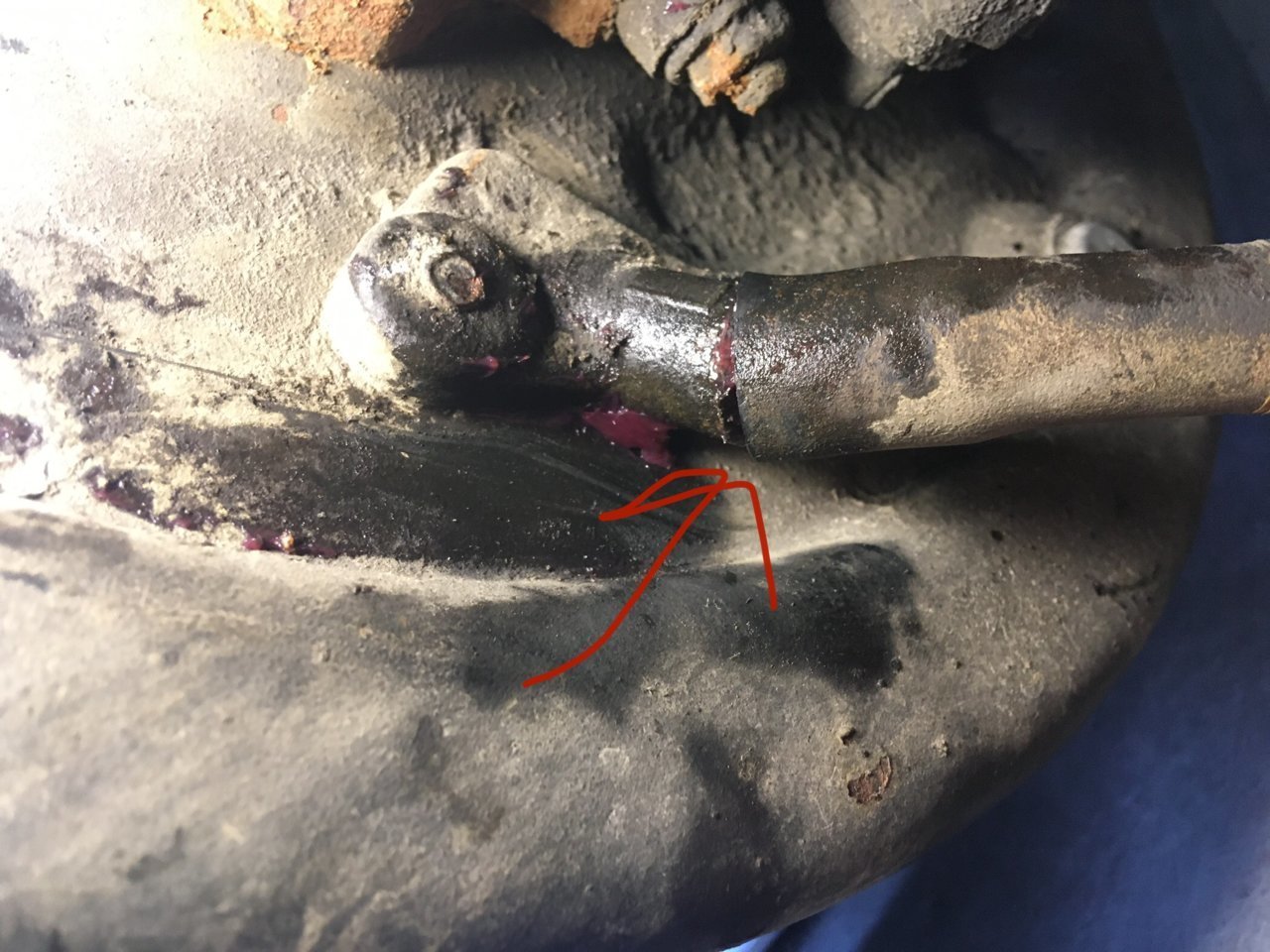

    Every 2nd gen has the broken cable housing here, and lots of techs miss it.
    I let the owners know but I never push hard. They suck to change and have little gain to the ebrake unless there's complaints like this.

    Yeah, I guess I’m luck to live on the south east.
    I think I have pictures floating around of my cables somewhere on this forum.
    I remember a member need picture of the, for something.
    Someone actually commented that they couldn’t believe mine were broken yet. :rofl:

    Dagnabbit, @Bishop84! After a statement like that, I had to go prove you wrong by checking my cables while I did a brake inspection and adjustment… BOTH BROKEN! :annoyed:
    But like you said, if not causing issues can be let go for a while. But I’m going to do my rears fairly soon so the cables will get ordered forthwith.

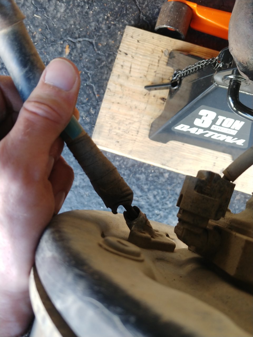

    If you pull on the outside of the cable and it looks like this, your parking brake probably isn't doing much :D

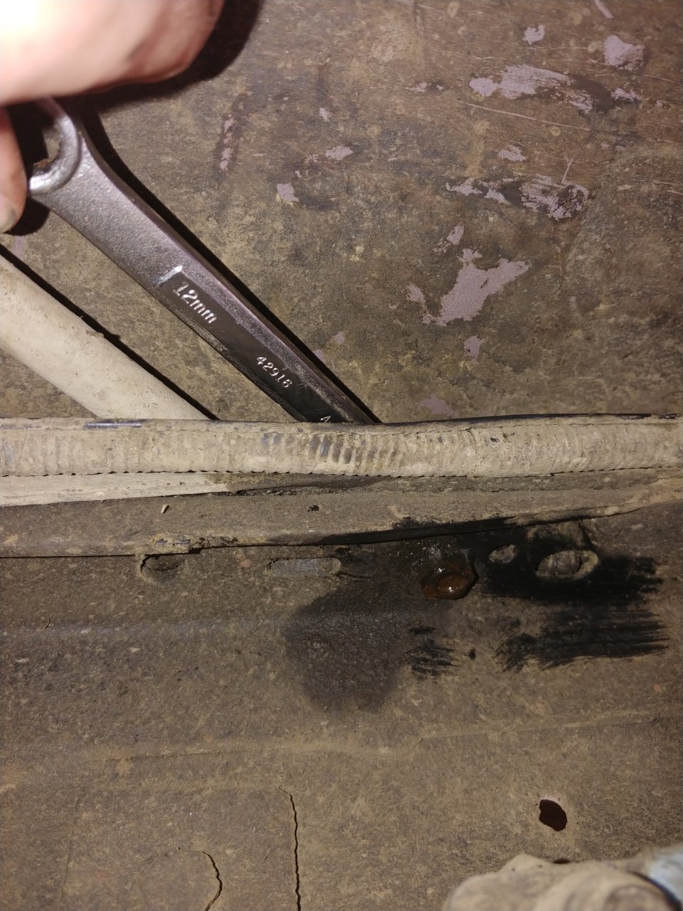

    Anyone who is thinking of doing this job, for the love of god make sure you have a ratcheting 6pt 12mm wrench and lots of PB blaster on hand. Honestly one of the shittier jobs I've had to do on this truck because of that bolt going down through the top of the frame under the rear of the cab. No room to work or see, rusted in, and of course covered in every bit of mud and dirt ever driven through.
    Edit: Sure its not as bad of a job if your dont live in the salt belt and dont drive thousands of miles of dirt roads every year haha

    I went out and snapped a pic but you and @TnShooter beat me to it. Basically the same picture.
    Mine still functions pretty well. Nevertheless, I have a new set of cables from Rock Auto to put on when I go through the back brakes; OEM were unobtanium. Two online sites let me order them, but both canceled the order after the fact.
