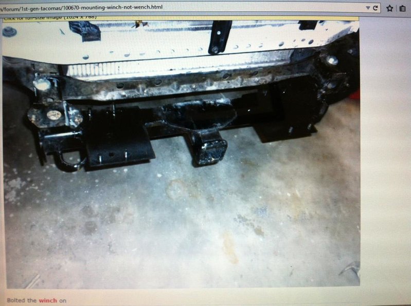

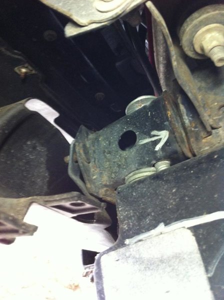

    On my 2003 one of the 3 mounting holes, the one they tell you to enlarge that isn't one of the original tow hook mounts, didn't line up at all so I had to drill a new hole in the frame. My goal, maybe, is to do something like this:
    The guy that did this started with the same receiver as linked above and welded on some mounting plates for a winch :)
    HawaiianTaco18 likes this.

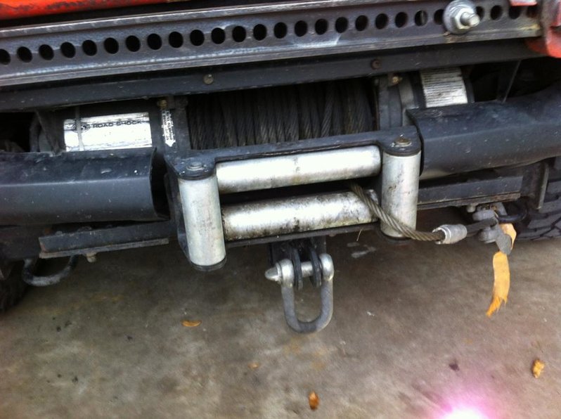

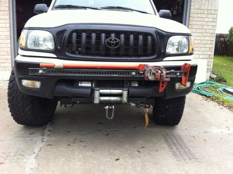

    Here are some pictures. First one is the winch mount plate (front receiver).
    It shows the bar behind the winch mounting area. This bar is the front mounting point for the skid plate under the front of the engine.
    Second picture shows the fair lead sticking thru the plastic.
    Third picture shows a end view of the bar.
    The bumper is well supported. I hung a High Lift Jack off it. The plastic below the bumper is supported mainly by the bumper. It is very rigid but the plastic did lose some mounting points on the lower part of the plastic. But I have had no problems with the plastic mounting.
