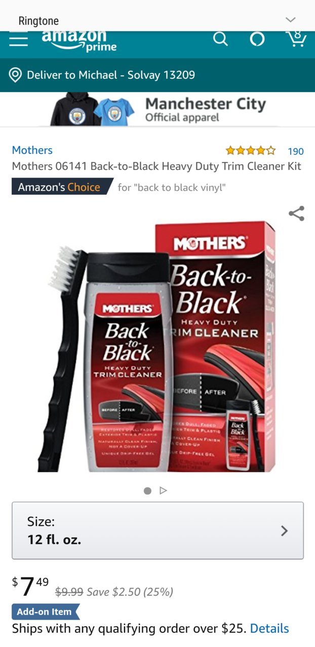

    I'm always very carefull when waxing or sealing but these things happen and I'm not into all the prep work of taping etc. I've had great luck with this in the past. Just make sure to put a protectant on the plastic afterwards. Screenshot_20190107-121943_Amazon Shopping.jpg
