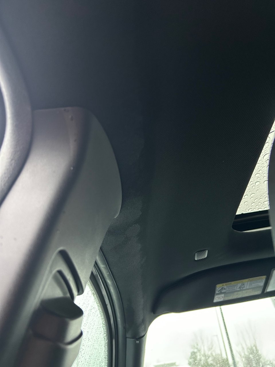

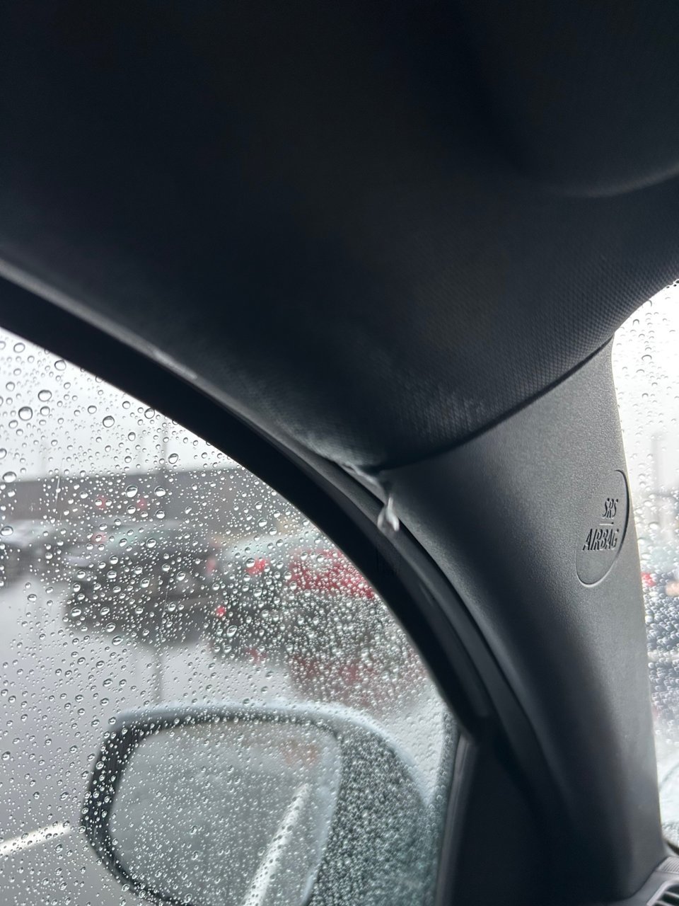

    Truck sat in some heavy rain all day. Got in the truck and immediately noticed water dripping at a good rate from the driver's side A-pillar. Headliner was soaked all the way back to the back seat, past the b-pillar. I don't have a roof rack, so I'm assuming it's the driver's door seal. Anyone have experience replacing or have a similar experience?

    First guess is the sunroof drain tube somehow became disconnected at the top. The drain tube runs down the A-pillar behind the plastic trim panel.

    Drains look clear. There's only two right - One in each front corner? Brake light assembly has been done.

    Hmm. Would I be able to see that tube from the sunroof or would the A pillar need removed?

    Took me a while, could not for the life of me find if there were more than just the 2 drain tubes in the front. Found this diagram you posted on another thread. Saw there's another in the rear. Pulled the headliner down just a little when I had the sunroof up, and sure as shit, I can see the end of the drain tube sticking up. Must have randomly became disconnected, and water ran the whole way down to the a-pillar. Anyways, really appreciate the help! Guess I'll be dropping that headliner this weekend :annoyed:

    You may want to remove that driver’s side plastic pillar and do a visual to make sure water didn’t get in the air bags in that area. Also some on here have suggested using a portable dehumidifier to be safe.

    OP, may want to disconnect the battery, remove the driver's side kick panel, and make sure the body control module and fuse box didn't get wet.
