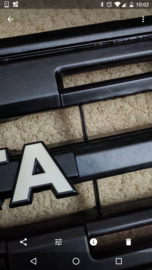

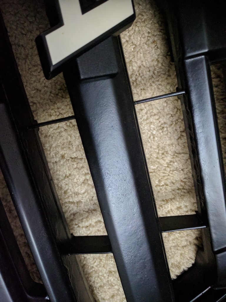

    I have been working of modded grille. I feel like I should just either give up and buy a pro grille or hire a professional to finish my project for me.
    I sprayed the grille after finishing the mods and got all kinds of weird bubble textures, so I peeled all the Plasti dip off and started over.
    I followed all YouTube directions a second time and still got weird textures, and now, since I sprayed on 12 heavy coats, there a noticeable paint runs. Even though I sprayed very close and made sure it looked wet with every coat, I still got funky textures... is there anything I can do?
    Screenshot_20171015-220211.jpg IMG_20171015_215559.jpg IMG_20171015_215533.jpg

    Plasti dip spray is no automotive paint. its not going to lay down in a perfect coat like out of a top notch spray gun. its rattle can work. i did the inside of my rear bumper and it is similar.
    I think the grille looks pretty good from here. hard to tell in the photos.
    when i used plasti i did many many many super thin layers to avoid any runs or drips. it took a lot longer but it built up smoother maybe?

    I've plastidip'd a lot of stuff. To me it looks like you were too close and way too thick of coats.
    For a smooth look I'd stick around ten inches away and do a bunch of medium coats. I've usually done 4-5 coats and mine has always peeled fine.

    Stand further back as you spray,
    The first couple base coats I always do light misting spray
    Also make sure the can is shaken up very well along with making sure the can is not cold.
    Tried dipping some wheels once in my garage during winter when the cans were cold, & they turned out similar to how your grill is looking. Not bad just not that nice textured look we all go for.

    Spray light coats, I´m talking barely even cover the part on each coat for the first two coats. After that you can go a little heavier. A total of 6 coats should be enough.
    Shake the can really well before and during the spraying.
    After each coat, turn can upside down and spray a little to clear the nozzle, if you don´t, the next spray will have dried plasti-dip dots in it.
    Keep the can in a bucket of warm water between coats.

    You need to follow my "10-10" rule for everything cosmetic on a vehicle. What does that mean?
    It needs to look good from 10 feet away or going past you at 10 mph. That's it. If you get close enough to ANYTHING you will see imperfections.
    Your pics are too close so no wonder we see imperfections! Take a pic of your grille from 10 ft away. I bet it looks good.

    I was only only 2-3 inches away...ugh...
    Plasti-dip is counterintuitive to work with especially because I used to krylon and acrylic airbrush.
    Thanks everyone for all the great replies. I think I will just mount it, and see how I feel.about for a week.

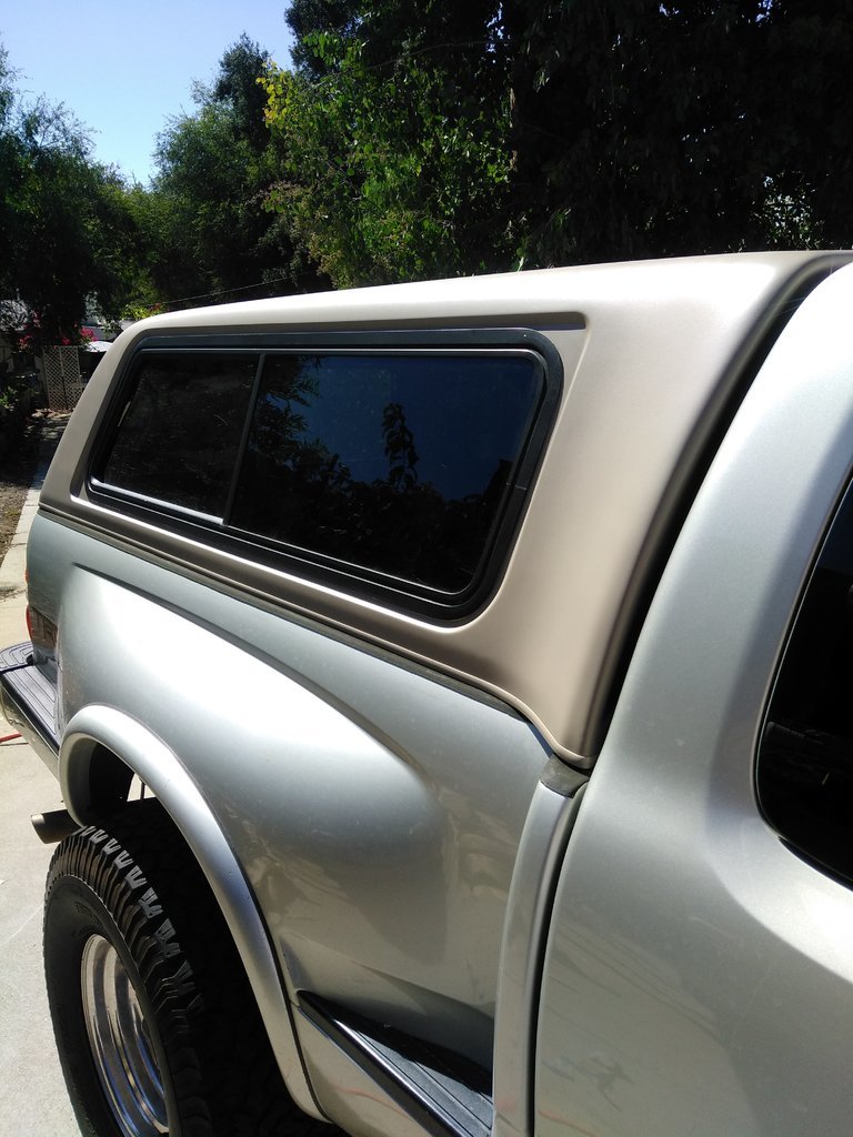

    I just put 5 cans of Plasti dip on my camper.
    I held the can about a foot away and just went over the whole thing until I used all the cans. No runs or drips or weird texture for me. It was about 80degrees outside at the time I was painting.
