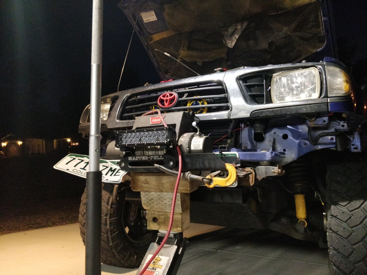

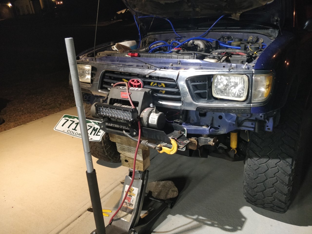

    Has anyone mounted a Warn XD....i series winch on their truck?
    It seems like depending on the placement it could require trimming the grille and maybe even the lower core support.
    I have an XD9000i with synthetic line and need a new front bumper for my truck so Im curious to see what my options are. I wouldn't be opposed to fabricating my own mount and using a factory bumper

    Yes, if you use the “i” winch, you will need a bumper with an open top and you’ll need to trim the grill like I did

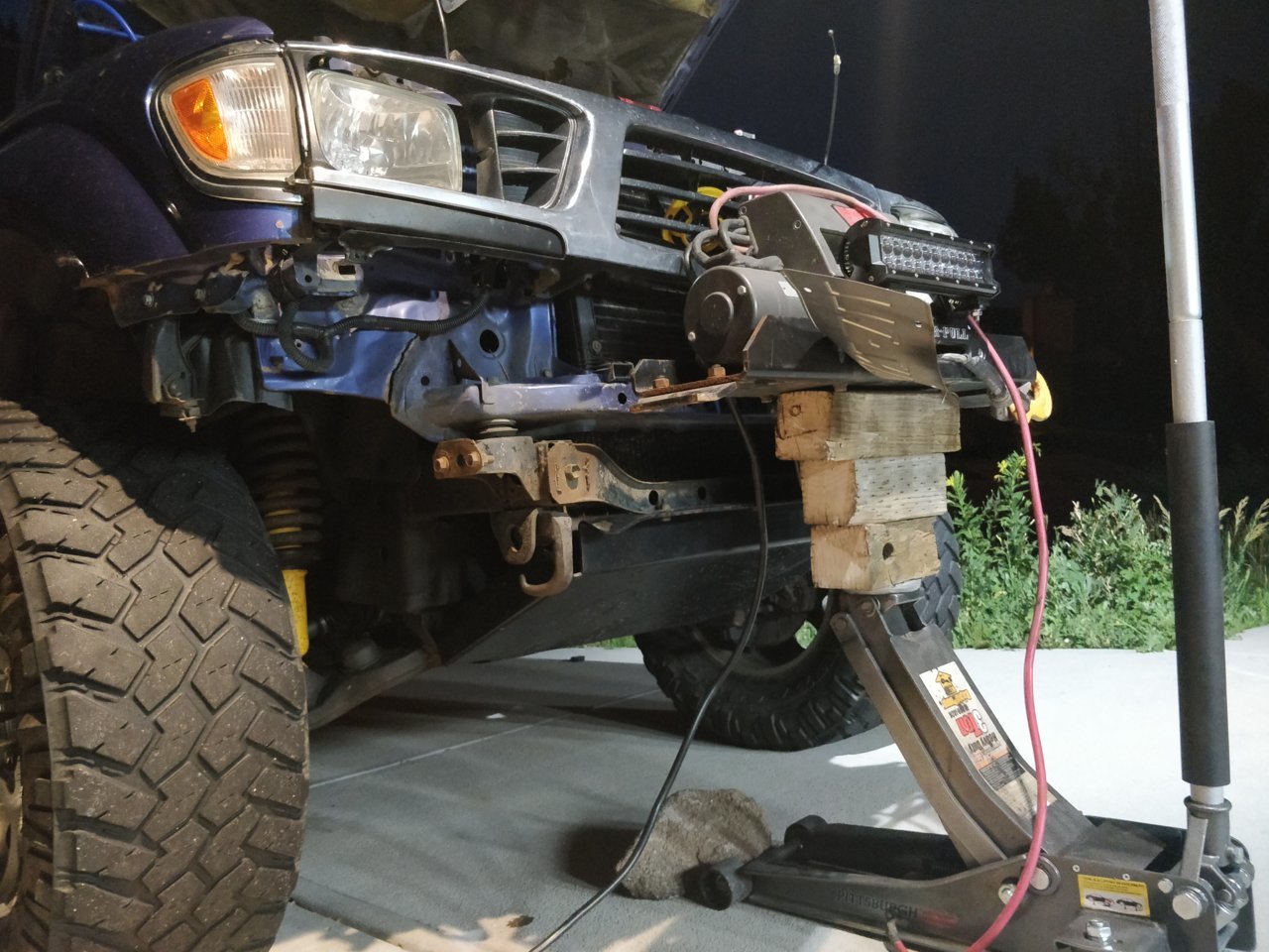

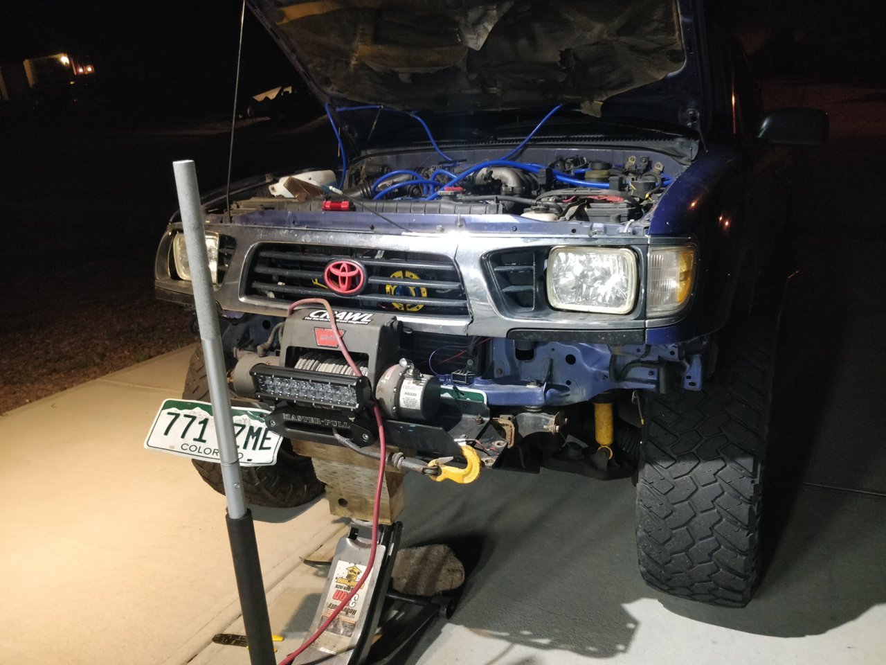

    Did you need to trim the lower core suposup at all? It looks like it clears ok from your pics.
    I haven't decided whether I will build my own or buy a bumper. If I build it I might push the wonch forward a bit to minimize cutting

    What do you mean lower core support? The plastic legs that clip into the metal in front of the radiator?

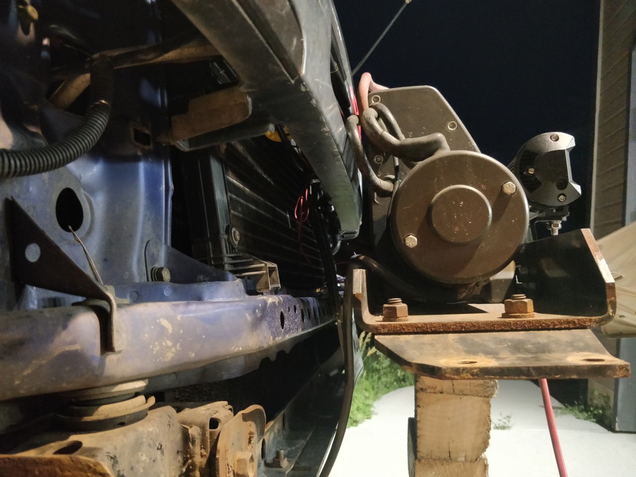

    The lower horizontal support here:

    Nope, no metal trimming is needed. Only have to chop off the plastic that clips into it

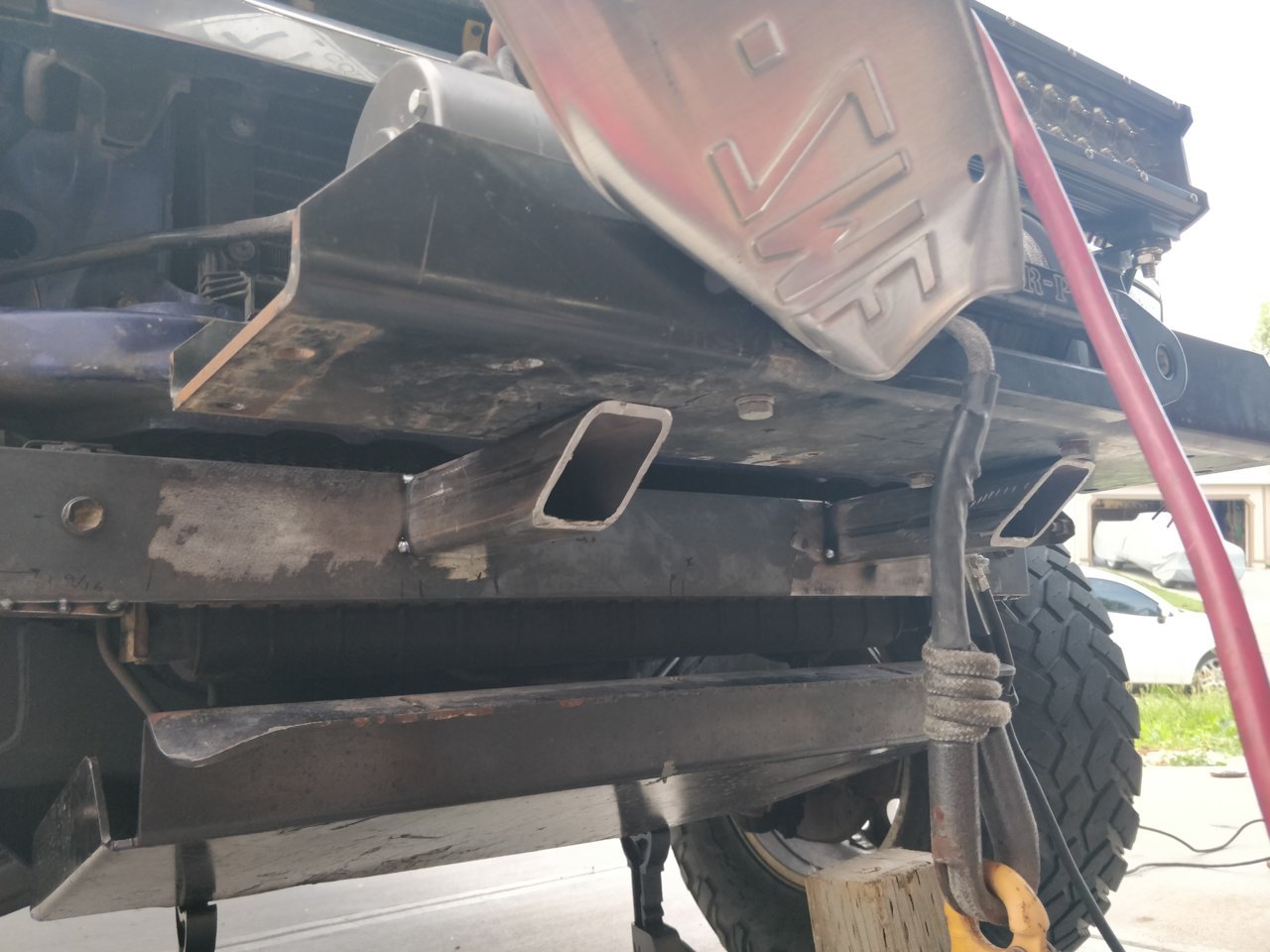

    Remember the further out in front you make your bumper, the more potential you will have on dragging the nose on sharp uphill inclines. I prefer it high and tight

    True. I ended up with it a little on the low side but it shouldn't be too bad, seems about on-par with most of the aftermarket offerings, anyways. Still a WIP (going to add some hoops and tie in to the outer bumper mounts):
