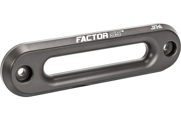

    8,000, with snatch block, synth line. A new roller fairlead is fine with syth, one used for cable will be gouged and abraid your synth line. If using a hawes fairlead on an ARB bumper, you may need to find one with offset mounting holes.

    Thanks, could you please elaborate on "you may need to find one with offset mounting holes" "one"??? refers to ???

    See how the main hole is offset from the bolt holes? This is because ARB uses an offset opening in their bumpers. It's an ideal setup that doesn't create a side load on the rope.
