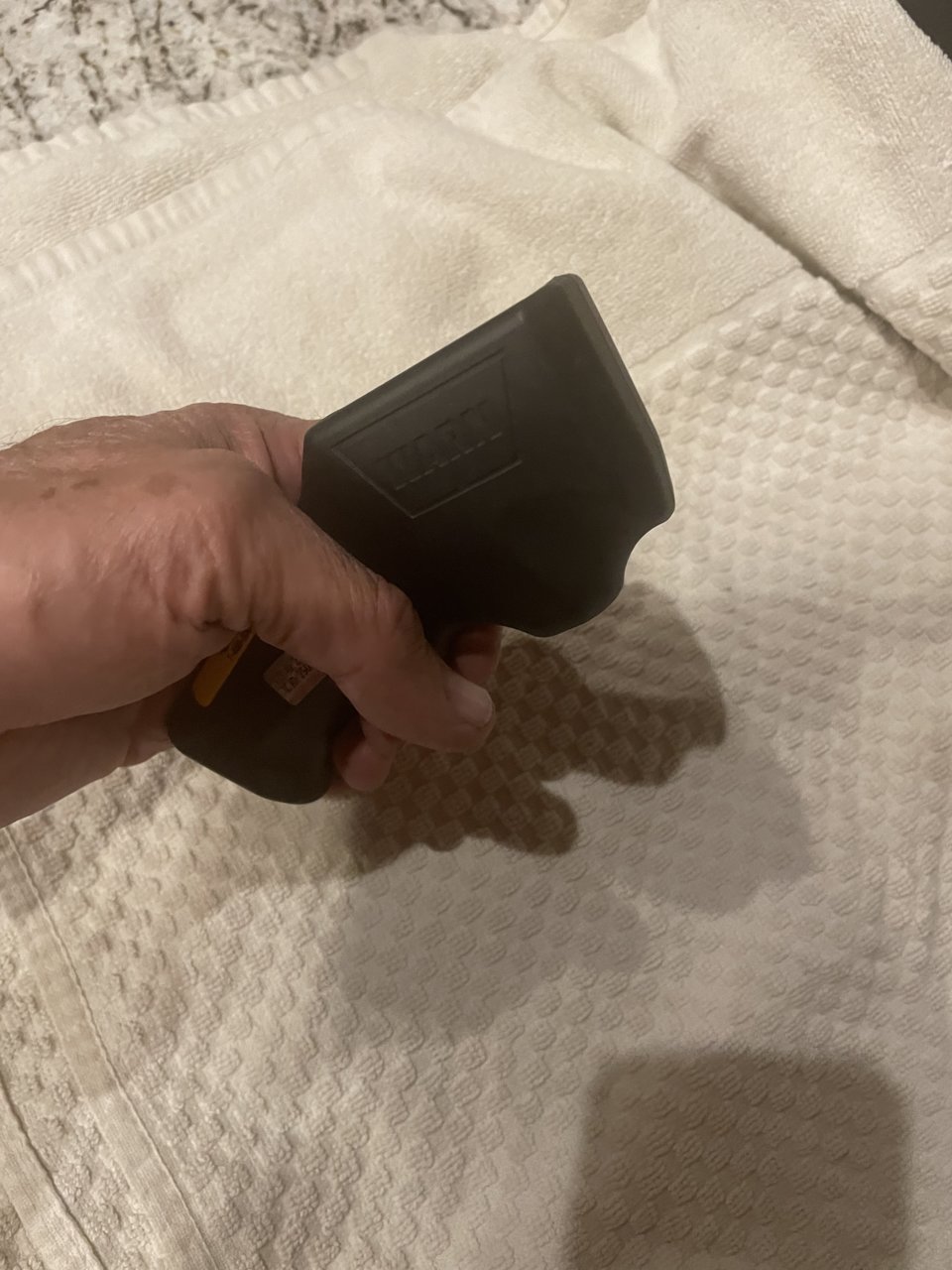

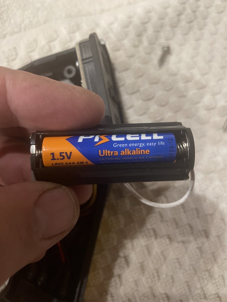

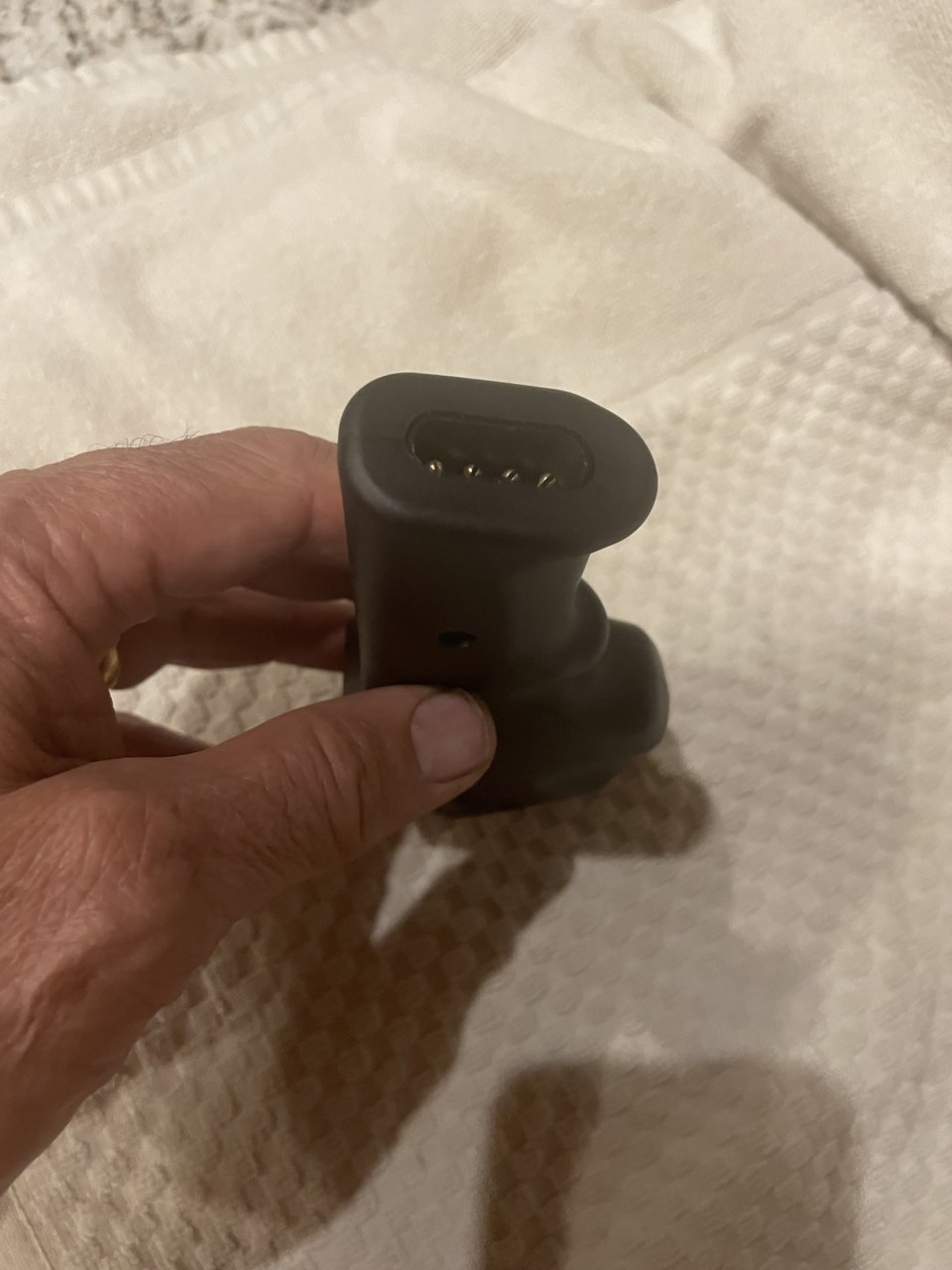

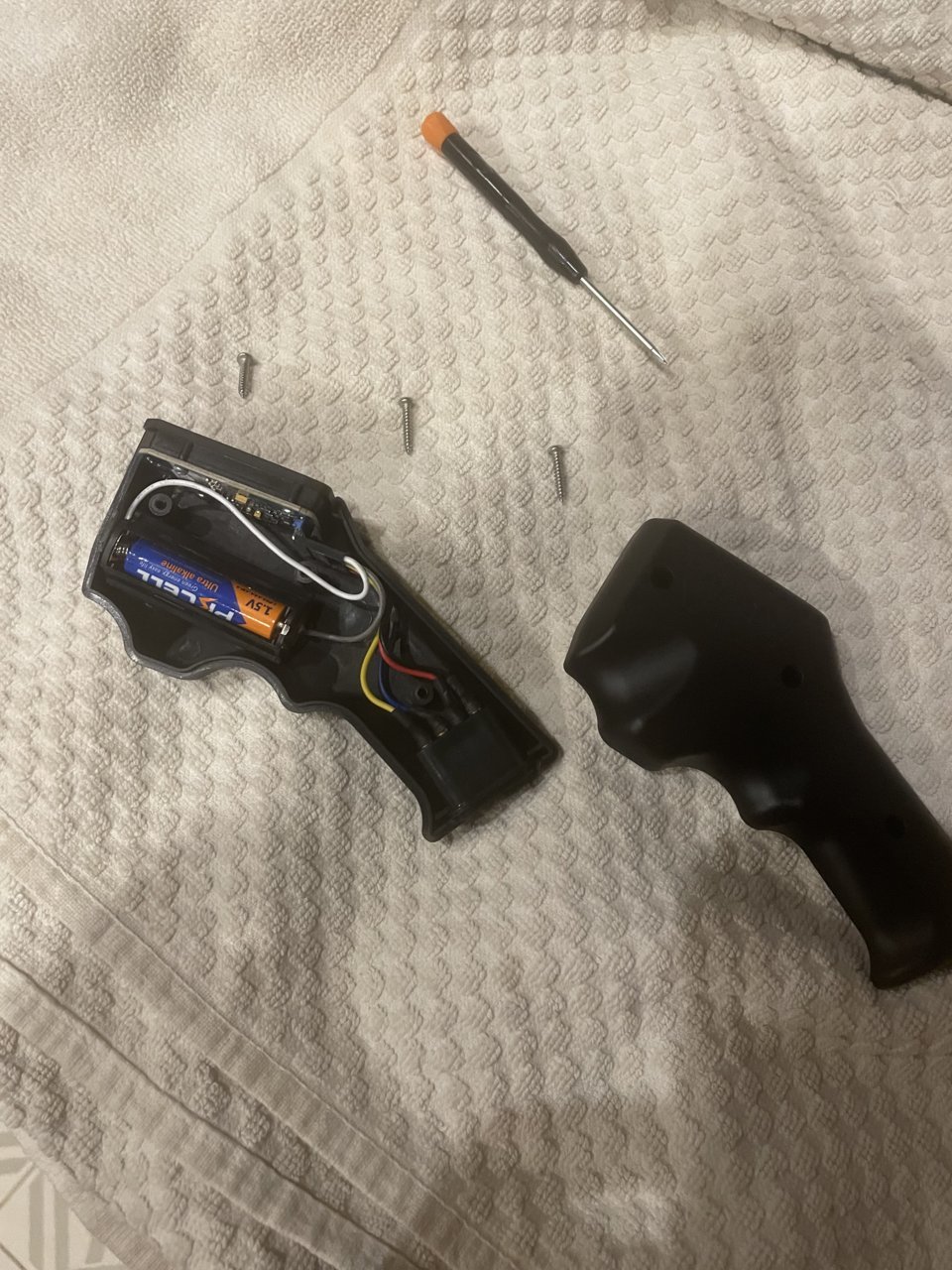

    I just got a new Warn Evo 10S winch installed in March 2022. It comes with the remote that can be used either corded or wirelessly. I can confirm it now uses 3 AAA alkaline batteries. See Photos.
    Removed the three screws holding the two halves of the remote together to separate the two halves to reveal the three AAA batteries.
    Close-up of one of the three AAA batteries
    Plug located in the bottom of the remote if you want to use the cord instead of wireless.
    TacoEspecial and sbl23 like this.
