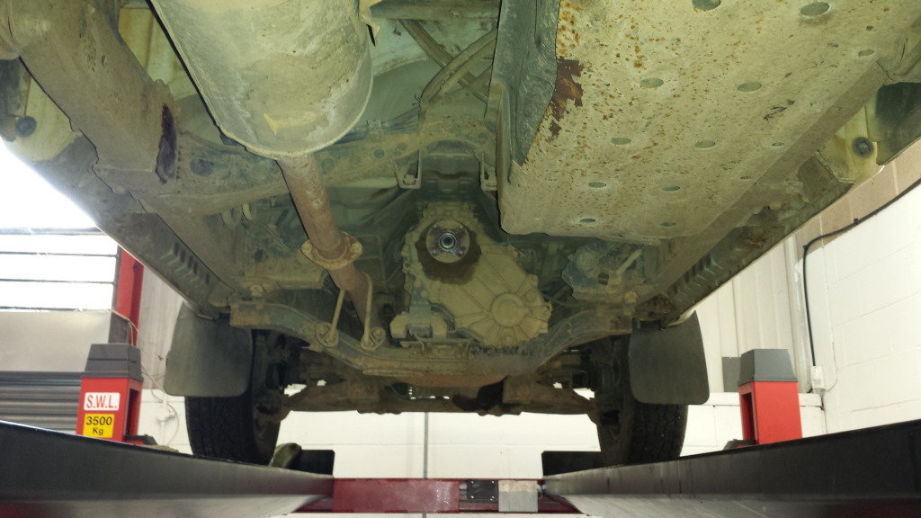

    I know this is an old thread but I stumbled into here researching for my 1KD swap. Which if anyone knows a customs broker that is familiar with importing halfcuts shoot me a PM please.
    This is a 2003 Hilux in the UK:
    Look closely and you will see the old torsion bar setup, right side diff drop and gas tank is on the right side. this is the frame North America saw from 86-95 in the Trucks and 4Runners. And this truck has the 2KD-FTV D4D engine in it. That engine and the 1KD engine share the same block as the 1KZ which was found in the earlier hilux/4Runner/pickup.
    Full build thread here:
    http://www.yotatech.com/f200/sienas-toyota-hilux-gen-6-make-over-3uz-fe-vvti-swap-280742/
