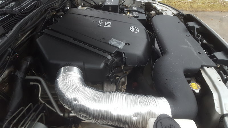

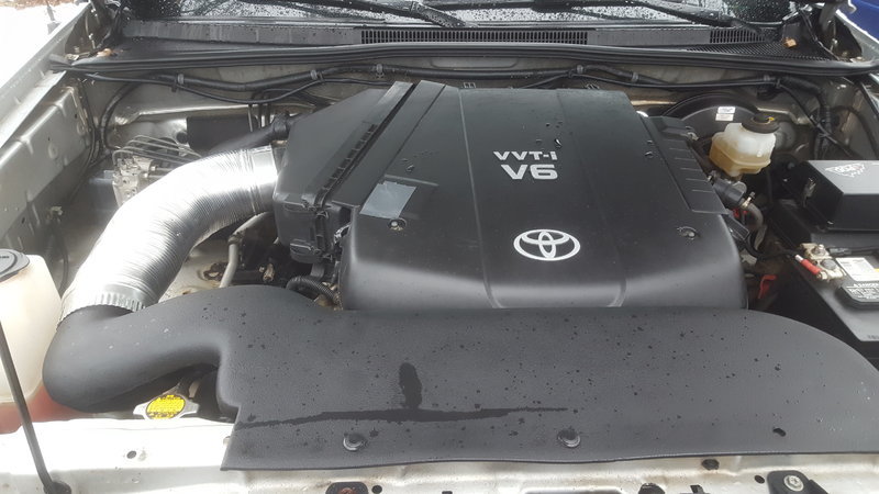

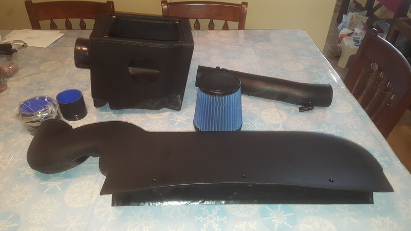

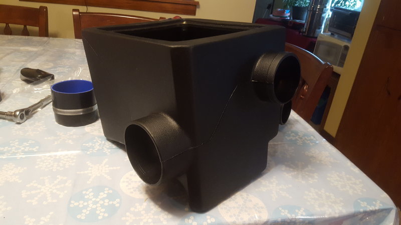

    I decided to go with the Volant intake because of the long intake tube should be better for producing torque, the ram air scoop and was the intake most people said improved MPG.
    The AEM looks higher quality but also may be tuned more for top end power and I think the Volant is tuned more for mid range and I want maximum mid range power.
    The ram air scoop is huge.
    So decided to do a test to see if the ram air scoop works better than the factory cold air intake. I installed the scoop and used 4" aluminum dryer duct to connect it to the factory air box.
    And............................................
    It works...... Just installing it felt about like the same power until I adjusted my fuel map.
    I was .3 lean after installing the scoop.
    After remapping it ran better, had more power and better part throttle power........
    I really like this set up and the truck is running the best it ever has.
    Plus the factory intake sucks up too much dirt, rocks,water and sand into the intake and I was getting sick of it.

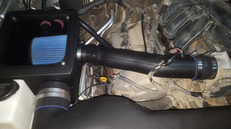

    Now time to install the rest of the intake.
    I believe the longer intake tube will produce more torque and smoother intake tract will produce more top end power.

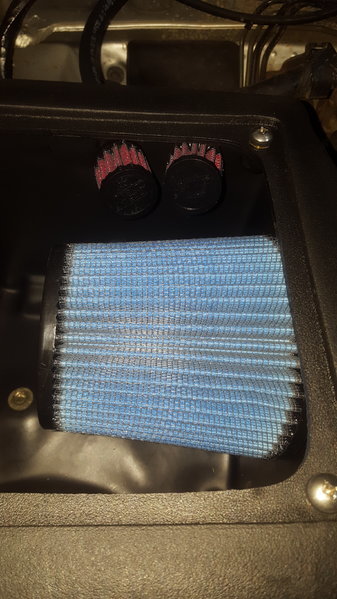

    I also decided to try a new set up for my PCV bypass.
    I don't run direct vacuum to the PCV it's like having a vacuum leak and sucks oil into the intake.
    So I ran the breathers in side the air box so it will still get indirect vacuum but not suck oil and have protection from dirt and mud.
    I also taped shut the fender intake and I'm only taking air in through the ram air scoop.

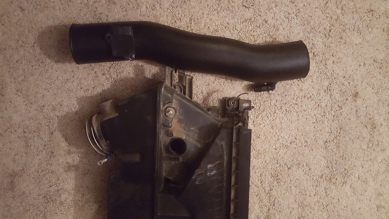

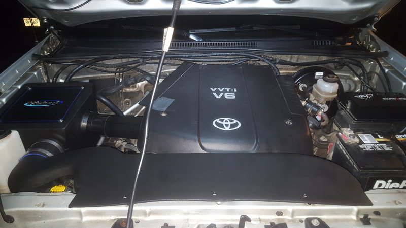

    So intake is installed. The intake is good quality but not great. Some of the holes don't quite line up but I fixed them with a dremel tool.
    I fire it up and it's running good but has a shutter. I ck the dash command and it's running crazy rich at idle. After a few tweaks I'm back to 0 trim.
    After a quick drive it's running good:
    1. feels like it runs much smoother
    2. power feels smoother
    3. fuel map now feels too lean and needs work
    4. low end power does feel better
    5. part throttle feels better
    6. mid range feels much better
    7. revs much better
    So to get it running I had to lean the map out and may have went too far.
    It changes the map and can't use the same settings as the stock intake. So I have to redo the whole map.
    But so far it seams like it has more power from idle all the way through the power range.
    Something I hadn't planned on is that the engine runs smoother and smoother power through the rev range.
    So far seams really good but I have to finish my map to able to say if it has more power or not.
    The part throttle power seams better and I may be able to create a better MPG map.

    NOW THE BAD after a week of driving
    1. They relocate the MAF sensor and it throws off the computer.
    2. The fuel trim readings are wacky
    3. and it is throwing codes for being out of range/O2 sensors just went bad at the same time no more codes, but it's at the limit.
    4. now the computer is over compensating reducing power.

    Now I have sent my ECU to orange virus tuning to be reflashed...
    The Volant intake is smaller diameter than the stock intake that is why it was running so rich at low rpm.
    Hopefully OVT can adjust for the new intake and fix the factory tune.
