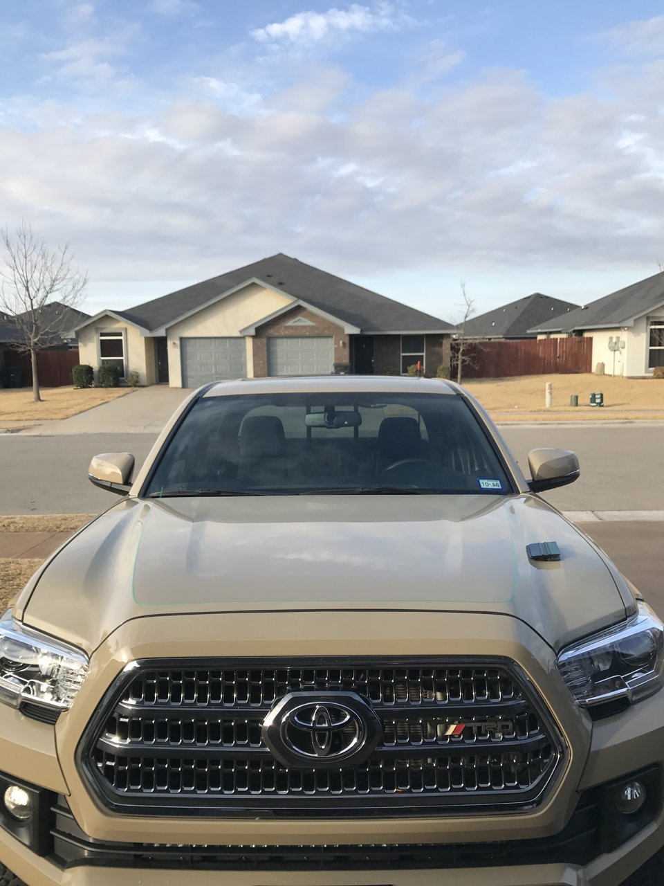

    Before:

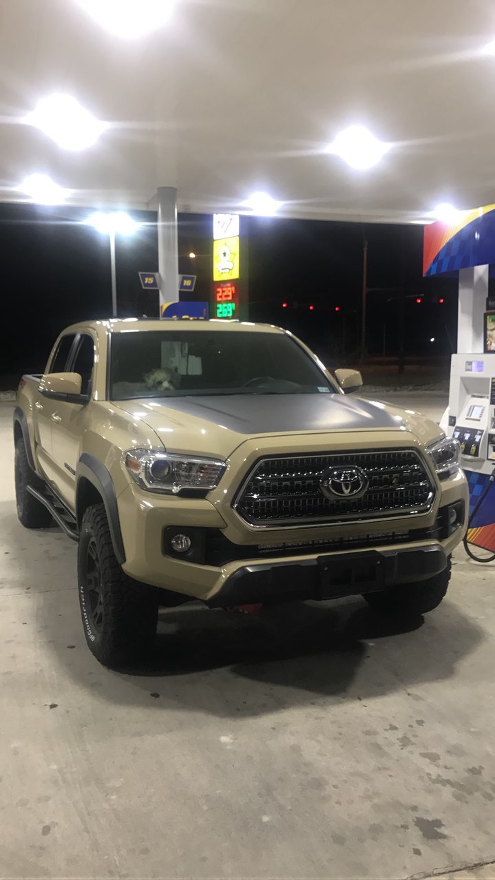

    After (my pupper Obi-Wan sayin' "Howdy!") :

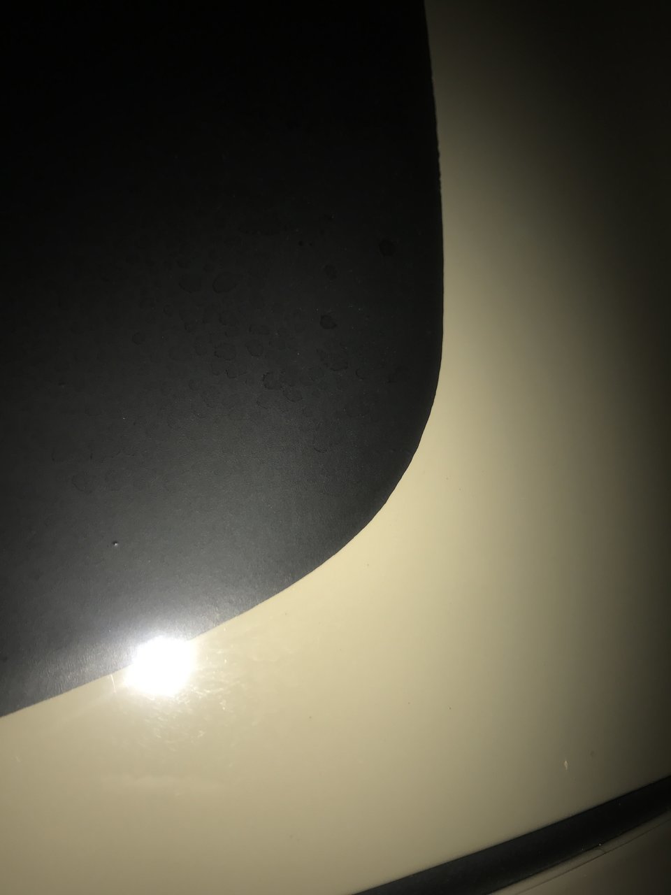

    Close up:
    Overall it wasn't too bad. You can tell I'm a noob at this because there are a few small creases and the edges of the vinyl got slightly bunched. At least it got rid of some glare and looks pretty sweet! I just followed the hood's ridges with the knifeless tape and that made it easy.

    You did remember to pull the knifeless tape liner off from underneath the vinyl after you pulled the chord right? Because it looks like the edge is bubbling since I can still see a line just inside the edge (it shouldn't have created that line unless the liner was still under there).

    Yes. It is not under there. I pulled it and smoothed it out with a heat gun. They're barely noticable but still there.
    Saw a video on this and apparently I applied the tape wrong. You have to put pressure on the outside only of the tape when laying in order for the tape not to bunch and pull incorrectly like I did. Lesson learned.

    Knifless tape is a bit tricky sometimes. You have to go slow and almost have to hold your finger on top where its cutting sometimes when going around curves.
    It should be salvageable. You'd have to use a knife on it and cut back about a 1/4in (or more and add an accent stripe outside of that would look good).
    I use a new black ultra sharp olfa blade
    https://www.amazon.com/dp/B00176HQ6W/ref=cm_sw_r_cp_apa_Ha7DAbHABN669
    or a scalpel (just use very light pressure let the blade cut just the surface of the vinyl and it should "tear" along the cut) and maybe some fine line tape to use as a guide.

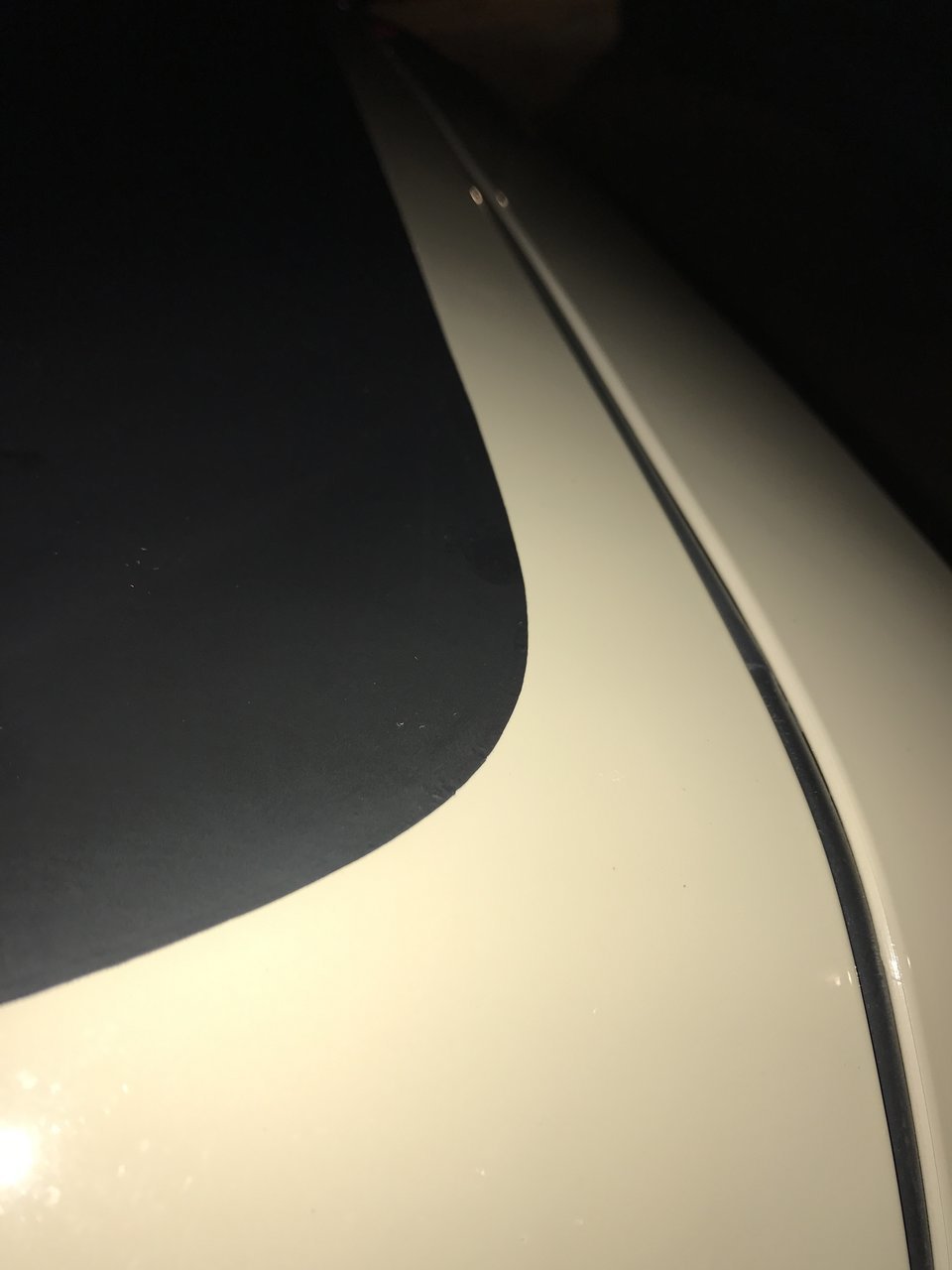

    I tested myself doing that in a small section and cut my paint... I was barely touching the stuff too! I guess this just isn't my thing.
    Below is a pic I just took of it. Maybe that last one I took before I smoothed it, but it looks a lot better now. Ignore that nasty bubble above it.. lol. It should bleed through the vinyl when it's a little hotter.
