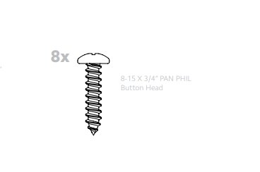

    Wanted to post here and see if anyone else already has the door molle panels from Victory, their install kit seems to just include a few screws and spacers and I wanted to ask how well if anyone has it have the screws held up just being drilled into the door panel itself without any sort of backing.

    Check the clearance between the seat and door panel with your door closed. These things are next to useless. If you have something skinny enough to fit, you aren’t accessing it with the door closed without the arms of a contortionist.
    I don’t trust self taping screws in plastic for anything I want to last.

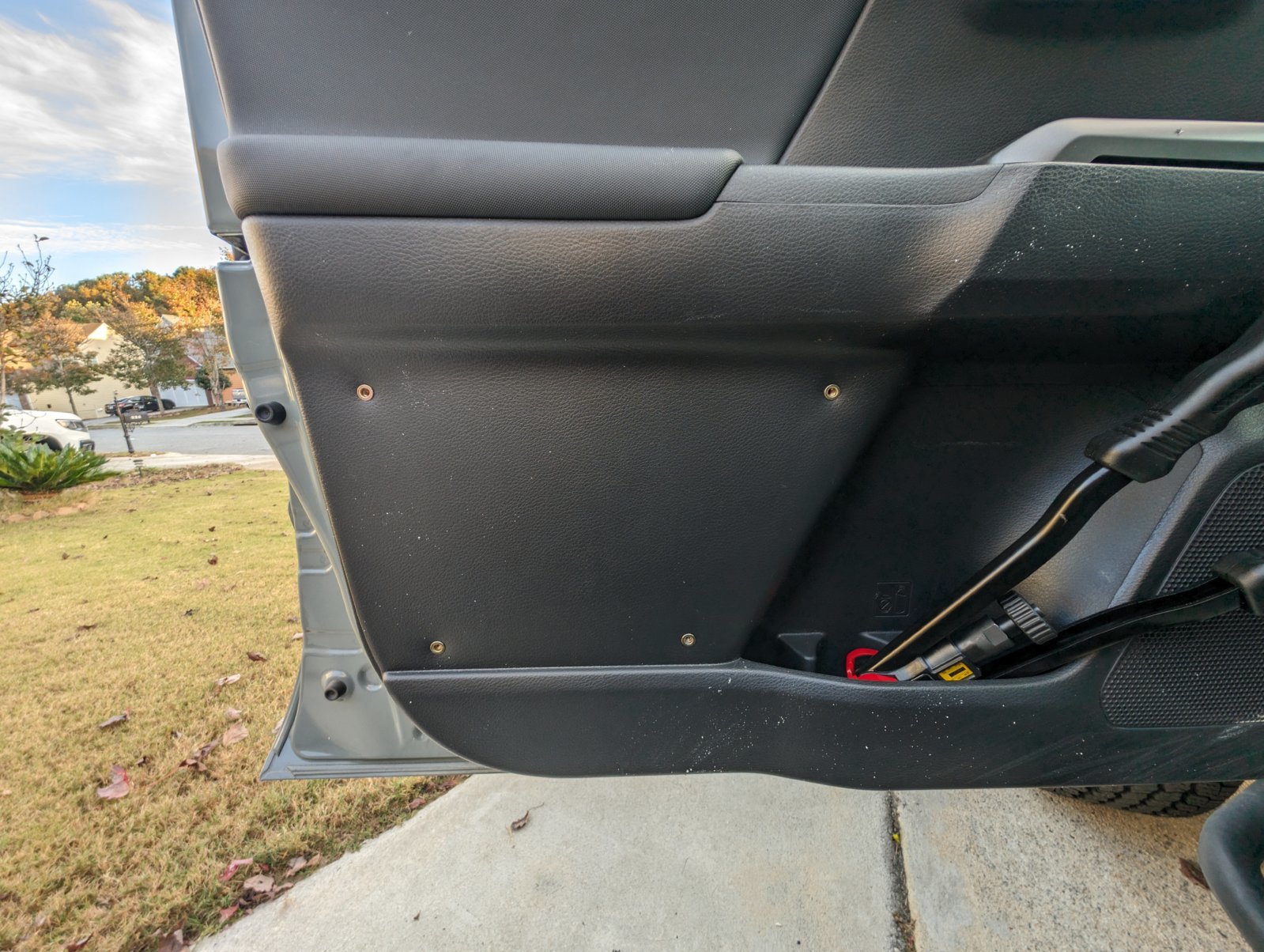

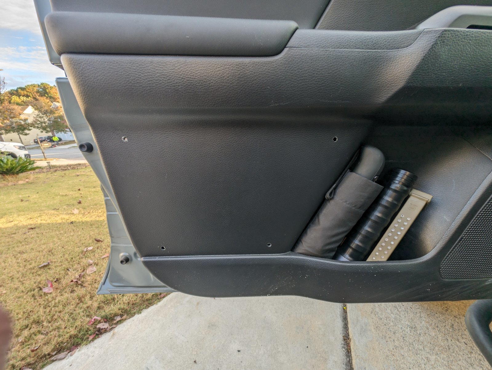

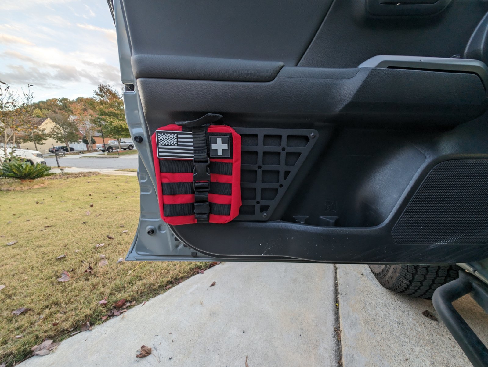

    Got the panels in today and I ended up going with the route of getting some threaded rivet insert and it worked out super well. I used size m5 inserts and screws to mount them.
    Drilled out holes in the door panel, used the rivet tool to rivet the insert, screws into holes, spacers in the back and bam it was done.
    Overall having them will be pretty useful for organizing.

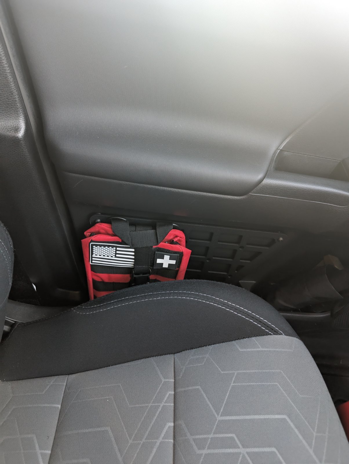

    Have pictures of the bag with the door closed?

    Yeah, still a good gap from the door to seat.
