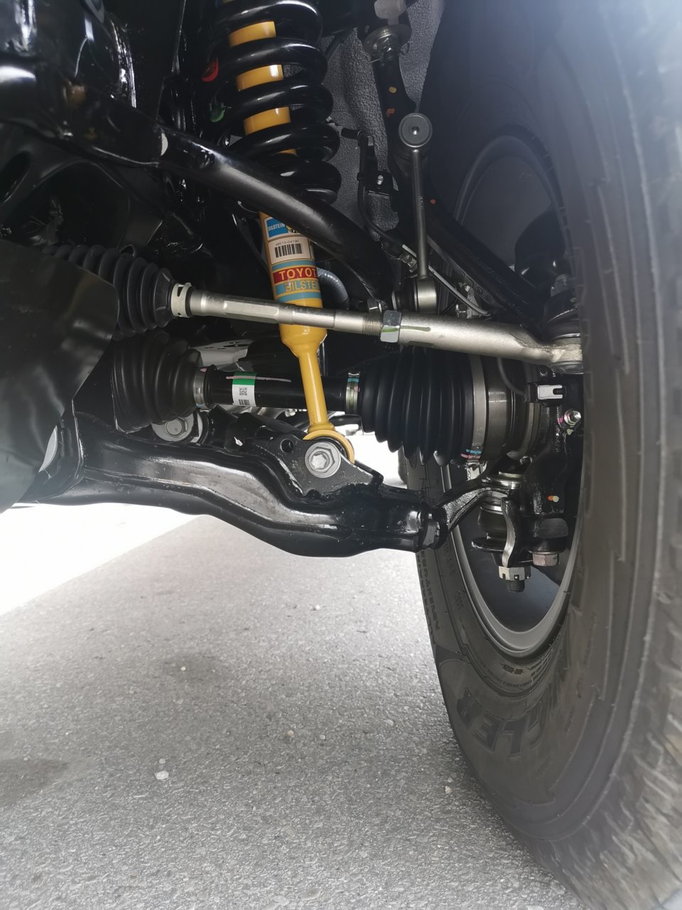

    I have a new 2020 TRD OR 4x4 Double cab.
    Recently put a 2/1.5 level on it. Ive been watching out for vibrations like people describe but I've had none of the usual (rear end, steering wheel, etc)
    My gas pedal vibrates though, I can't remember if it always has before the level because I wasn't paying attention to it.
    My gf drives with me a lot and she says it feels the same to her in the passenger seat and has also driven it and said it feels similar to her car (Mazda cx5, can feel a vibration but didn't think it was out of the norm)
    Maybe I'm being hyper sensitive to it because I'm watching for vibes.
    Is gas pedal only vibrations typical of any of the driveline issues after a lift?
    My CV angles haven't changed a lot. It looks like the fins are touching but I can slide my license in between that area at 6 o clock.

    I've read on here that a lot of people have said some 3rd gens have a vibrating gas pedal.
    I didn't do a diff drop or carrier bearing spacer. I do have the diff drop kit and can order the carrier bearing spacer easy enough.
    I was told the driveline vibration was more like a knobby tire sound/feel or like light rumble strips.
    This vibration is VERY subtle

    What speed?
    Put it in 4WD and see if the vibe is still there, then report back.

    Pretty consistent across all speeds, and also during 4H
