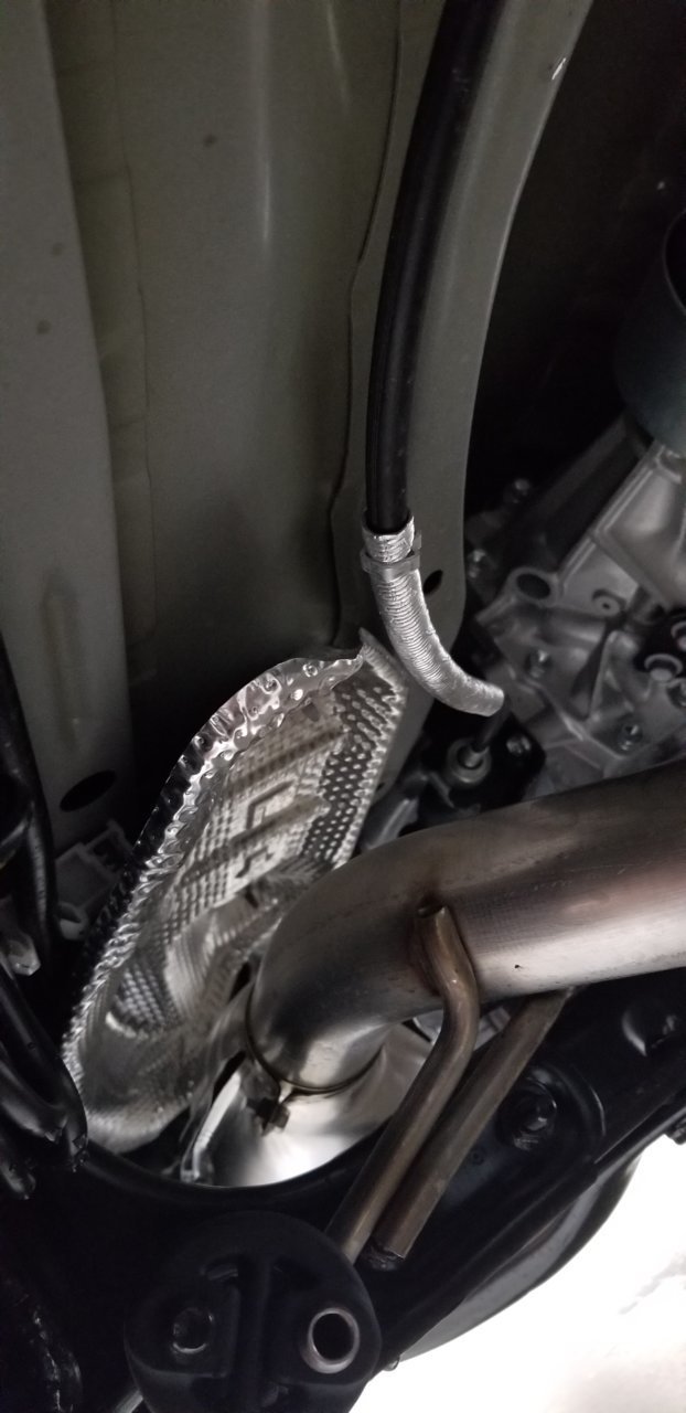

  16. Jul 24, 2018 at 8:46 AM
    #16
    PB FAB
    PB FAB Well-Known Member
    Apr 11, 2017
    #215942
    805
    2017 SR DCSB 4x4 v6
    Looks like the transmission shifter cable? After only 15,000 miles mine had already worn though the heat shielding and started rubbing off the jacket on the cable. Pull it away from t-case and tranny, used heavy duty zip ties.
  17. Jul 24, 2018 at 9:40 AM
    #17
    18' TACO TRD
    18' TACO TRD [OP] Well-Known Member
    Jul 20, 2018
    #259943
    281
    Florida
    2018 TRD Cement
    I believe so. I ordered some cable tie mounts (for cable underneath) and 1/4" anti-vibration rubber foam pads (for gas pedal). I'll post the results.

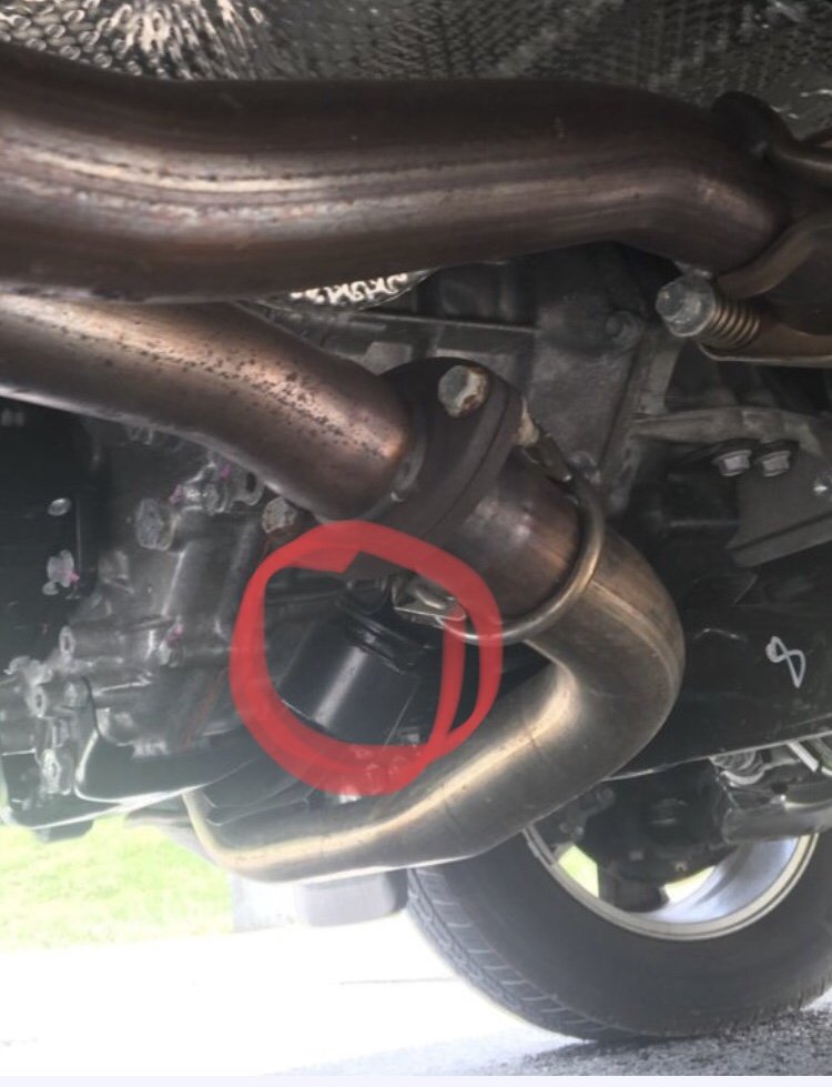

    I located T-SB-0013-18 but it appears to only address this issue with the TRD Off-road and TRD PRO maybe the T-SB will be revised to encompass the Sport, SR & SR5, they actually install rubber dampeners between the cab and frame and claim that the vibration is resonating from differential

  20. Mar 11, 2019 at 5:53 PM
    #20
    phoenixpiole
    phoenixpiole Well-Known Member
    Aug 13, 2018
    #262691
    128
    2018 Tacoma DCSB SR5
    Thank you for the photo, how does this attach exactly? Does it just wrap around the exhaust pipe and the rubber boot just sits against the transmission housing?
