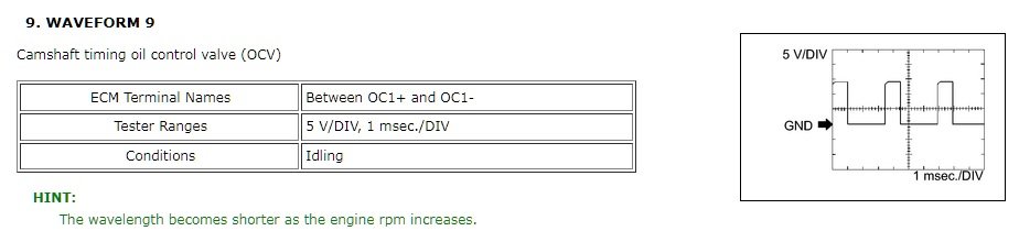

    does the variable vale timing oil control valve get it's signal from the ECM? I did a bidirectional contol test on it and there was no change in voltage

    Yes it does but it's not a constant voltage it's a PWM signal that increases or decreases the duty cycle to regulate the oil control valve position.
    Measuring voltage on it with a meter isn't gona tell you much.
    Are you getting any codes?

    yes I got a p0012, does this mean I would need a oscilloscope to see a signal from a bidirectional control. Im getting 0.5 volts at idle

    If your not getting a P0010 code then most likely the circuit and PCM are fine, P0012 (Bank 1 Cam Timing Over-Retarded) can be caused by:
    Low oil level or dirty oil
    Faulty oil control valve
    Clogged oil control valve screen
    Stretched or jumped timing chain
    Faulty VVT actuator (cam phaser)
    If the oil level and condition is good the next most common cause of timing codes is the oil control valve.

    I bet the solenoid is stuck, if the circuit was open you would get P0010 (Bank 1 Cam Actuator Circuit).

    I ran 12 volits to the oil control valve seems to have full range of movement

    Does the engine stumble or run rough when you do the bidirectional test?
    You can also put a standard test light across the solenoid terminals and start the engine, if the circuit is good the light should light up dimly at idle and get brighter if you turn the circuit on with a scanner.

    no it does not change at all with the bidirectional control like it should

    What if you momentarily jump power directly to the solenoid with the engine running? It should stumble or stall if the solenoid is controlling timing.

    Shouldn't unless physical cam timing is off multiple teeth, the PCM is essentially doing the same thing when you command the oil control valve on with the scanner.

    Update: Was able to jump power to oil control valve ran ruff, plugged it in then I was able to bidirectional control it, at least I know the PCM signal is getting there. if it throws a code again I will replace the valve Thanks for the help PS Bad Connection I think I had covered all connections with dielectric grease to keep them away from corrosion
