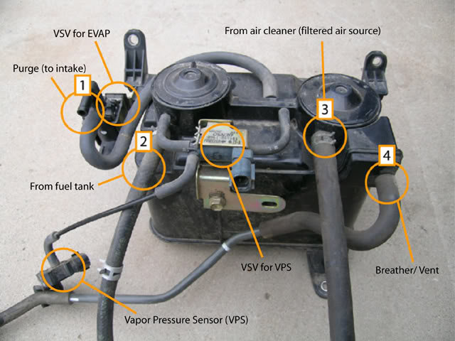

    This may help you with what the VPS looks like

    The VPS is just one part of EVAP system and I personally have yet to see one fail. Large leaks are usually the fuel pump door on top of gas tank or filler neck hoses. EVAP leaks are best found by smoke testing through the green Schrader valve by cannister.
    Doing this first may save time and money replacing parts without testing them first. If you live in a salt state you may need a new gas tank.
