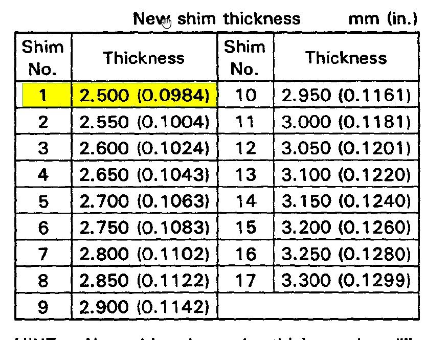

    Its your exhaust valves(smaller clearance) that are gonna wear down overtime....
    when they wear down (seat).... there is less and less clearance.....
    that gap determines how long valve is left open....
    if open too long....valve get damaged (burnt)....
    So your always gonna need smaller and smaller shims......
    The exhaust ones are already pretty small.....so there is only one or two steps left....
    most of the 4 bangers (2rz/3rz) heads come with #3 in exhaust from factory from my limited experiences...
    I have aftermarket heads.....so........any bodies guess........................
    Careful ......reman engines with reman heads may already be on smallest shim....which you'd run to failure.....
