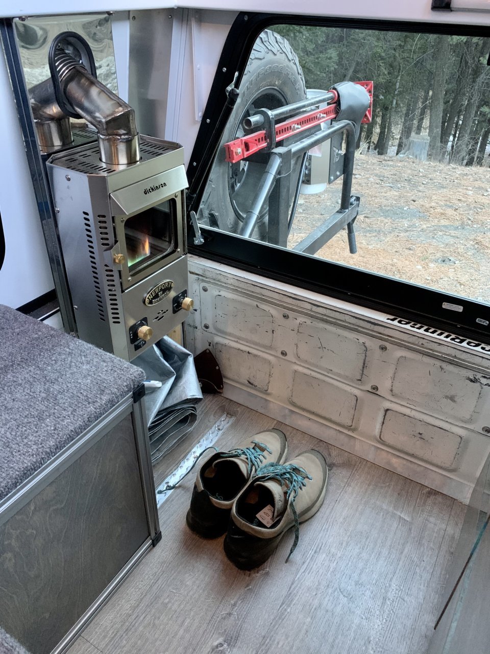

    I tested my propane fireplace and stove out at higher altitude to get some data. I also got the fan wired up on the fireplace, so was able to run that, too. Here's what I came up with:
    Appliances:
    Dickinson Newport P9000 propane "fireplace" heater (the smaller of two models they offer)
    Dometic built-in HOB stove model HB-1320 (European spec, I believe. Purchased second-hand from eBay)
    Newport P9000 specs per Dickinson: 3200 BTUs (low) 4500 BTUs (high); Runtime per lb. of propane, 7 hours (low) 5 hours (high)
    Dometic HB-1320 specs per mfg: 7506 BTUs
    Test location: Santa Catalina mountains, Tucson, AZ. Elevation 8,400 ft.
    Weather conditions: Dry, overcast, 30F upon arrival (7:30 pm) overnight low 20F.
    I ran the fireplace heater on HIGH setting for approximately 13 hours. I'm guessing run time for the stove on intermittent and mixed but mostly high, or near high setting for 15 minutes overall time during my stay.
    Propane consumed: 2.8 lbs (0.357 gal.) This is pretty much right in line with the manufacturer's listed rate.
    As far as heating performance, I could tell the output wasn't as much as it was when we were using at 3,000 ft. last weekend. Especially considering that last weekend I didn't have the fan hooked up and it was strictly radiant heat. This time, even with the fan on high the temp inside the drifter stayed in the mid-50s while outside it was 20F-30F. But the fireplace fired up with no issues, and ran consistently with no issues, so the elevation + propane was no problem at all. It's just the de-rate of performance with less oxygen to burn, so a little less BTU output. The Dometic single-burner stove worked great, too. No issues. It's worth noting these results are with a 6-ft bed model, insulation package from Vagabond, no insulation on the two side doors, no insulation on the front and back glass. I do have 1" rigid insulation on the floor and wrapping around the bedsides and front wall of the bed. No insulation on the tailgate. And of course, no insulation on the tent walls. Overall, I'm very happy with it. With additional insulation on all the bald spots and some insulation panels for the tent, I think this would be snow-camp worthy for sure. Personally, I'm fine with it being 55 inside while 20F outside... I lounged in my chair with a light down bag draped over my legs, feet by the fireplace. I slept well.
    In this last pic, you can see it's 59.9F in the Drifter and 26F outside.

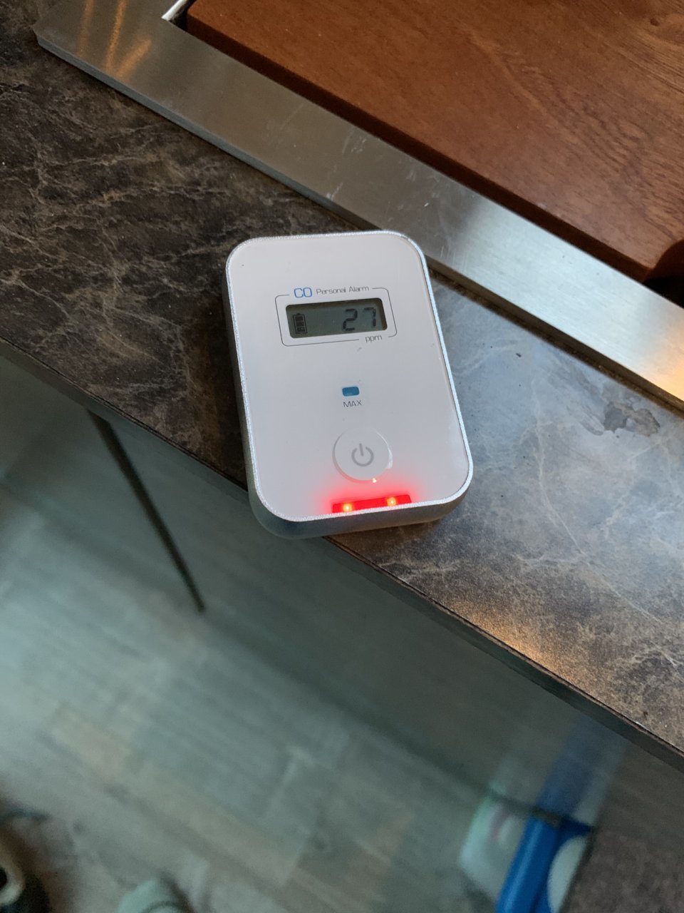

    In the morning while making coffee and breakfast, I did learn the CO detector works. The stove set it off as I didn't have enough openings to ventilate the CO fast enough.
    This is the detector I'm using: https://www.amazon.com/gp/product/B07FYVBB92/ref=ppx_yo_dt_b_asin_title_o07_s00

    Great post on the Dickenson. Plus one for the Forensics CO detector. We have one and it works great for small spaces. It was designed for airplanes, so it measures low levels of CO and only sets off the audio alarm if the level gets too high. We set ours off this weekend (46 ppm) on our snow camping trip. Had a Mr Buddy going on low, two burners on the Cook Partner, and a small camping stove. We had the fan in low. After turning the fan on high and opening the back a few inches the level went back down to 0.
