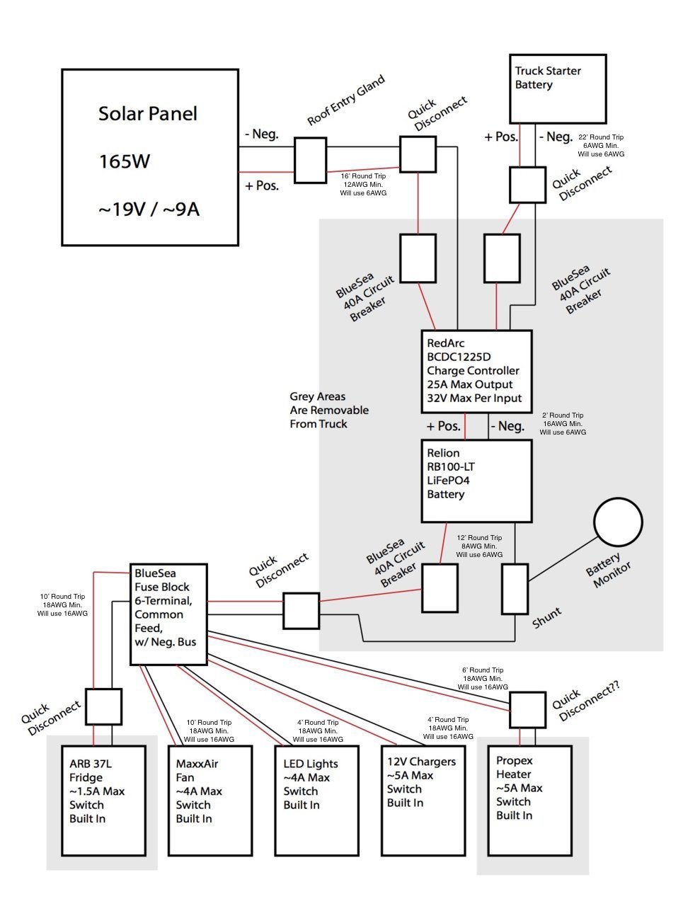

    I've pored through the forums and haven't been able to find a really specific answer. I'm an absolute solar/electrical noob, and need instructions like I'm a fifth grader. We've got our Drifter ordered with solar pre-wire and the power port/double USB added. I'm planning to add solar and a second battery, and am thinking on getting that started now with my current setup. I've obviously got the solar panel, second battery, and charge controller. I'm wondering, since I'm not 100% clear on what the Drifter comes setup with, do I also need a fuse panel and inverter? Or does the Drifter add-ons cover those things?

    I would give phil a call and talk to him about it. They're an outfitter so they can completely customize the build for you and make sensible choices for everything.
    What you install really depends on what kind of accessories you plan on running (fridge, lights, beat/slap, blender for margueritas, hair dryer, heater, etc)

    To break it down for you
    I go from a Renogy 160W panel to Rich Solar 20A controller. The Controller runs to my 100AH battery with an inline fuse to protect the battery.
    Blue Sea Fuse panel also runs to battery. I plug in any electrical stuff I want with a positive/negative to the Blue Sea fuse panel instead of to the battery.
    Give me a DM on Instagram and I’ll record a video showing how the wires come in/go out. @socalexpeditions - I’m not a wiring guru, but I’ll make it easy enough for anyone to understand

    The standard pre-wired solar wiring from VO essentially punches a hole in the roof and routes the wires down to the bed. You see some details of my solar install in my build thread.
    If you get the lighting package, you can have VO terminate the wires anywhere you like. You will then need to install your own fuse box, solar chargers, and battery, etc.
    DM me if you want to talk electrics. I love electrons. :)

    You'll have to add just about everything. Here's an early draft of my system (things changed slightly before completion):

    This is very similar to my proposed setup but I want to add shore 120v with the water proof NOCO plug adapter a few posts back. I want to feed a 120v outlet and a 12v battery charger. Where in that diagram would you put the charger? I already bought the C-Tek gateway smartpass 120S and the C-Tek D250SE based on my brother's recommendation. Guess that combo is pretty popular in the Sprinter Van build community, which my brother is part of.
