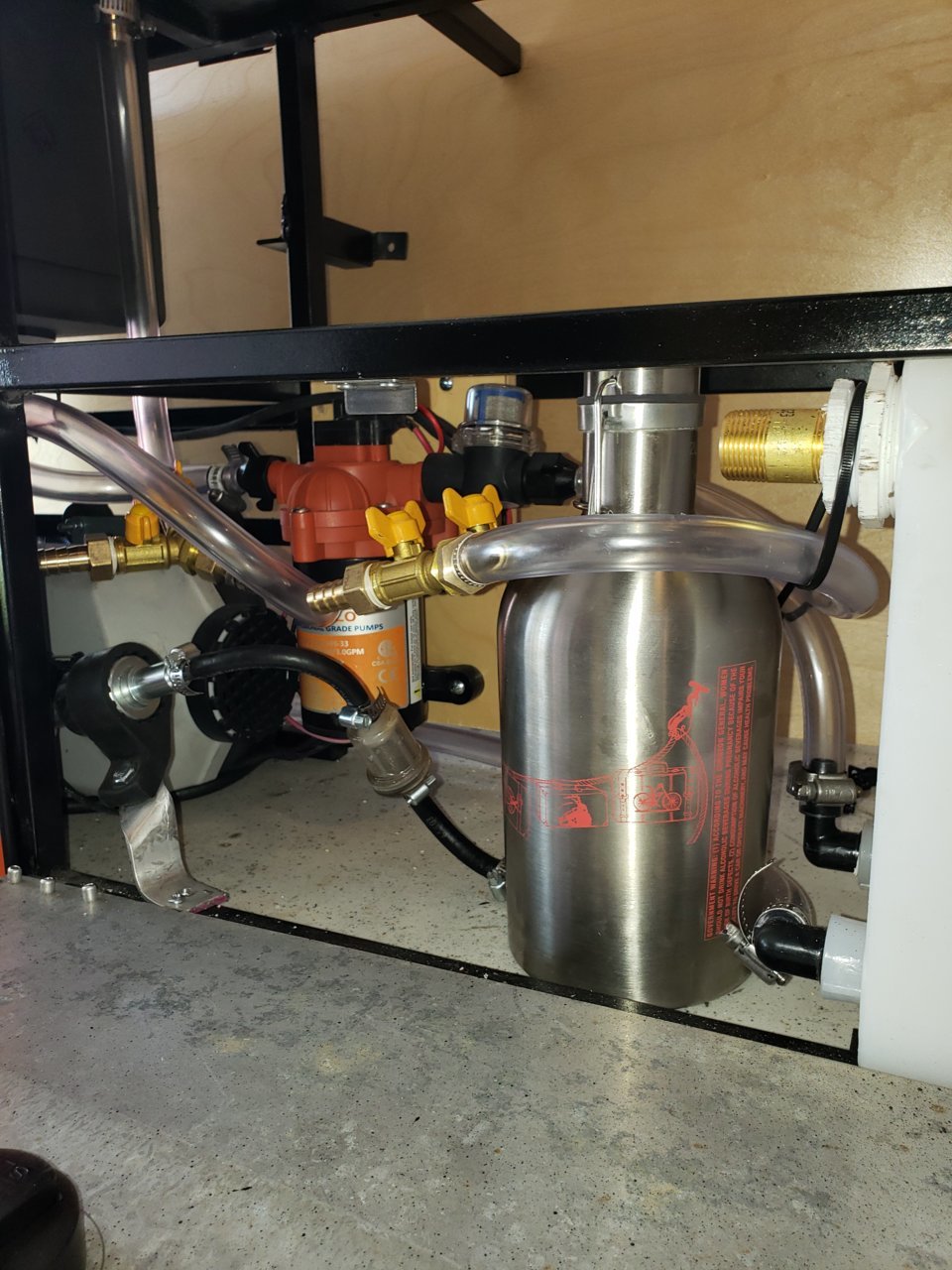

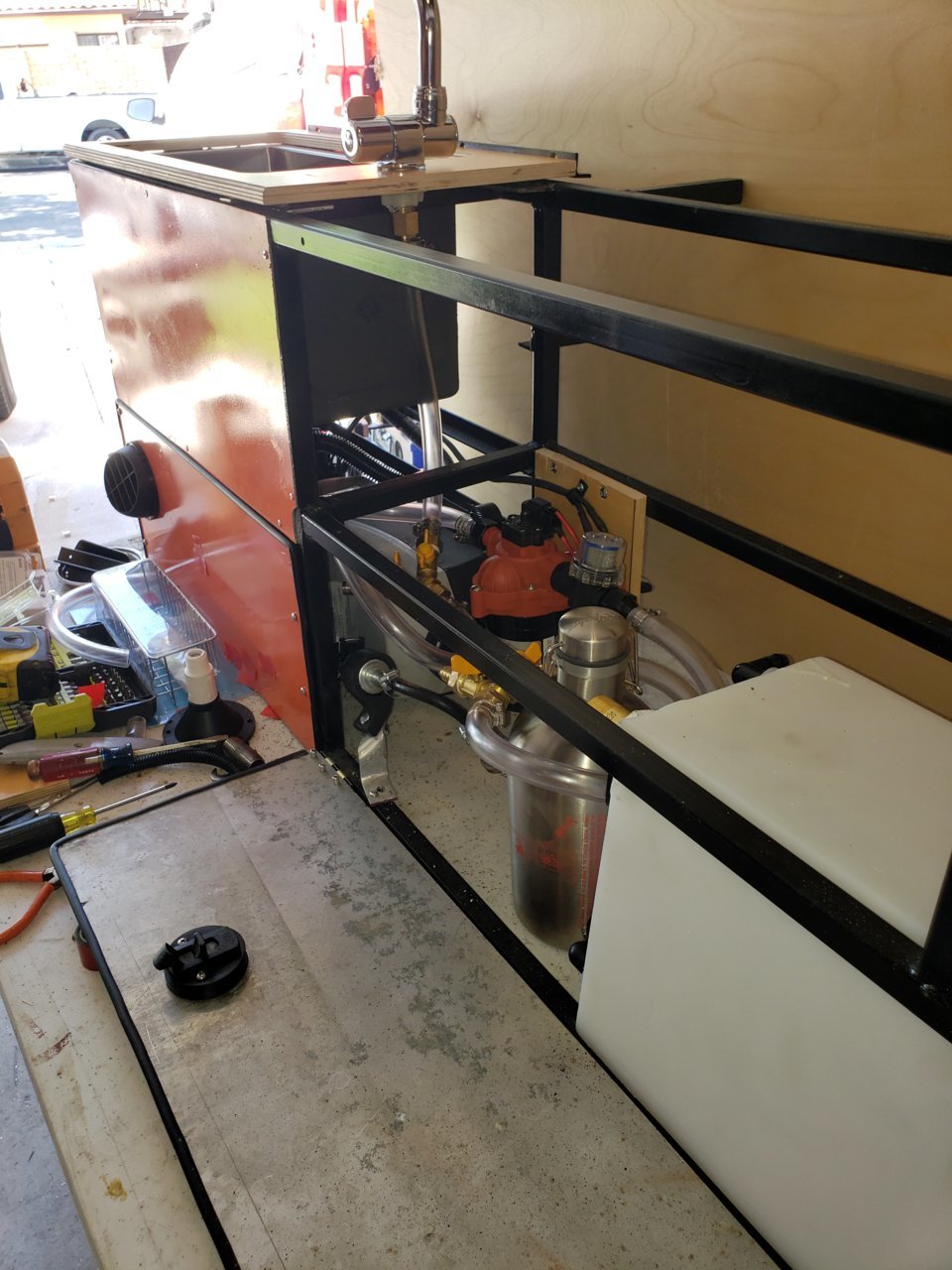

    Here's a look at the inner workings of the cabinet. It has an 8 gallon water tank that has a fill line, a vent line, a line to the water pump, and a drain line to empty the tank. The pump is a Shurflo, it can pump water from the tank or by switching a couple valves it can pump from a outside source like a water jug. From the pump out it feeds the sink and a outside water quick connect for a hose or shower nozzle. The diesel heater originally came with a fuel tank that was to big for this cabinet, so I'm using a aluminum beer growler. I installed everything into the truck today with a few more details to finish up, then I'll post up more pictures.

    @excav8tor what's your pressure relief plan for the beer growler?

    I found one on Amazon I'm going to try out, drill a hole and screw it in.

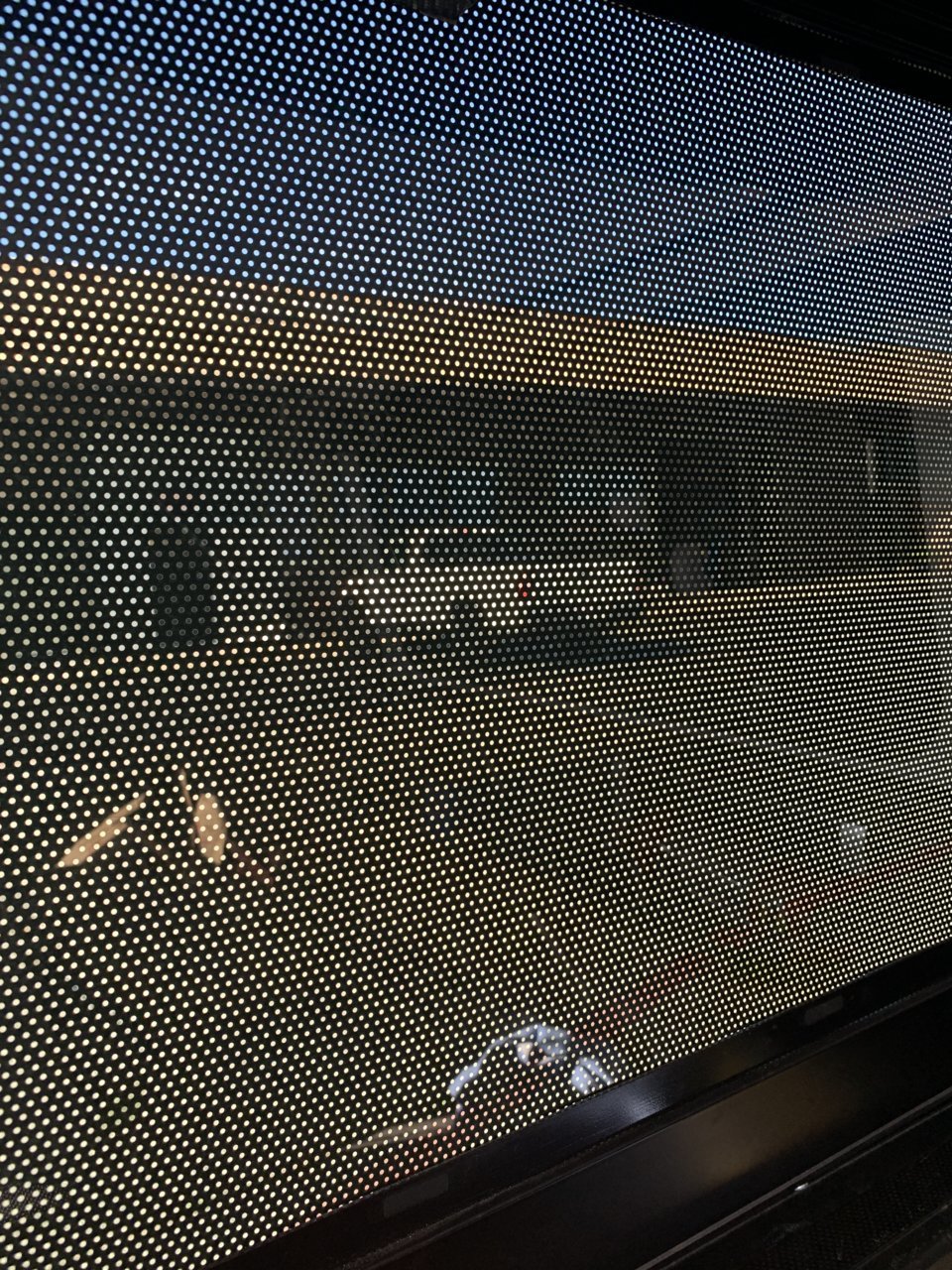

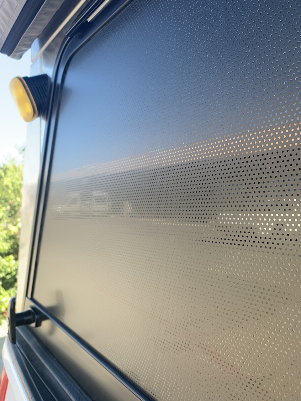

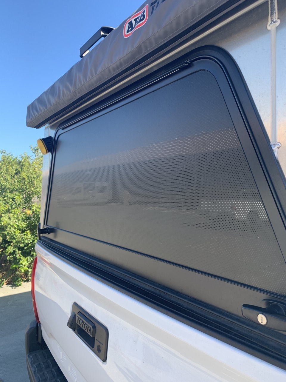

    Dang I wish I had this instead of the window. Tired of people trying to look at me when I’m changing (;

    you could try this; or just a straight up wrap......
