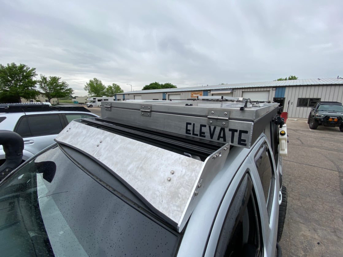

    Im considering cutting my Prinsu Habitat rack so that it ends right before the drifter. Right now it looks kind of wacky. Do you know if this company is planning to make a taller fairing?

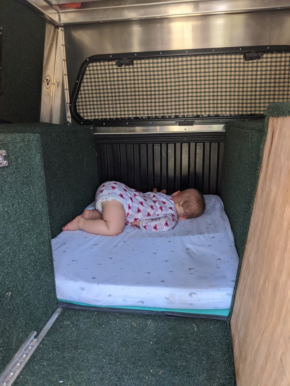

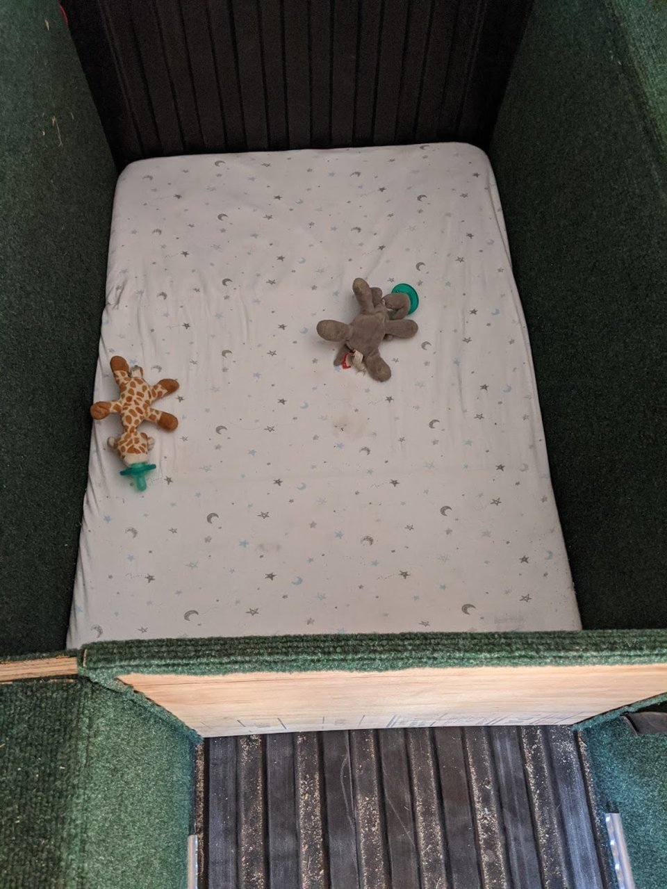

    Update on the Drifter crib for those interested. After our daughter found a way to climb around her former guard rail and fall, we had to re-build to avoid any future accidents. I built a space on the floor that was perfectly sized for a pack-n-play mattress. This gave her a little space that she could crawl and stand up without any fall risk. It worked out great on our 10 day trip and she mostly slept very well.
    QB7hQOhFhsh_UtMnv9kAtaUbalqE1nsW2sEc0AGZ_de95e0912595c3f23b7ecfd58f9ecbd4eff3f802.jpg
    czt0K0wVIet8ehMS4B9uYgVI-dct_AZwLJ3xm2aH_6c95276eb8c54dc0e007fad8308826555a3e6832.jpg
    I can already tell that this is only a temporary solution though as she would bump into the walls a bit rolling around in her sleep. We'll be re-building again soon to accommodate a bigger mattress for sure.

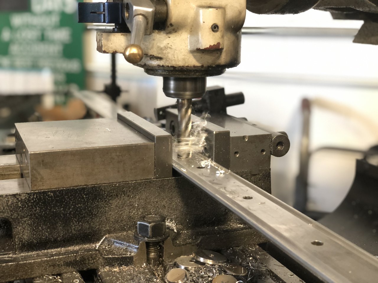

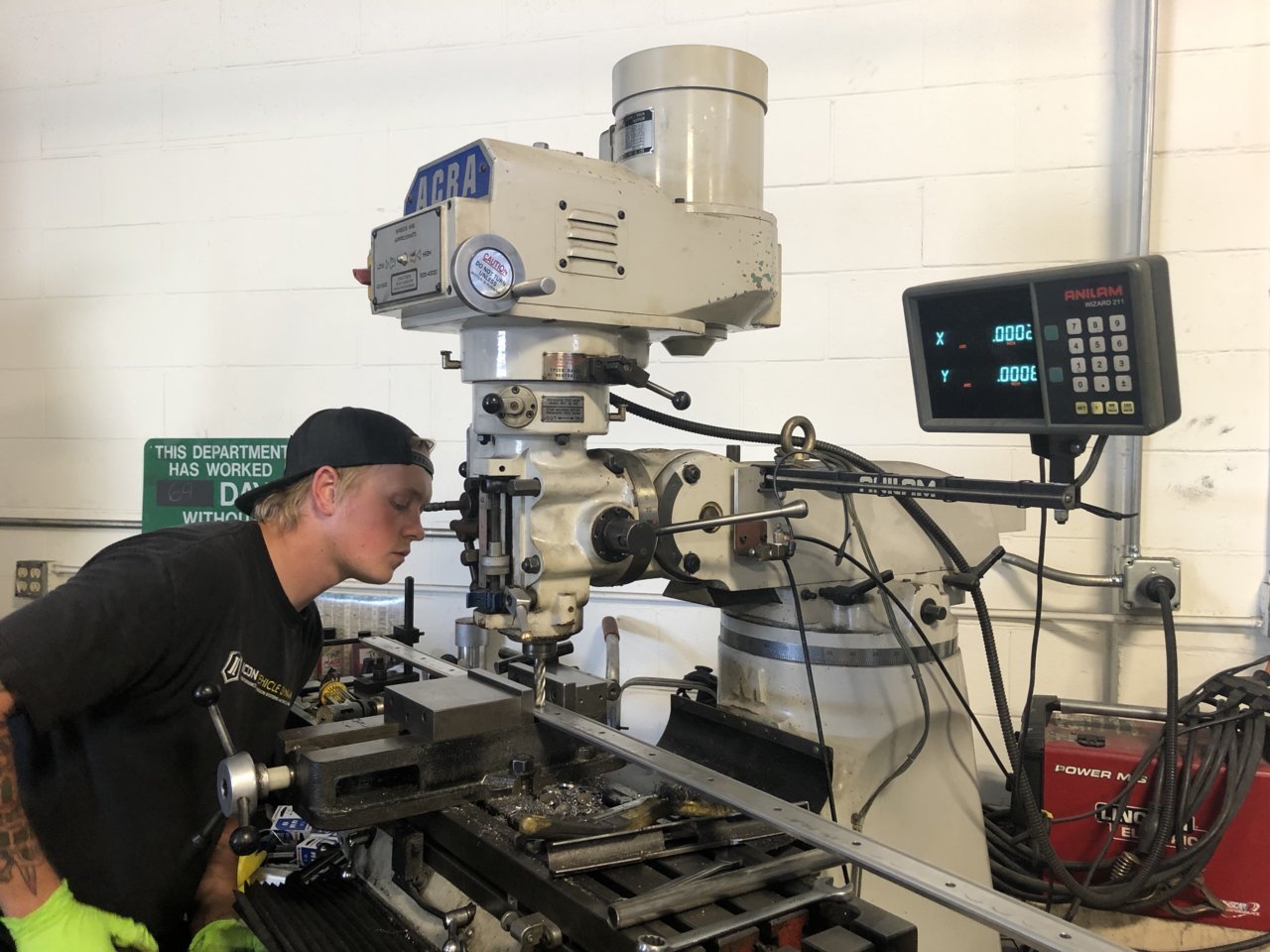

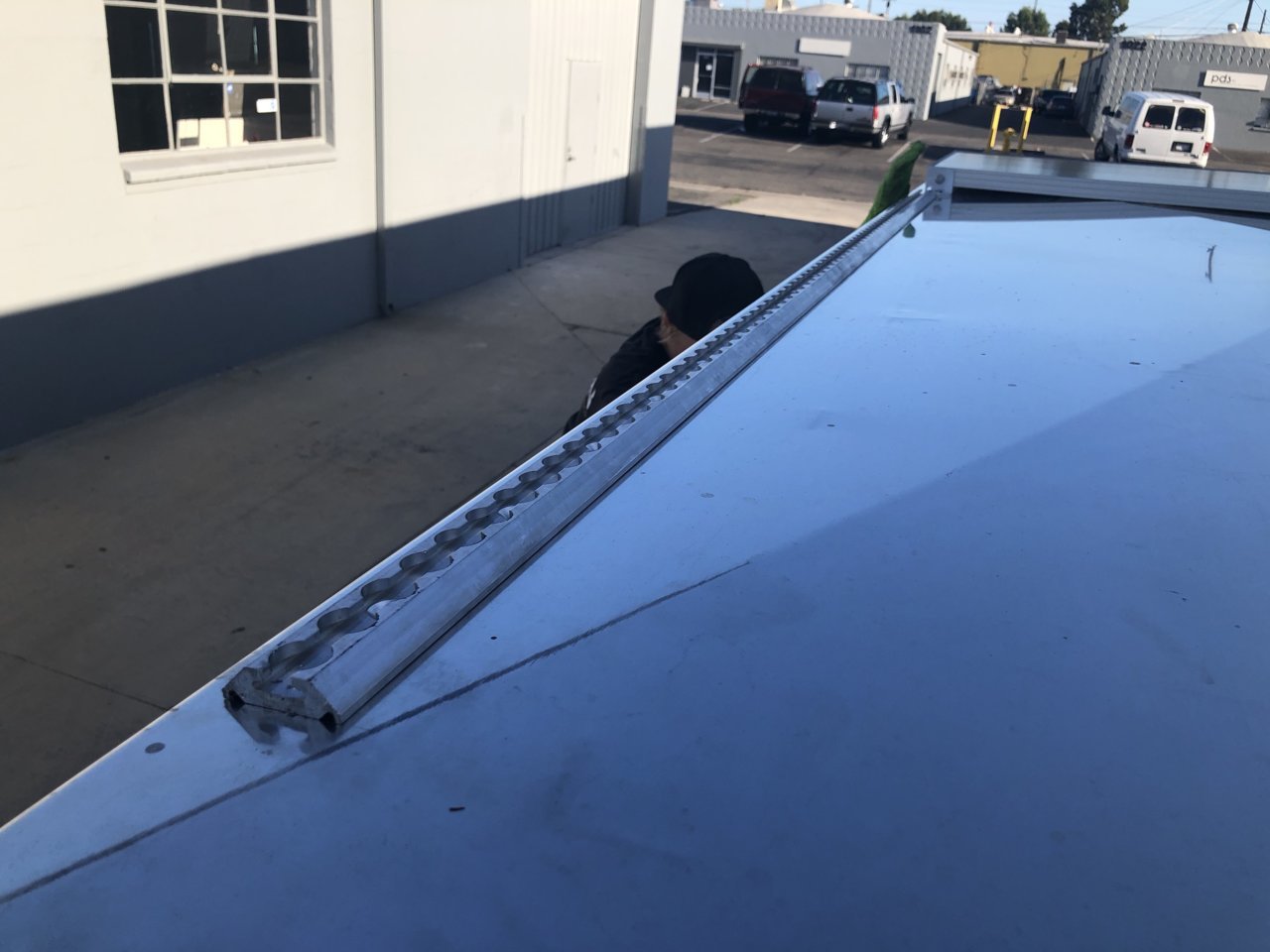

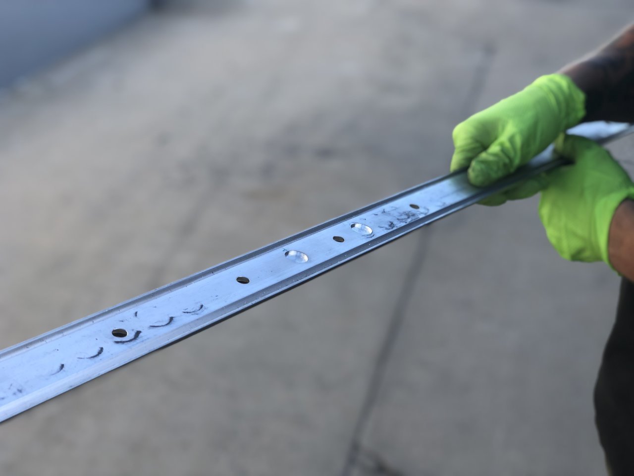

    Stopped by my buddies shop yesterday to cut some L-Track and mill the rivet areas out.
    I will say, it is much easier to take the measurements and have the L-track properly milled out to fit over the rivets so when it comes time to install, you don't have to measure 20 times to make sure the L-track is straight on each side. All I have to do is set the L-track on the roof and drill holes since the tolerances are hundredths of an inch.
    2x 75" pieces going up top. Next up is doing custom brackets and the crossbars!

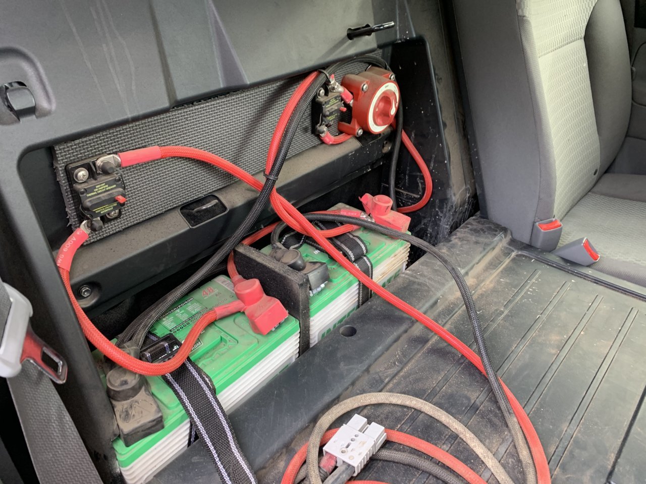

    Has anyone installed a house battery in the back of their rear seat on their DC? I never use this space and the plastic cubbies are pretty small since I never store anything in them. Since I have a short bed I want to minimize the placement of a battery inside the bed and keep it free.
    Thinking of stealing @Wackyhacky idea.
    Want to run a Redarc 25a DC/DC charger with Victron IBS. There is a 1.75" grommot there for passing wires, etc. I want to run a NorthStar Group 31 battery.

    This thread has a lot of dual battery knowledge. Linked a specific post on passenger side. He also has a post further down with info. A few have put batteries behind the rear seats. First post has links to setups.

    My 80ah house battery is behind the driver side rear seat. It powers a stereo amp, inverter, and compressor in the cab. I run power to a fuse box in the camper for lights, fan, and USB outlets.

    This is the setup i had. I’ve moved the ML-ACR there from the front main battery area and added solar as well. Hooking up a Victron charge controller to regulate a 220W panel on the roof of a Drifter

    What is the size of those batteries?
    Thanks for all the input guys. Definitely possible to put a battery there.

    Mine is a Group 31, 125ah, but it would never have fit w/out removing the storage cubby.

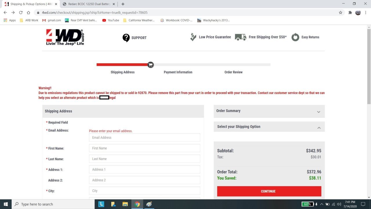

    Super weird. Tried to purchase a Redarc BCDC1225D DC Charger but it says,
    'Warning!!
    Due to emissions regulations this product cannot be shipped to or sold in 92870. Please remove this part from your cart in order to proceed with your transaction. Contact our customer service dept so that we can help you select an alternate product which is XXXX legal'
    I live in California. Is this correct?? I guess I will call them tomorrow and try to place an order.

    Why did you redact CARB?
