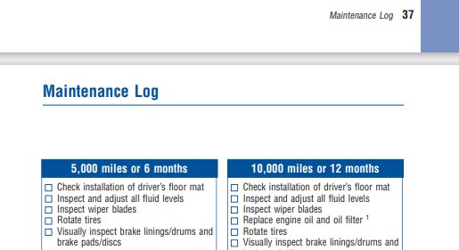

    Toyota actual makes it clear that its 5k miles or 6 months (for the pointless interval), which ever first, and 10k miles or 12 months (for the actual oil change, etc).
    12 months maximum is definitely the normal. Is it conservative?, I dont know but it is basically universal.
    Here is Tacoma's
    other examples.
