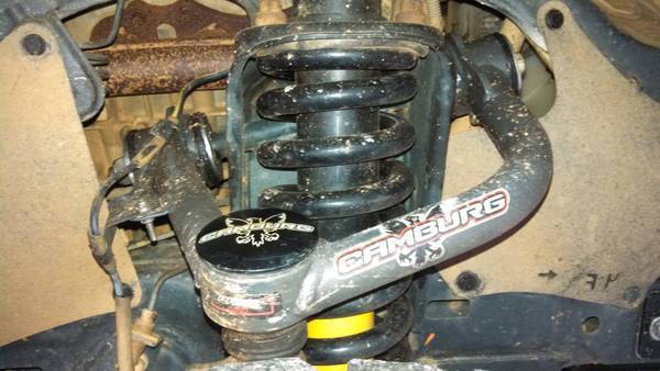

    Sure it does. Having seen the ball joint angles before I put the Cambugs in, they definitely fix that problem. Now the ball joint stud come out of the control arm almost perpendicular like they should. There is some angle built into the ball joint cup that you can't really see in the pic. I'm sure they aren't as tough as uniballs, but I don't jump the truck running 100mph at Baja. Mud/swamps are where I spend time. No uniballs for me. I shouldn't say that really since I never used them, but I just would not want to bathe an unprotected suspension part in mud routinely. Thanks man!
