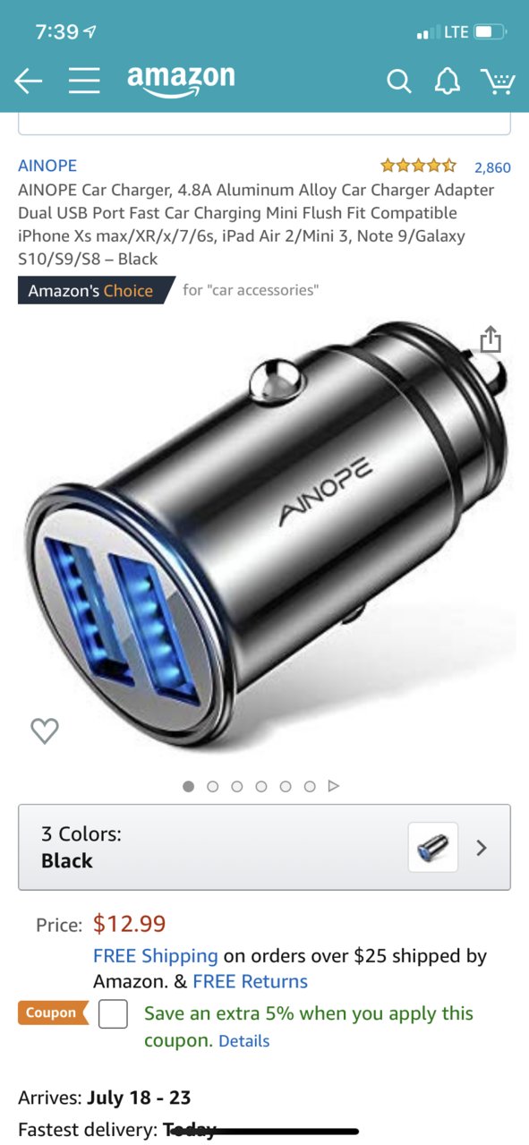

    i alway use anker pnp for charging in my truck but this time i try the new one, quick charge and low profile8DCB8FCE-1CB1-45B1-B5C8-AD7219D8334E.jpg

    That’s what I bought. Great quality. The in-dash USB is a data port, not a charging port.

    These work great, sit flush and two second mod with no cutting wires.
