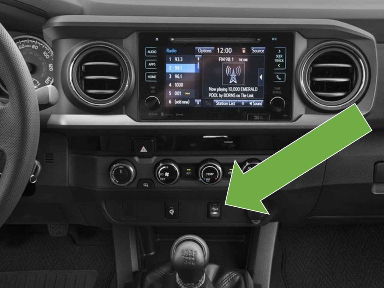

    ...where is the USB port??? (seriously)

    2018 Tacoma TRD Off Road
  8. Sep 7, 2018 at 8:53 AM

    Never looked at it. For real. Thought is another unimportant button :frusty::facepalm:
