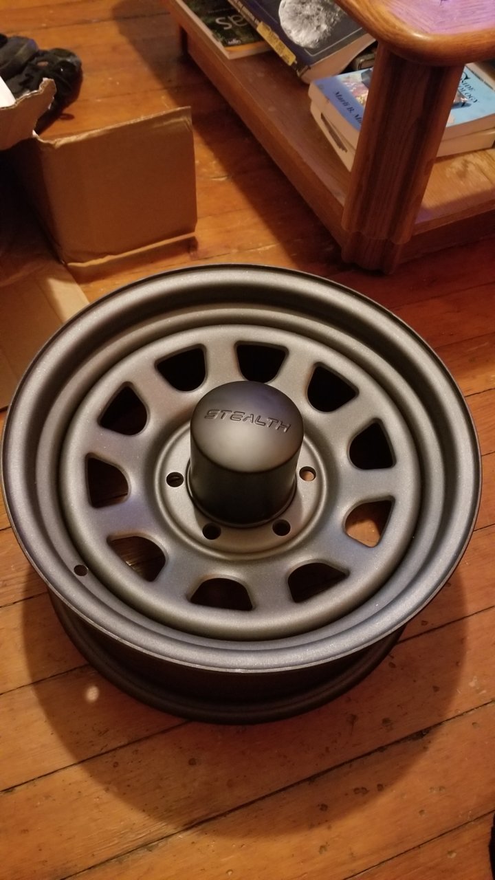

    Here are a couple pics of the wheels themselves that I took last night. Good quality for the price for sure as far as I can tell. They're two piece wheels, and the welds inside appear to be high quality as well. Only thing I've noticed is that the hole for the valve stems on this wheel is positioned such that it might make it tricky for me to get a good seal, at least for the clamp-in, programmable Autel MX Sensors I bought to use with them. Might just need to find a fatter grommet.

    "Stealth"? That center cap is anything but stealthy. Why the hell is that so big?
