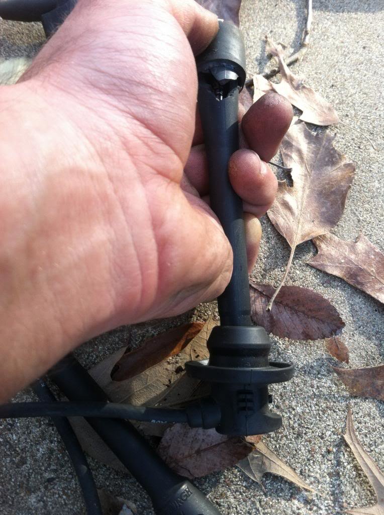

    and the problem goes to......."drum roll"......... Cracked wire boot on cylinder number 2
    Thanks for your help guys!

    I encountered a P0302 while driving home yesterday. @BamaToy1997's advice is solid. I wound up swapping coil packs, plugs and then plug wires keeping track of each change for comparison.
    My issue wound up being a blowout through the #2 plug boot. I confirmed the problem when I swapped #2 and #4 wires. The issue moved to #4 and gave me a P0304 code.
    Since my plugs were over 30k miles, I performed a full replacement with NGK plugs and wireset, replacing the damaged Duralast wires.
    A note for you all: Advice across the web suggests that removing plugs from a COLD engine is best practice. I found that #6 was difficult to unthread, and wound up using WD40 while rocking the plug back and forth, slowly working it out. The plug felt smooth but tight during removal, never feeling like the plug was chattering against the aluminum threads of the head. After removal it was found that the plug had some carbon buildup on the threads that easily cracked off with a fingernail.
