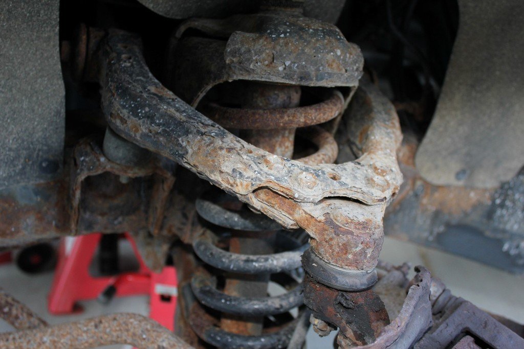

    Hi guys. The ol' man's driver side lower ball joint took a crap just as he pulled into the driveway coming home from work last night (on the bright side, at least it wasn't on the interstate), and I'm trying to confirm some things for future reference, as the only thing that's getting fixed right now is that lower.
    We got the replacement lower at O'Reilly; a 'MasterPro' (made in China), but looking at everything else under there, I thought it would be a good idea to get replacements for the uppers along with another lower for the passenger side. Here's some rather frightening pix that I took this afternoon:
    The broken lower:
    Upper suspension arm:

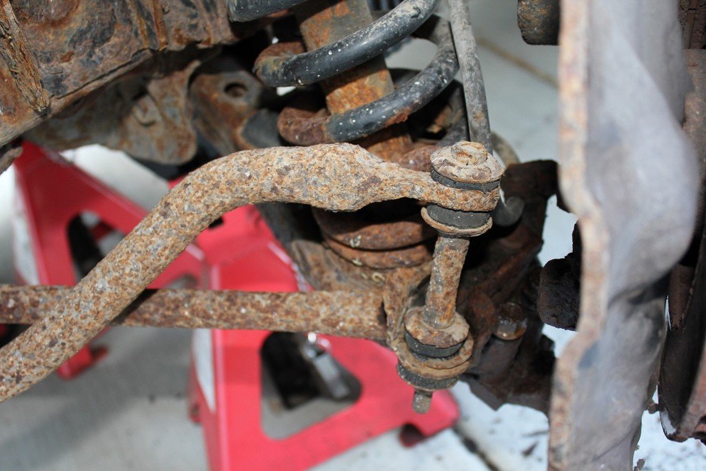

    Strut/stabilizer bar ends:
    We got this truck from a guy in Michigan, so clearly it's seen a lot of long, long, ugly, salty winters. Do these things look as bad as I'm thinking they do?? Granted, there's some shiny metal there where he and his buddy got the bolts out of that lower ball joint, so maybe it's not as bad as it seems to me. But, my God, that upper suspension arm looks like it might flake away completely if I look at it too hard. Surely it would come apart the moment he tried to take the bolts out of the thing. It even looks like the lower boot on that upper ball joint is leaking also, so that's got to be a bad sign.
    Which brings me to my questions.... I'm not finding any OEM style upper suspension arms anywhere, though OEM ball joints are available at Amazon, like this one for the left side. The OEM ball joints have the four bolt holes that go through the upper suspension arms. My question is, will these newer style arms that I'm finding, that don't have those holes, and apparently use these newer ball joints, work for the '95?

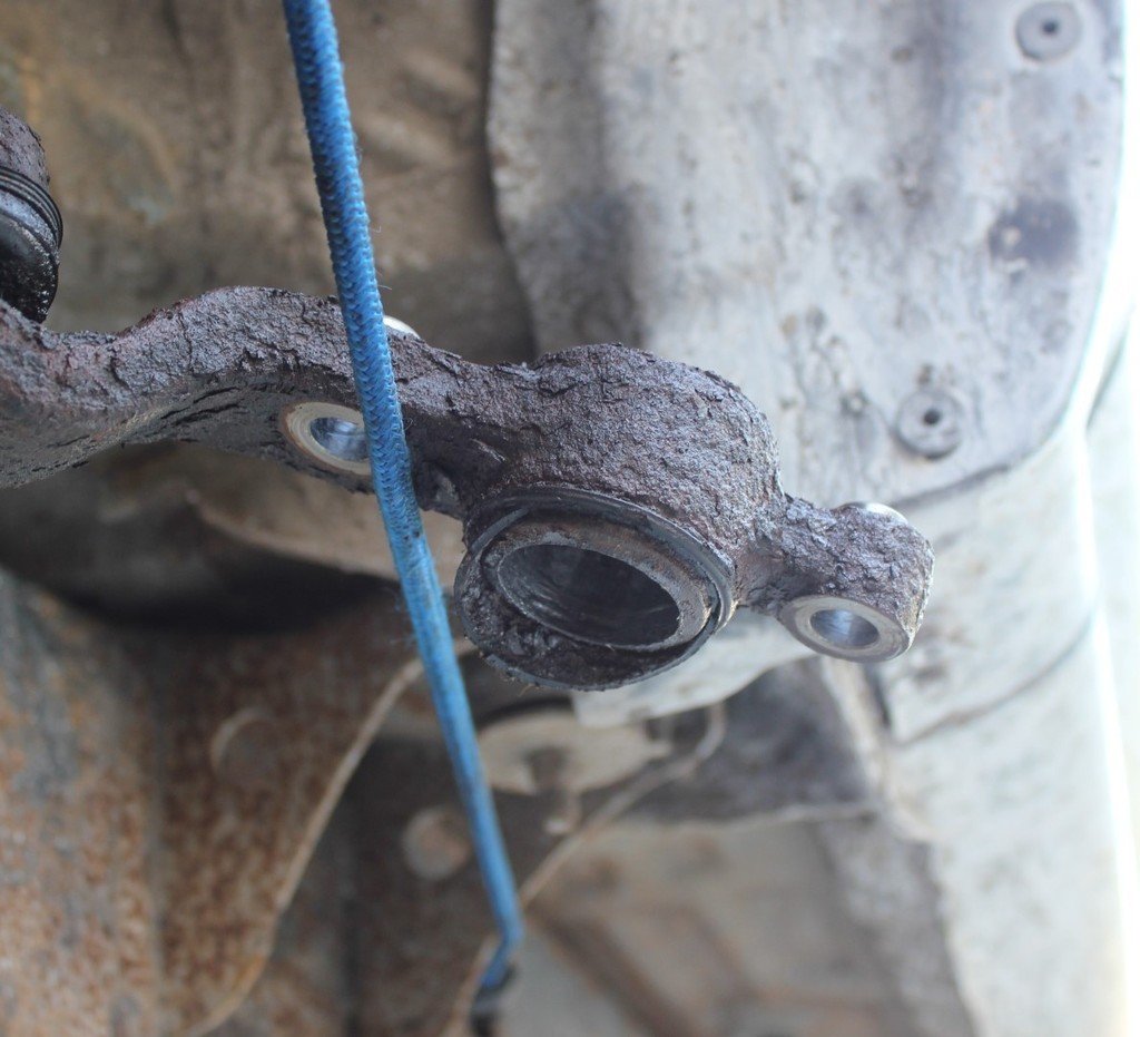

    What about the suspension arm shaft assembly? Do you think that stuff will be reusable? Here's a shot of it from the service manual PDF I have for the '95-97:
    I can't seem to find any suspension arm shaft replacements at the moment anyway, except for one already included in a suspension arm assembly on ebay, but boy is it pricey.

    Wow ive never seen a uca like that! Is this truck a 5 lug 2wd?? And in your info you have a '05 2nd gen peerunner listed, is it a different truck than we are talkin about?
    And wholly hell....RUST! God i hate that shit! Should become illegal for your state to use friggin salt, there are alternatives. the state is ruining vehicles!

    Yes, sorry, I should have specified that it's a different truck from my own. His is the 1st ever of the 1st Gen Tacomas, mine is 1st of the 2nd gen. =) His is 5 lug 2wd, mine's 6 lug 2wd. I'm not sure what else to include except we've both got the 6 cyl versions and extended cabs.
    Thanks for your reply. They must have issued that truck with zero underbody anti-rust or whatever, because it really does look terrible. I'm sure hoping someone can okay this new style aftermarket suspension arm or otherwise have some experience dealing with them in the 95-97 years!

    everything looks rusted. like as in. it shouldn't be on the road! talk to a dealer about the rusty frame first. tell them the LBJ broke due to rust and the rest of the steering, suspension, and chassis looks severely damage as well. see if they are able to do the chassis swap.
    i had a customer come in the other day wanting me to to replace the same control arm bushings in our machine shop. very common occurrence on most other vehicles without those shafts. can't be done on this one though. rock auto has uppers (for a 2.4 4 cyl) for 55 bucks. complete with ball joint. buy this instead.
    but yeah, that frame is RUSTED. it's a hazard. like bad hazard. see about getting the frame replaced. and honestly, you need to rebuild the entire front end suspension and steering. sorry :-\
