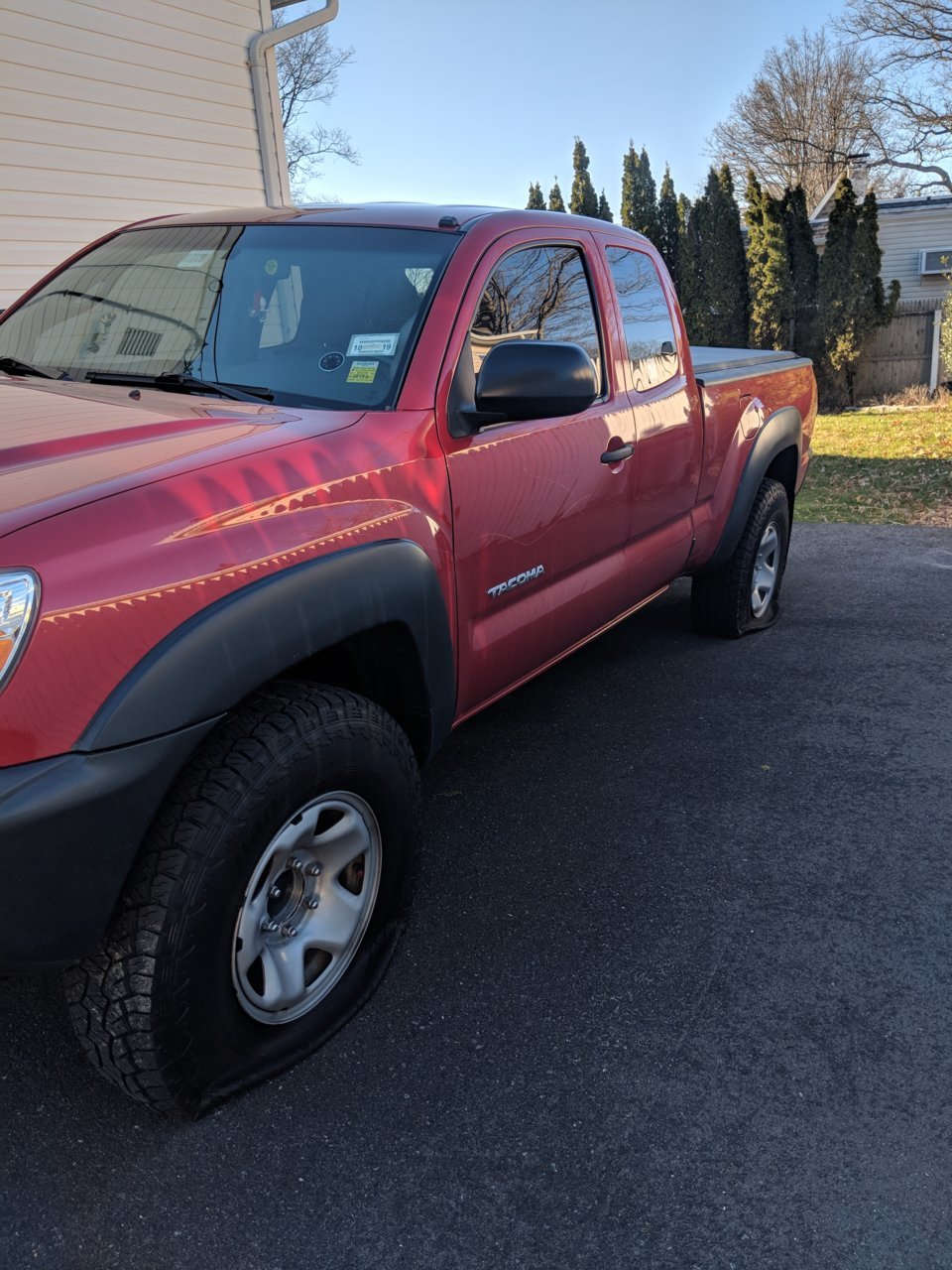

    There are, but I don't have my truck until Friday. Currently dealing with this:
