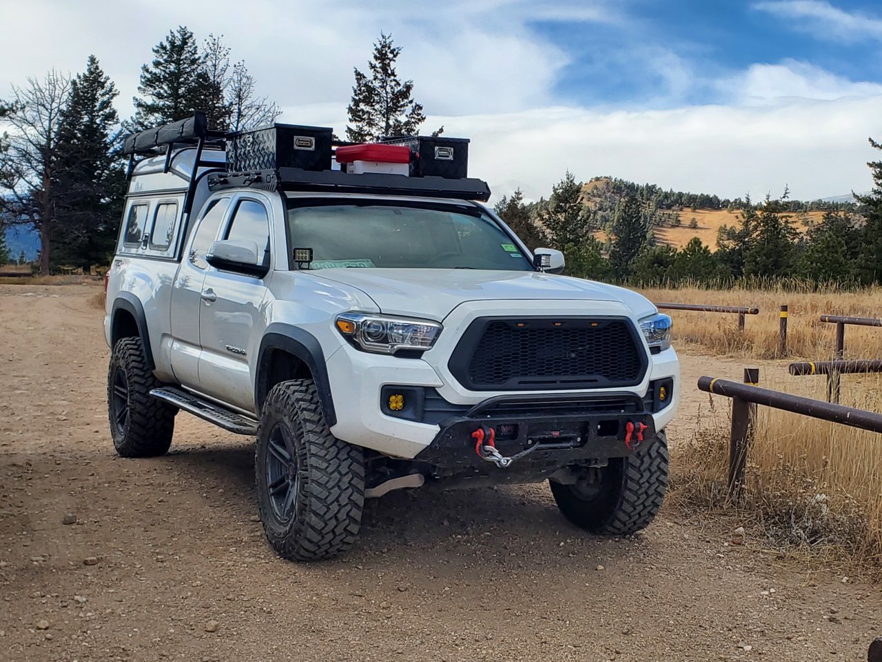

    Anyone upgraded their brakes? Looking at alcon, stop tech and power brake. Not sure if 2k + is worth it or is ther a cheaper option? Pic for attention...

    Not break related but I love the setup what’s height on the topper?
