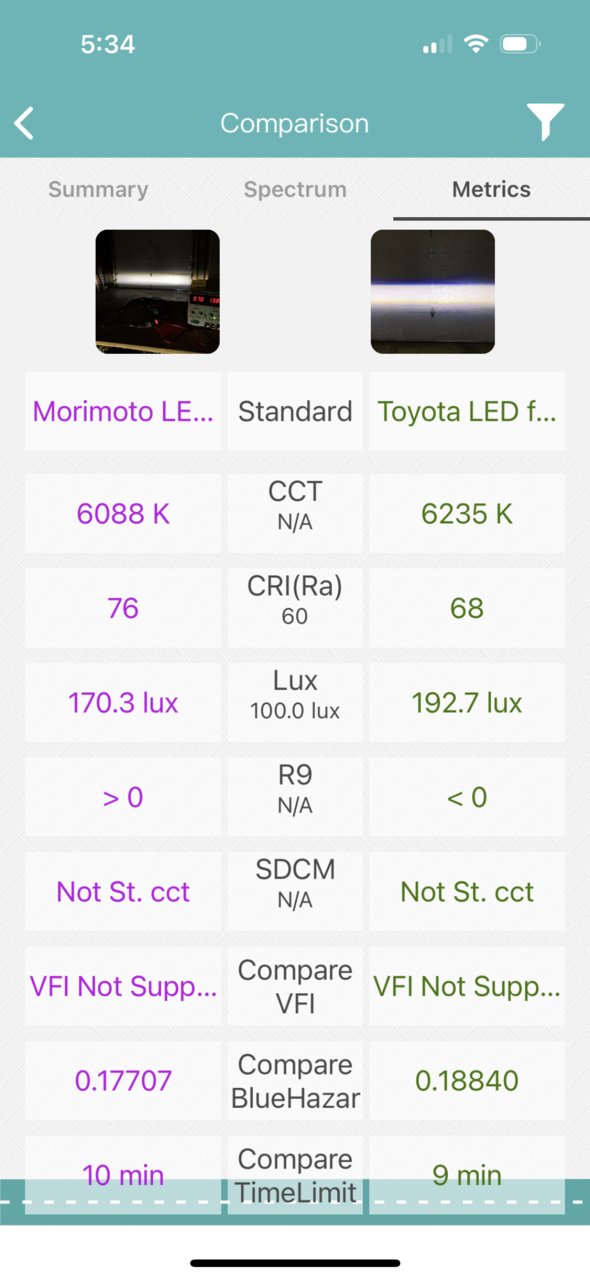

    Morimoto XB vs OEM LED fogs.
    The OEM LEDs are 13% higher in output intensity over Morimoto while costing less and being of higher build quality.

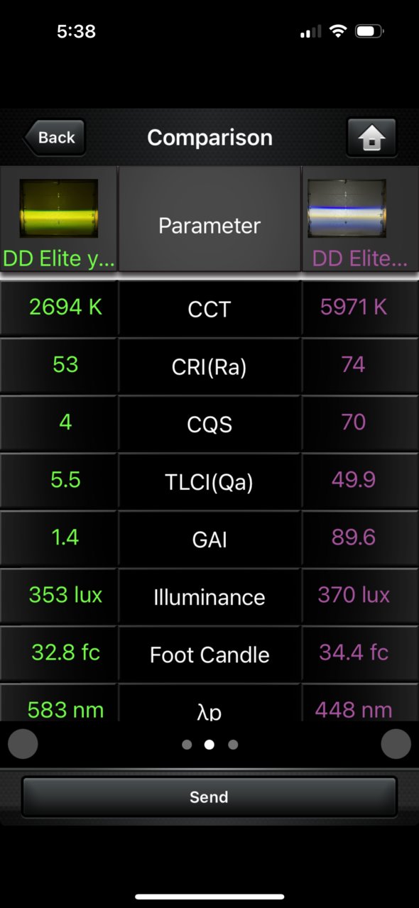

    Diode Dynamics Elites selective yellow vs white
    Diode Dynamics Elites white are about 2.2x higher output intensity than the Morimoto XBs. But most importantly the Elites are available in selective yellow, which is far higher performing in actual fog and poor weather conditions.
    All the fogs are plug and play.

    That picture comparison is bullshit, my morimoto’s spread a beam the width of a runway. Look at the two photos and the backgrounds are different, probably the distance and zoom as well.

    The pictures are not the measured data comparison and are nothing more than a picture for logging in the app. The Morimotos were part of the initial testing batch where the photo also was intending to capture the power reading in addition to the beam style. In those photos there is a pillar obstruction on the right behind the power supply. The other review posts have head on photos and wider angle area photos.

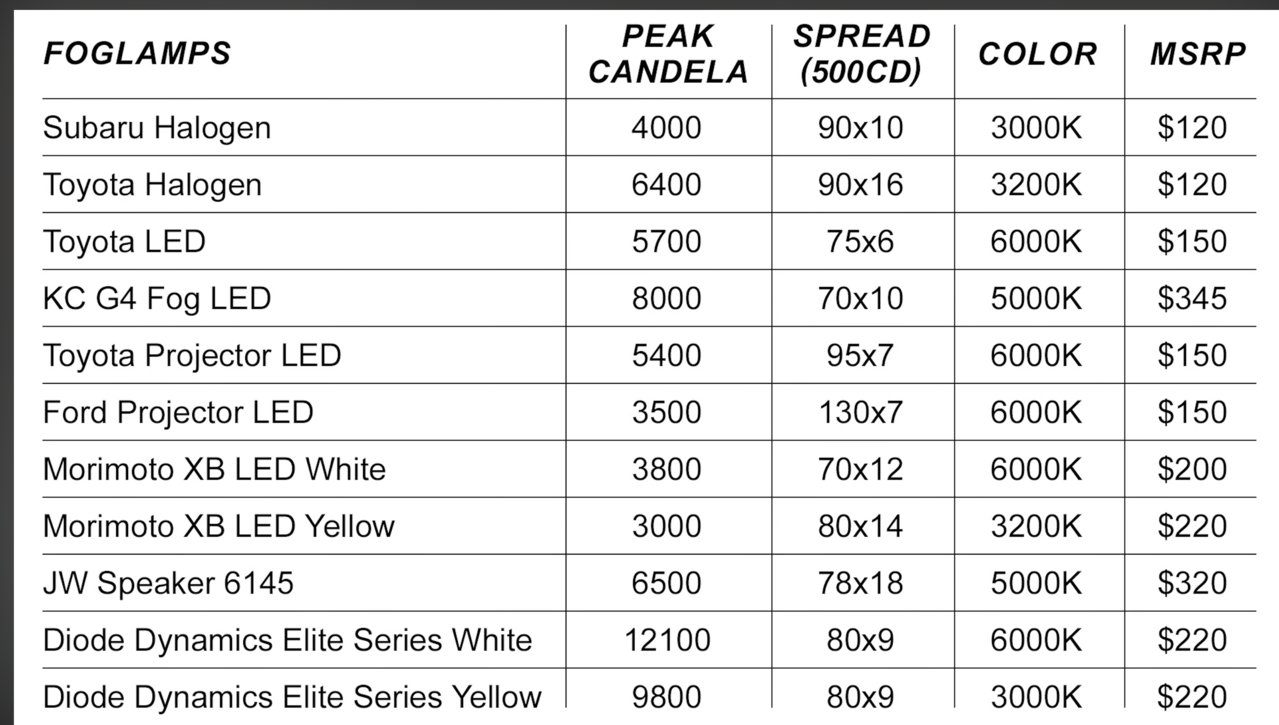

    But from the table below, you can look at more measured data. Both OEM LED and Elite LED are wider than the Morimotos, and higher in output intensity.

    I’m not talking about the data, the photo. I HAVE those lights and they look nothing like that picture.

    No explanation needed….. mine don’t look like that. If they did they’d already be in the trash.
    I’m not referring to any data, just beam pattern.
