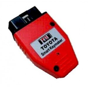

    **Disclaimer**
    I don't suggest people use this device as I don't know who makes it and the quality behind it. NEVER heard of a car being ruined by it BUT I don't take any responsibility...so buy on ebay or Amazon at your own risk.
    What is the device above?
    Its NOT a key programmer at all. What the device does is flash your immobilizer(key) ECU and returns it back to factory state(auto registration).
    What vehicles will it program?
    This will only work with tacomas(Most 05-10) that use the 4D67 Chip keys. These keys have a small dot engraved on the key blade. If you have a G engraved, move along as this procedure will not work.
    This device is more suited for people who only have one master, valet or no keys at all.
    Where can I purchase a 4D67 Dot Key?
    Quality and price vary a lot. Keys are all over amazon and ebay
    How to use device...
    Many instructions online talk about beeps...DONT worry about that.. LOOK at your immobilizer light(center console)
    This method is if you have one master or valet key and your adding ONE extra key. Also for people who have lost all keys.
    1) Turn ignition to ON with any key(engine not running)
    2) Insert Smart key maker into obd2 port
    3) Keep looking at security light, When it comes ON solid, remove smart key maker.
    4) remove key and re-insert but keep ignition off. Light will flash once and then turn ON. Remove key(its programmed at this point)
    5) Insert second key, light will turn off and then back on again.
    Second key is now programmed.
    Take any key and cycle off to ON in the ignition about five times very quickly to turn light off.
    This method is if you have two keys and your adding a third.
    You can only program Two master keys and one valet, So if you have two Masters...Third key must be VALET.
    If you have one master and one valet... Third key must be a master.
    4) Remove key and re-insert but keep ignition off. Light will flash once and then turn ON. Remove key(its programmed at this point)
    5) Insert second key, light will turn off and then back ON again. Remove.
    6) Insert third key and light will Turn off.
    Third key is program and you are done.
    If you have generic keys and visually can't tell what keys you have. Check out video below.
    https://www.youtube.com/watch?v=ehtnF91aPY0
    I say in video that you can't add keys by using a valet key...This refers to proper programming methods. Above instructions are not normal and you are erasing your ECU.

    I used the same plug in programmer to program my key, it took a couple tries but it works.

    Thank you so much for these instructions. It worked exactly as described. I was down to a valet key only. I was able to reset my system to have 2 new master keys (ordered from you), and my original valet key.
    I just hooked up my TechStream, and the system shows 2 masters and 1 valet. I was able to add additional master keys with this software without any issue. I went from having only one key to having a plethora of backups.
    Thank you soooo much.

    Just got the smart keymaker in the mail and all worked great! Thanks so much for posting this and saving me a bunch of cash!!
