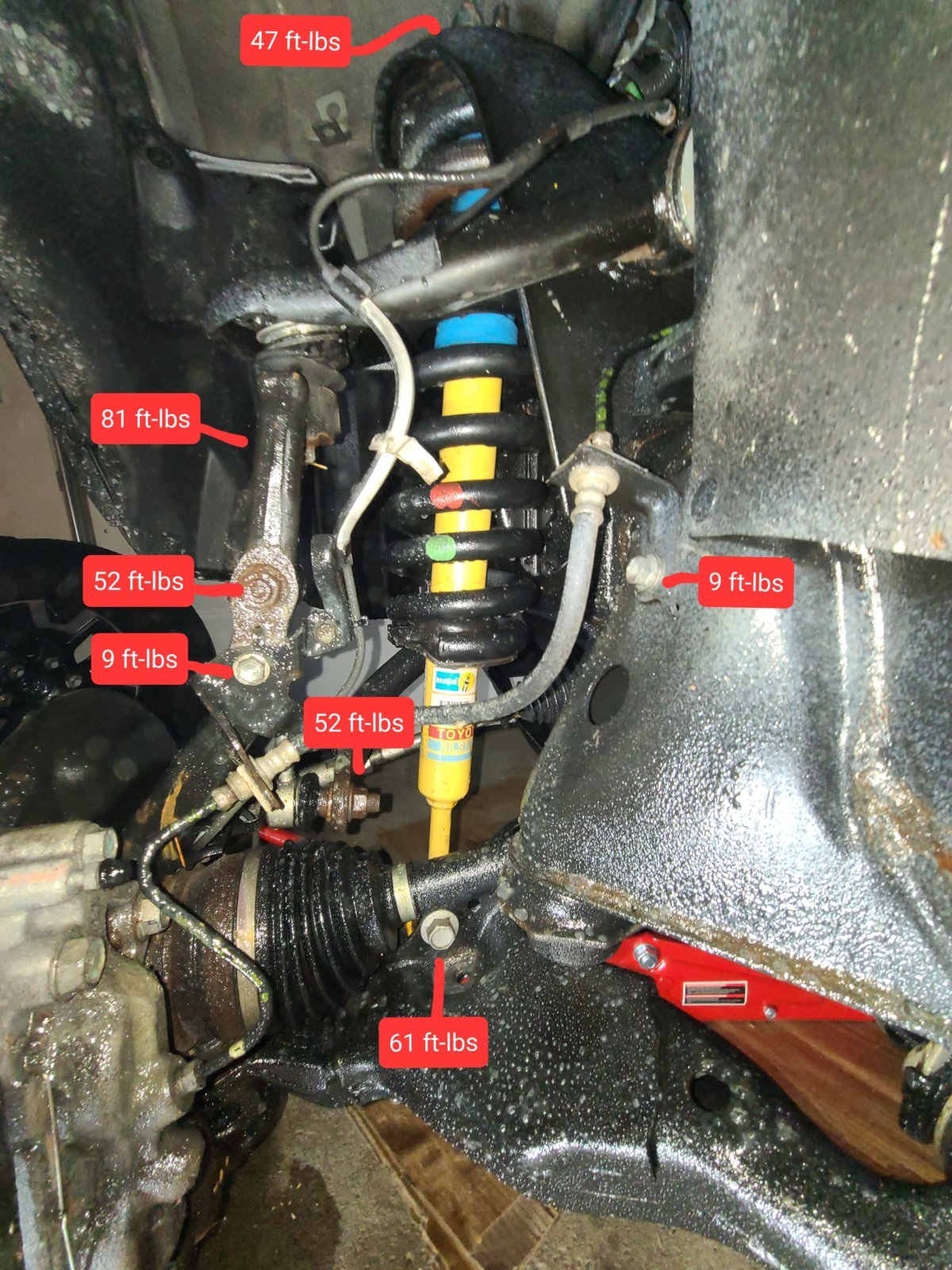

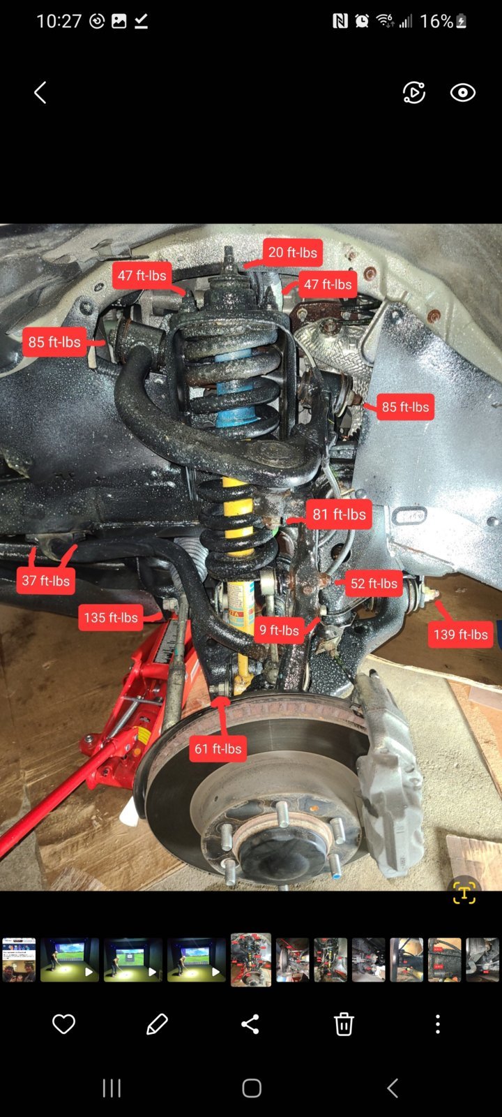

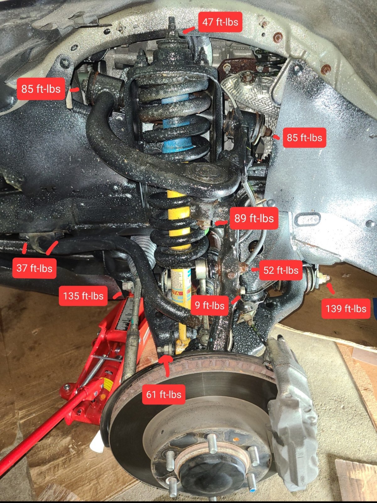

    *** Big Update ***
    Along with Torque Specs, the document now has component diagrams and On Vehicle Inspections. Table of contents added.
    Added an Undercarriage Focused Torque List
    Torque specs straight from Toyota
    Specs updated by Toyota current as of Feb 2024
    See attached 35 page torque spec document. You won't be disappointed!
    For Gen 3 Tacoma 4x4 Trims including TRD Off Road Full Cab 2GR-FKS Engines
    Specs below in N*M / KGF*CM / FT.*LBF / IN*LBF
    *Update - Wheel lug nut and tire pressure warning valve added to PDF*

    Screenshot_20240324_223042_Gallery.jpg 20240323_144519.jpg Screenshot_20240323_135337_Gallery.jpg Screenshot_20240323_135321_Gallery.jpg

    Very good information much appreciated but one change needs to be made: the recent axle nut recall increased the torque spec from 33 ft-lbs to 41 ft-lbs.
