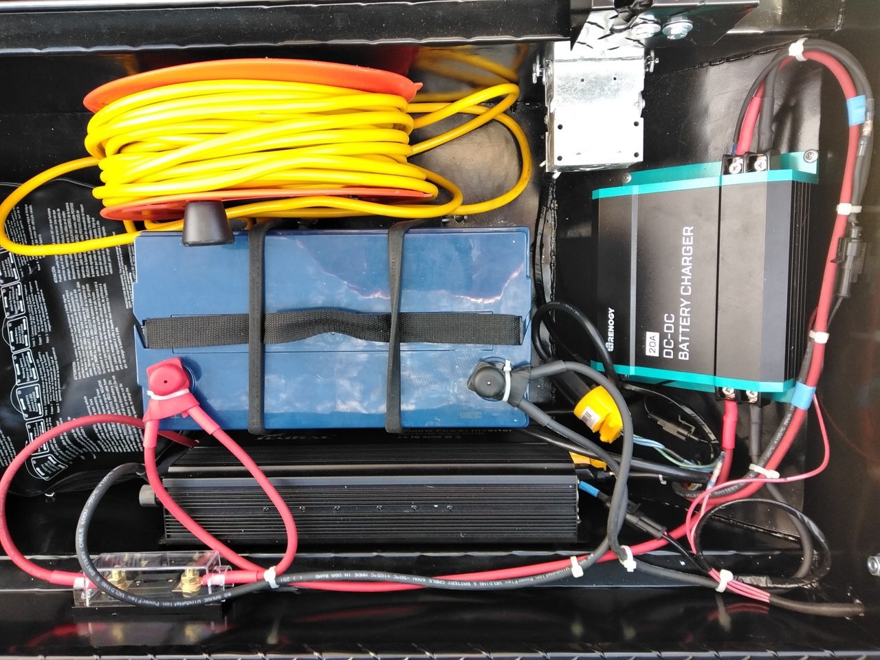

    2 inch lift , tires and wheels
    I installed a 6000 watt inverter and a Renogy 100 ah deep cycle gel lithium battery in my toolbox. Then wired 2 receptacles on the outside of the box. Im able to run my tv, cable box , fridge and several lights for hours before cranking the truck to recharge.
