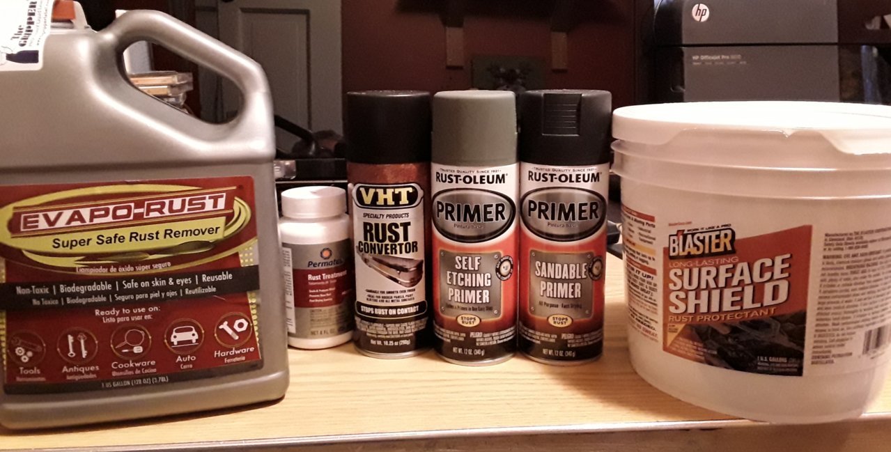

    I have heard good things about Evapo-rust. Surprisingly only know of a few people here in the NE who use it though. I really ought to buy myself a jug and try it.

    So far I sprayed Fluid Film on bottom of my ( inside) tail gate, and bottom inside of one door , especially on the lowest point seam. Did the other door with, spaying surface shield .Testing different products.Waiting to do under truck , but been too cold out.Need 65-70*F and humidity below 60. % per mfg recommendations.
    Humidity is important , under 60% or you seal in moisture.
