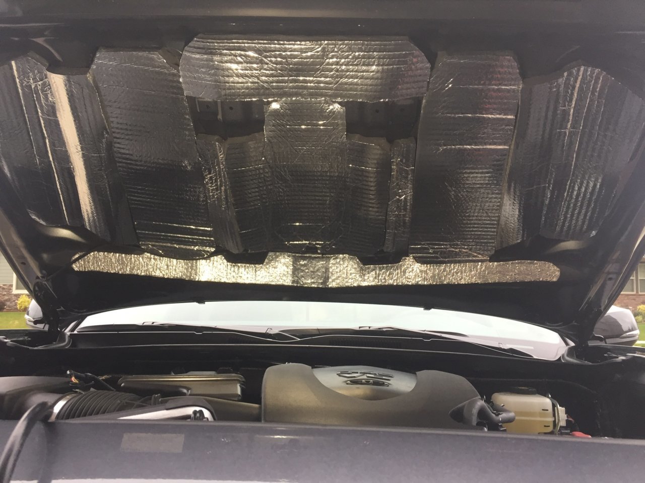

    This is 3/4 inch thick insulation made for engine compartments, installed about a year ago. As it is adhesive backed, it was best to cut it in small pieces to cover the hood. I can’t remember the name of the manufacturer, purchased online.
    It definitely helped to decrease engine noise, along with firewall, floor and rear wall insulation and sound mat.
    I don’t like the look of it, but I’m the only one opening the hood and I’m not displaying it at car shows.
    I installed 1/4 inch insulation in one piece using circle clips on our other vehicle, as it had over a dozen small holes in the hood for that purpose.
    It’s a 2013, last model year compact SUV where they decided not to include the hood insulation as on all previous model years.
    My wife complained of the vehicle being noisy, so I insulated hood, front wall, fenders and floor.

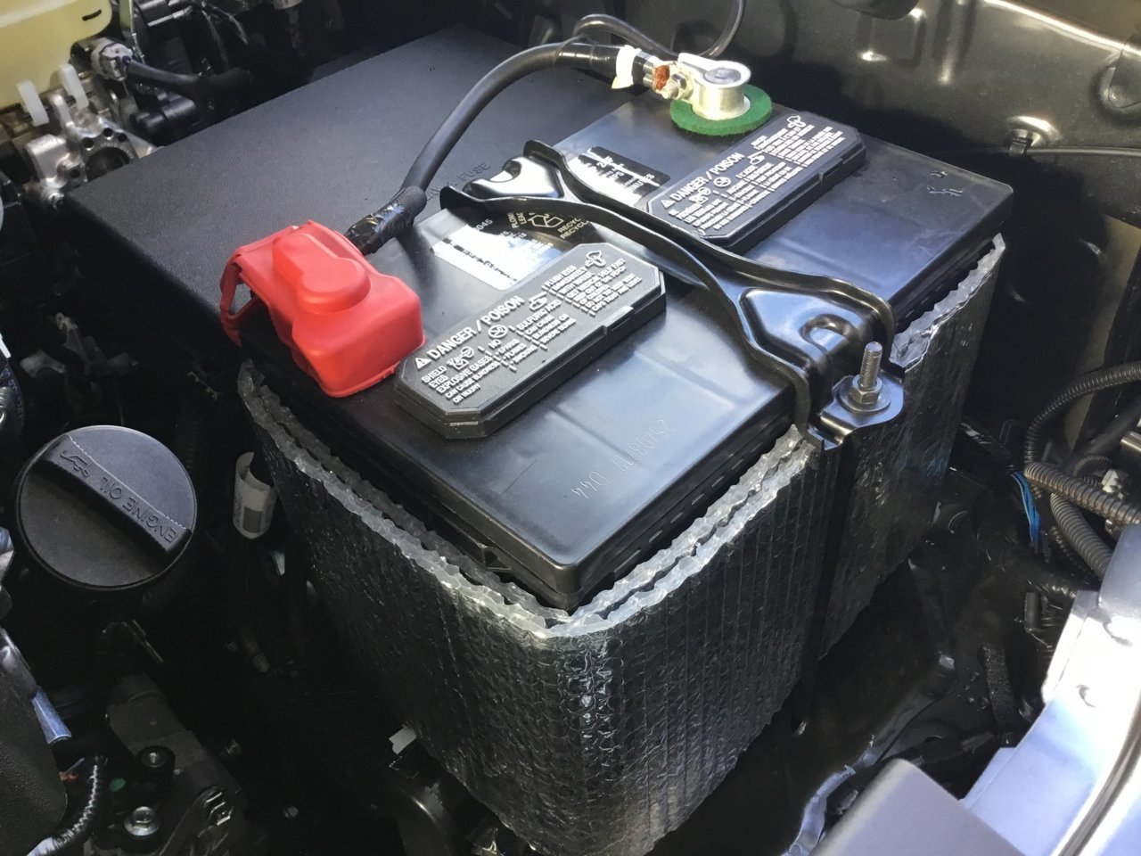

    Speaking of insulation.
    Keep your battery warm in the winter and deflect heat in the summer.
    Left over from duct insulating. It’s also fire rated by the manufacturer.
    I tested it over a BBQ lighter to see what it would do.

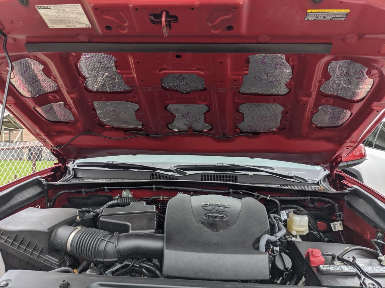

    I did this to start.
    Noico 80 mil sound deadener under the hood in all the recesses formed by the hood structure and support members and this DEI Underhood thermal acoustic liner mat is going in soon as a full mat, glued backing and push clips where available holes exist in the hood.
    Edit: I might add more Noico 80 mil to some more of the structure, now that I look at it again. I'll need stronger front coils!!:rofl:
