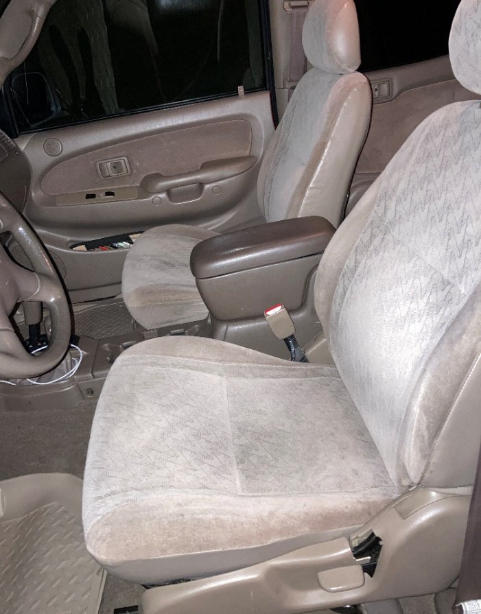

    Dumped my bench and went to stock Tacoma buckets right away:
    Then found some 4runner Sport buckets:
    Then I was fortunate enough to find some Tacoma Sport bucket seats from a wrecked SRunner, which of course is the way to go for oem fit, patterns, and the utmost comfort and support from a factory seat in these first gen's:

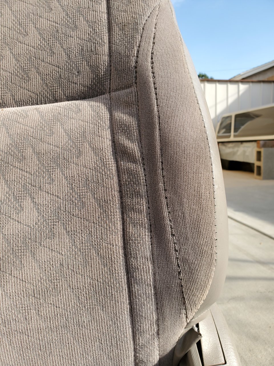

    Here is the issue with the seats I started with for the write up, note the home made repair job and extra stitching on the back rest side bolster:

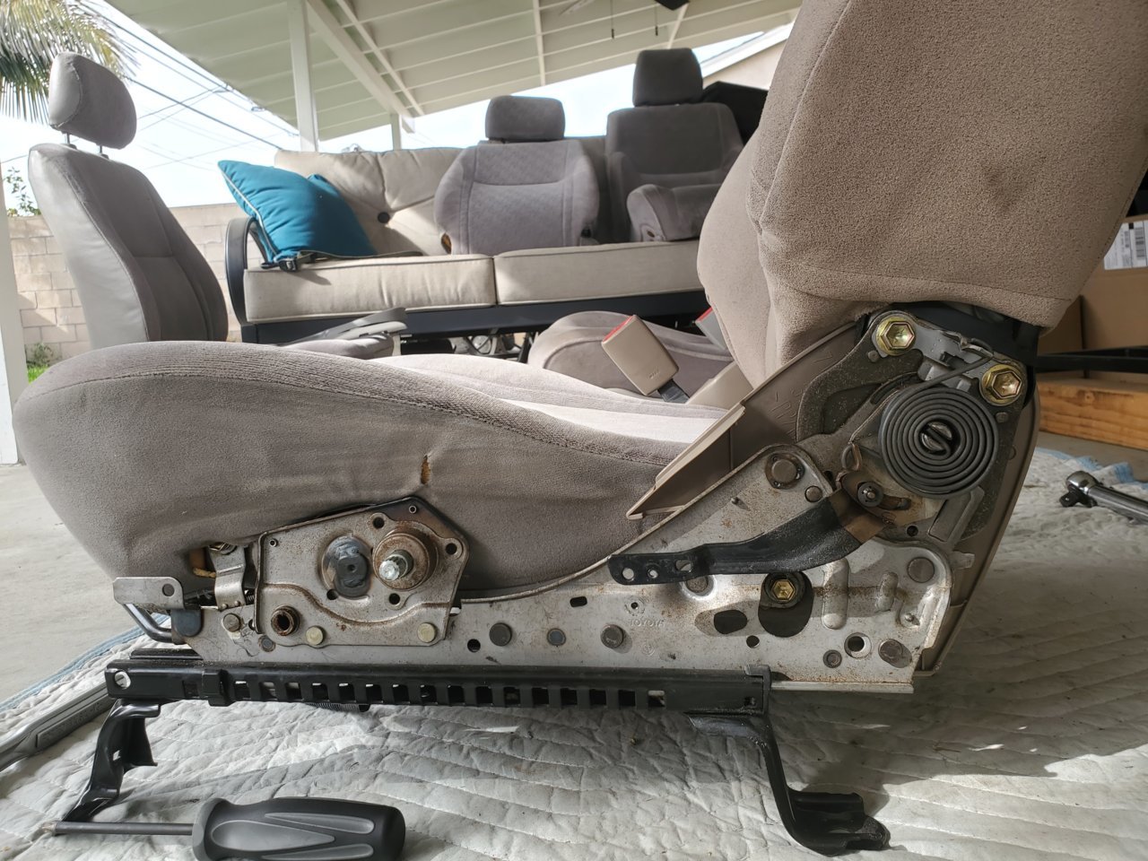

    if you dont have the seat out of the truck it may not be as easy to do the swap. Remove the 4 bolts per seat and unplug the harness to the seat belt sensor on the driver side prior to sliding it forward and pulling them out.
    Then we can start the seat tear down process. First remove the recliner handle with a phillips screwdriver. Then the trim piece by removing another screw, pulling on the front of the panel to release a clip, then slide the piece back and away to remove. The previous owner had drilled an extra screw through the trim since most of these break, so I had to remove the screw circled in red below too.
    Move to the other side and remove the screw, then pull the panel off by hand again gently.
    Once these trim pieces are out you can unbolt the lap cushion with 4 bolt, two on each side. The bolt up front is a bit hidden by the cushion in the pic, but it is in the green.
    In this case we are moving on to the back rest, which does have a couple more steps. No need to remove the lap cushion, but you do need to fold the seat forward to remove the back rest cover enough to remove the cushion.
    With the seat folded forward grab the bottom of the cover where the seams meet under the back rest and pinch them towards each other into the center to release tension and unhook the back cover. Then start rolling the cover up by turning it inside out on one side, then the other little by little.
    Do not pull the cover off all the way, but roll it up enough to reveal the 4 mounting bolts, 2 per side. Be gentle, as I could see the cushion I was replacing was also torn in this area:
    Here it is below, no need to remove both cushions, just what you are replacing. It is also easier to do one at a time if you are swapping both, as this keeps your tracks aligned together for you.
    The assembly is of course to simply reverse the process. One PRO tip though is to grab the metal clips that holds the plastic trim pieces into the frame and place those onto the plastic trim panel before installing so they clip in with out destruction.

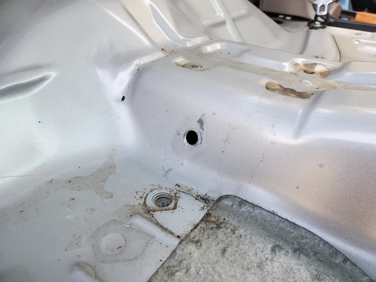

    * Regular cabs need holes drilled into the transmissions tunnel to swap from bench to all buckets. The factory left a nice circle showing where to drill with a 1/2" bit fortuitously.
