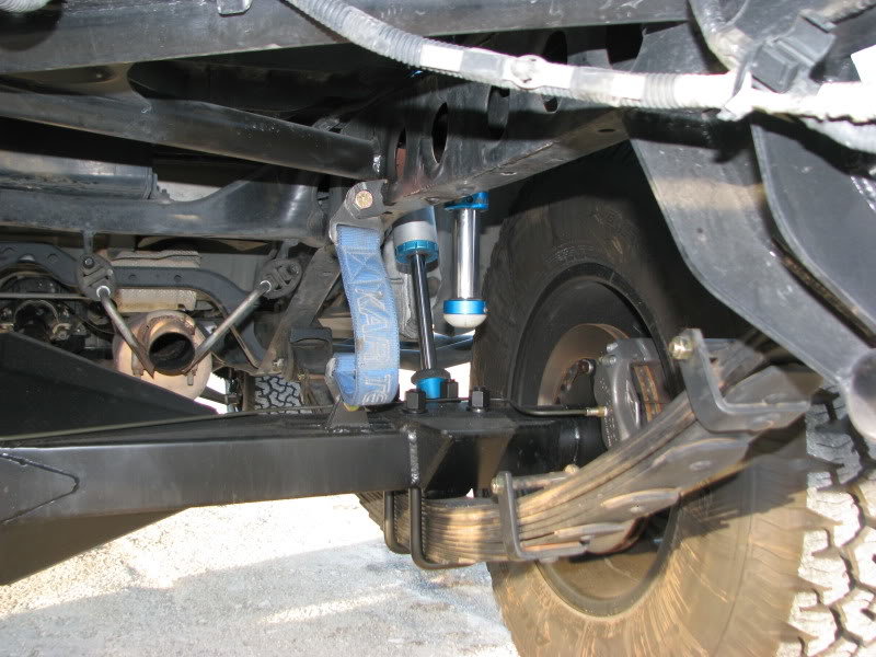

    hey guys,
    i am having problems with my 50T leafs staying in alignment and i think it is because of the U bolt eliminator kit. i in no way mean to bash on engage but the way the elimintator kit is built there is no side to side movement support of the leaf pack. a few of the leafs are sliding out of alignment and it makes me:confused:
    ill post pics later today

    i was curious about this a while back when you got your rear end built, the eliminator kit looks to be mounted way crooked....

    no its not crooked that must just be the pic. and you have the u bolt eliminator kit? did any of your leaves ever slide out of alignment? or just the bolts came loose?

    That's looks scary to me. Could totally be the picture but just material looks thin.
    Not true. The rear end on the PLOW was built by Paul at Zero Tolerance Fabrication. Everything was beautifully welded by Paul not Hassim. It was then modified by Hassim to support links. But U-bolt eliminator setup was built by Paul. The design is Completely different.
    Here is the ubolt eliminator on the plow. Does not look the same to me.
    I built my own eliminator setup and have not had any issues at all.

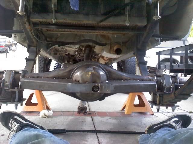

    i was telling mark (not sure if he is on here) first off, those plates on the u-bolt eliminator kit are too thin for what you are doing, you can see in some pics just from tightening them in the shop they were bending, mark is the guy engage did the cantilever setup on as a prototype or first install (whatever you want to call it) anyways, use a thicker plate and its simple to fix your leaf problem (twisting) just go to lowes and pick up some 1 or 1.5" flat stock. cut it the length of your lower u-bolt eliminator plate and weld it on that plate just on the side of the leafs, this will help keep your leafs in line.
    This will fix your prob. Good luck.

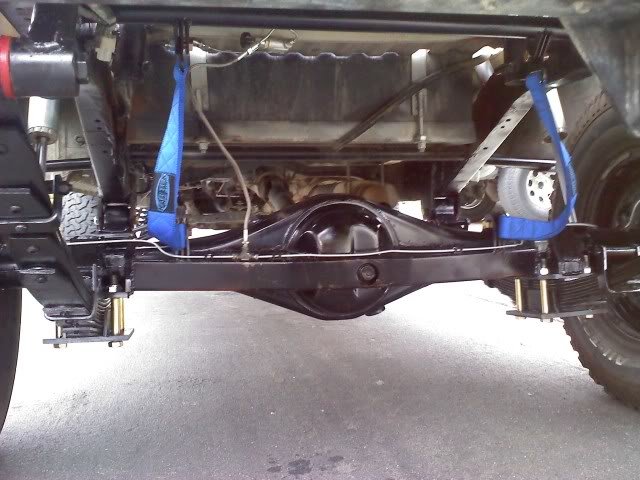

    On the bottom plate I have some flat stock on the side to keep the leafs from twisting.I been wanting to reinforce the bottom plate so it doesn't flex/bend but being a lazy ass. But again if i bend that bottom plate that is 3/8 im sure i have broken leafs or bolts. Here is a better picture to see everything as I was building it. I got my design on the eliminator for John that just posted above me.
