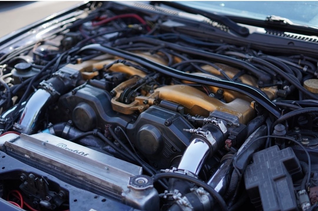

    8 years ago I built and swapped a twin turbo VG30DE into my 1990 300ZX to replace an NA motor that the car had since factory. I put 45000km on the new engine. It ran great, was tuned very reliably by SpecialtyZ, and was so much fun, but it always had an oil burning issue which was either valve stem seals or turbo seals, and it finally got so bad that I was going to get lung cancer if I left the windows open in the summer, and everyone behind me was choking to death too.

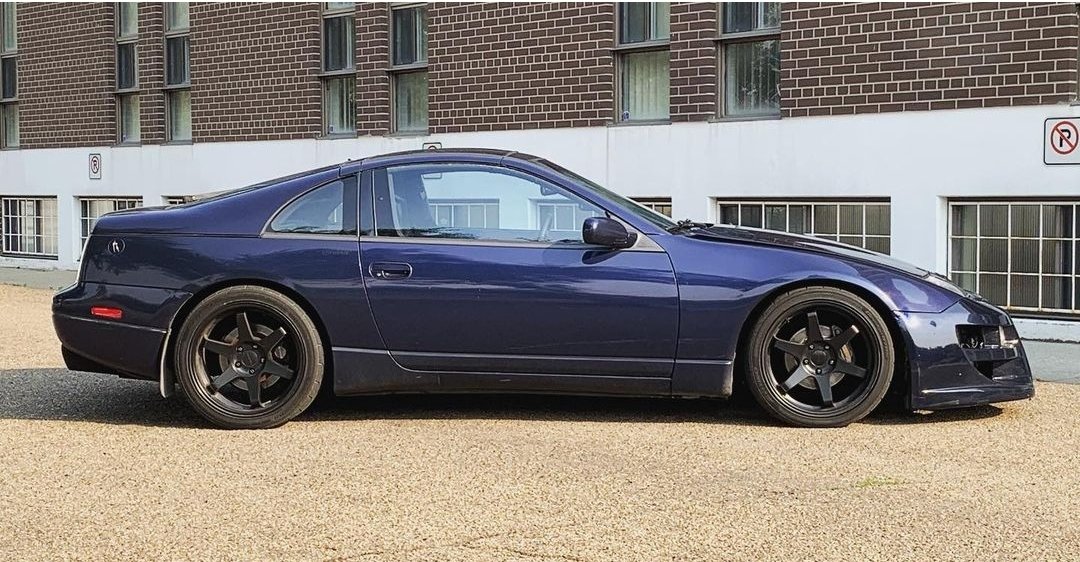

    Here’s a picture of the car with its engine from the first swap. It was a resounding success given at the time I had no experience and had never done anything remotely like it before, and it ran very well for 8 years.

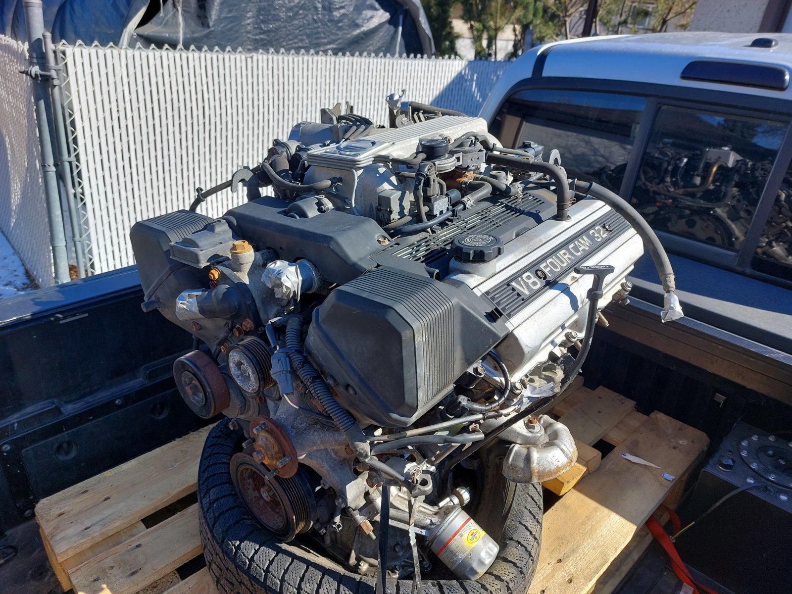

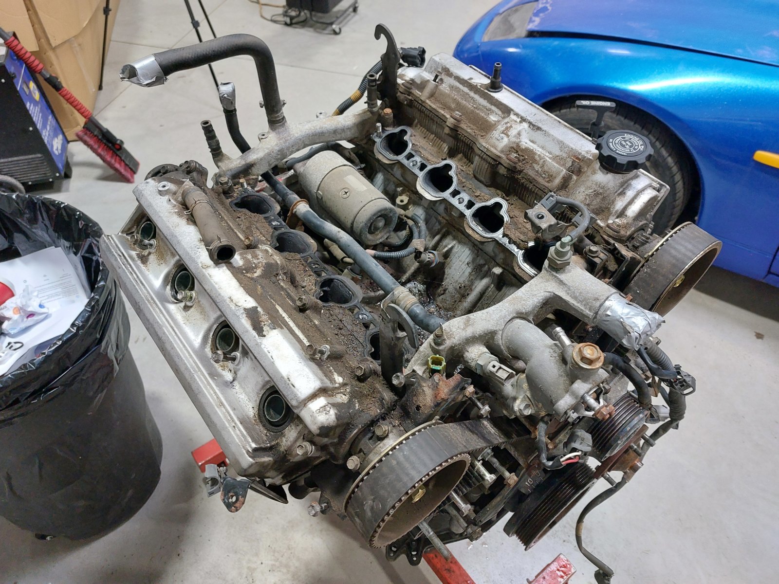

    I found this engine at a wrecker (from a 1990 LS400) about an hour away that was missing most of the accessories and the exhaust manifolds, however since I am going to replace most of that anyways, I accepted it at $1000 (which is like, less than $700 USD, lol). I spun the motor by hand and it had some compression and no play, so I think it'll be OK as a rebuildable core.

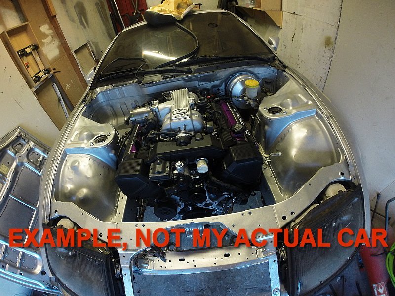

    Here’s a mock up of a 300zx with the 1UZ albeit with quite a bit of jewellery missing.

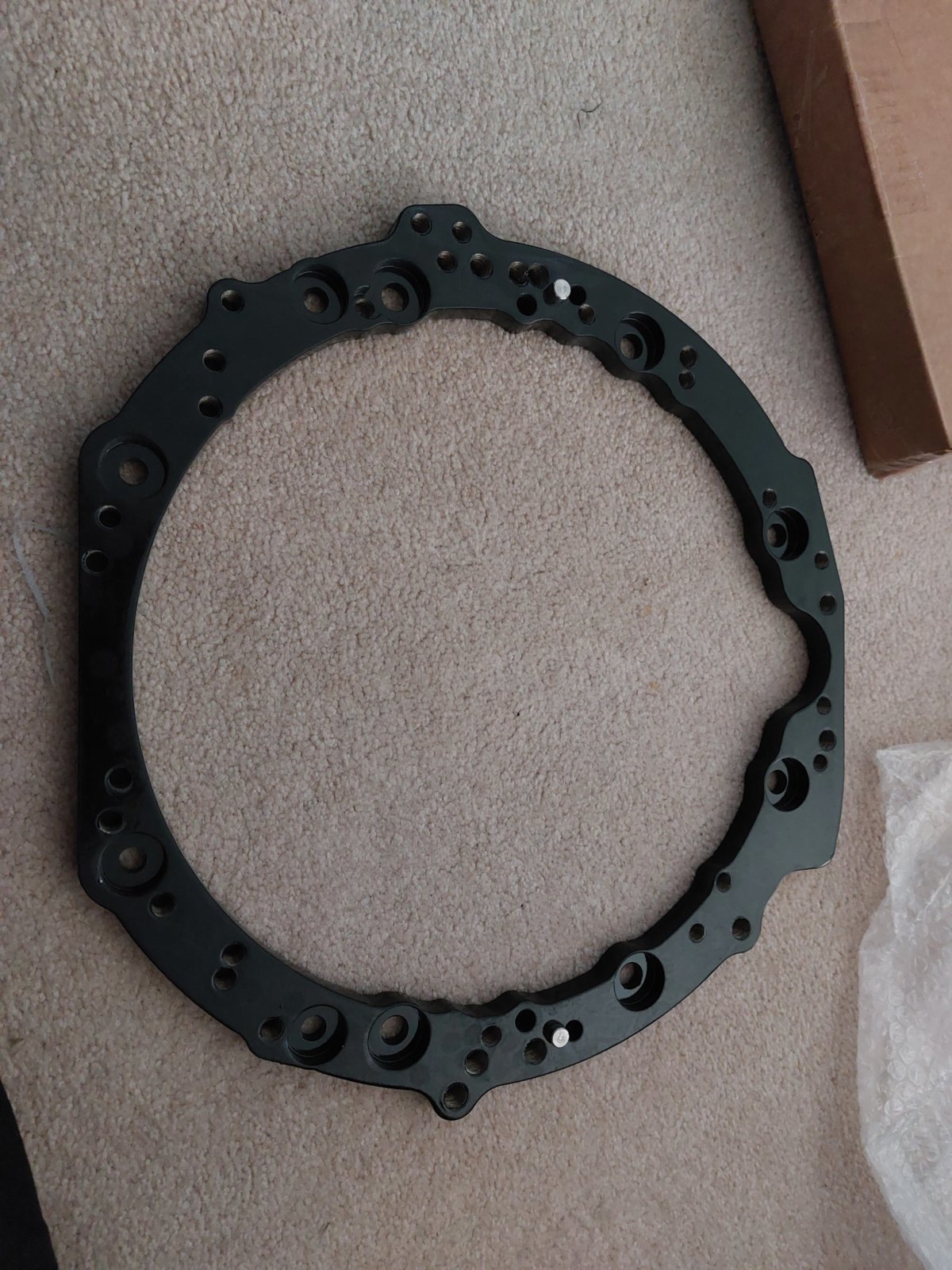

    One big limiting factor is the adapter kit for my 300ZX ’98 spec transmission is not recommended for torque much above 500ftlbs. That allowed me to scale back a few parts – I won’t need new rods, for example. The stock 90-97 1UZFE rods have been proven capable of 500ftlbs and 500whp.

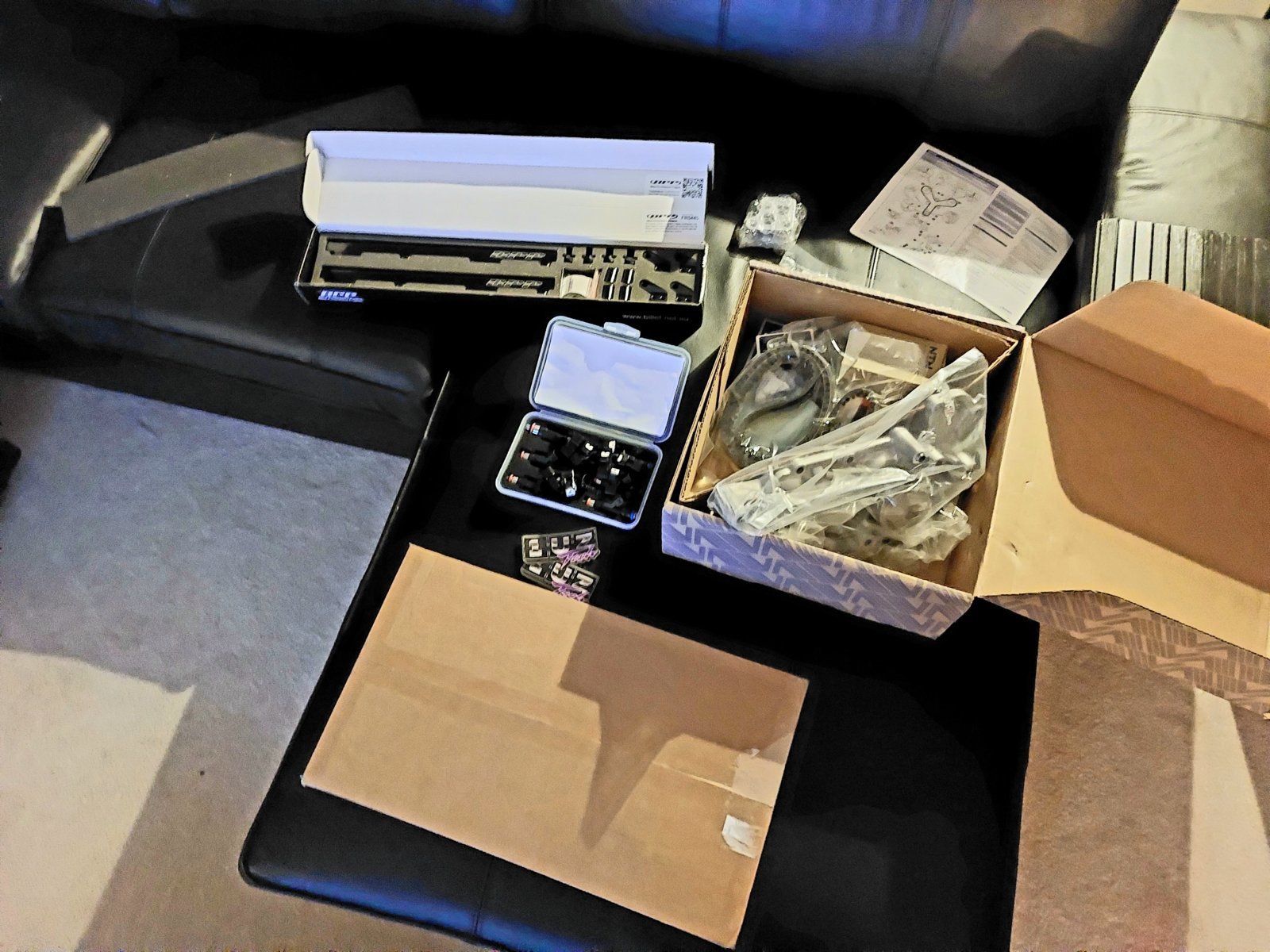

    A few boxes of parts have already started to trickle in.

    Some more parts today, fuel rails, injectors, filter relocation adapter, timing and gasket kits.

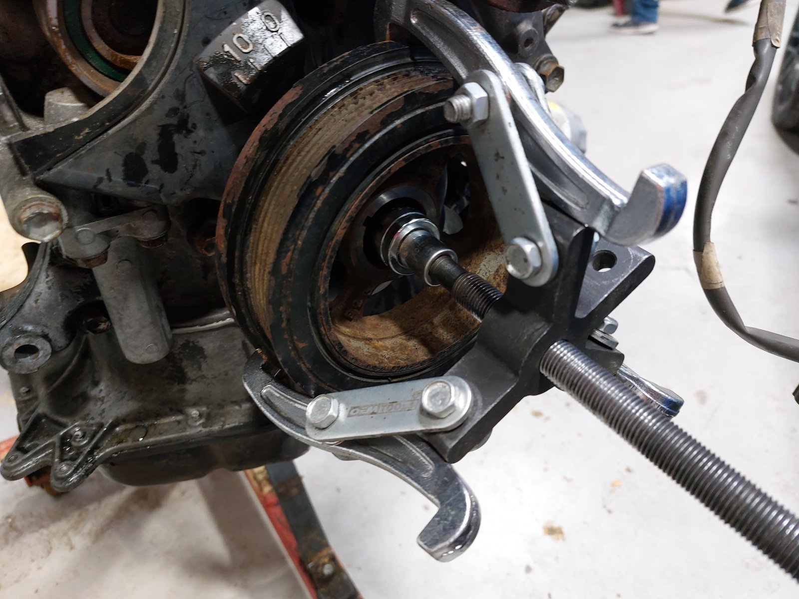

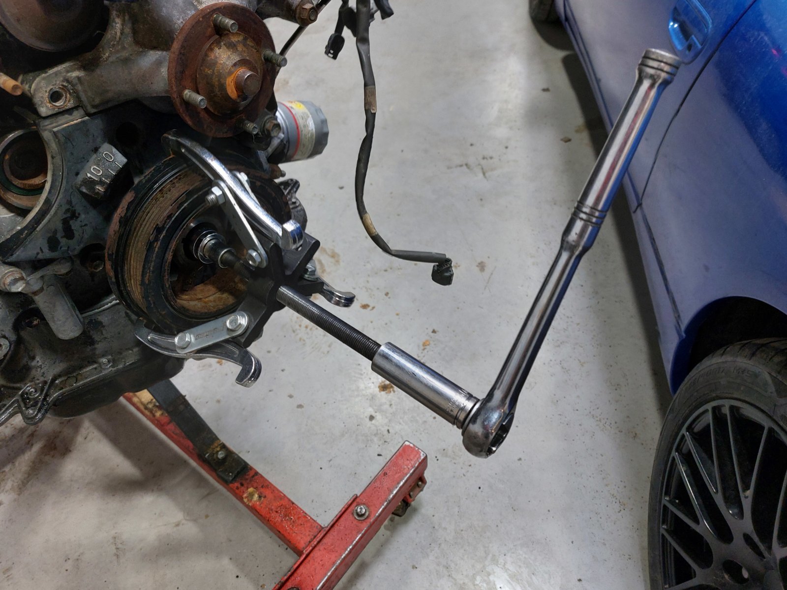

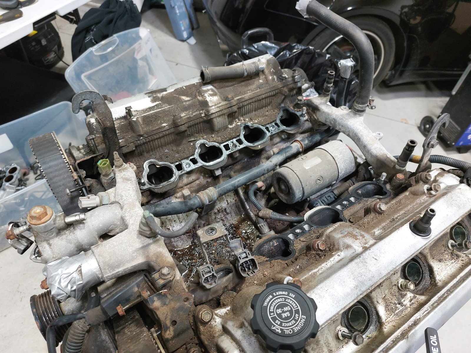

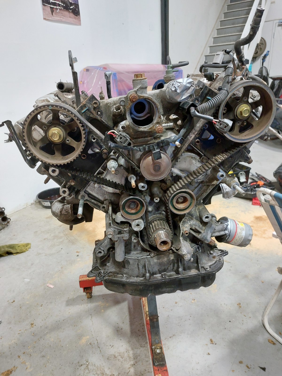

    Started taking the engine apart today. That's 34 years of dirt right there...
    The 3rd picture is the adapter to make my 300ZX transmission work with the 1UZ. It will also adapt to the 350Z and 370Z transmissions. So I can switch to a different transmission at some point if I decide, according to the seller, to make more power.

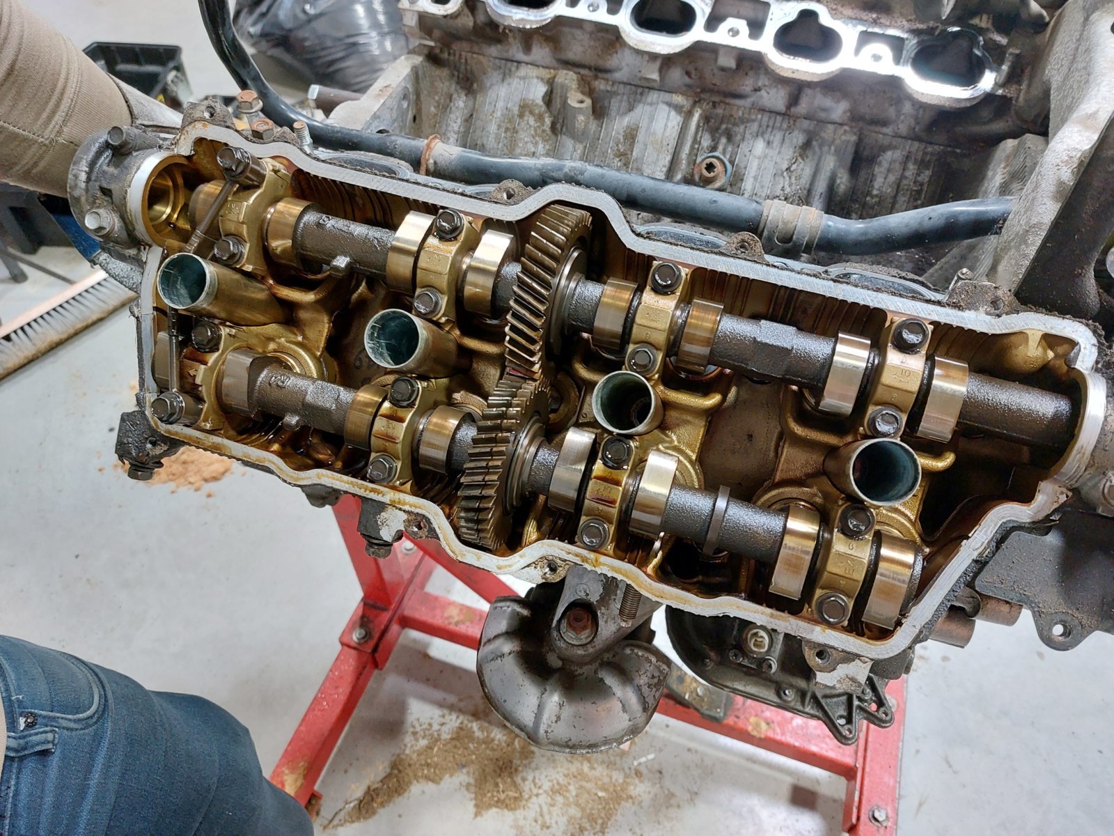

    Not too bad... the plugs were good too.

    That looks really good for the age of that motor.

    Yeah I think so too, I was expecting more sludge than that for sure.

    This is proper OCIs.

    Dude thanks for that - there's not a lot online if you do some basic google searches, I found three companies that seem to dominate after market parts, they were good and shipped fast. 1UZTech actually offers a plate like you just described for the intake that fits the Holley - however, my friend wants to weld up a custom fabbed plate and intake. Probably will end up being a similar price and will fit the car better without needing to modify the hood. He's super creative too, and will make it look really unique.
