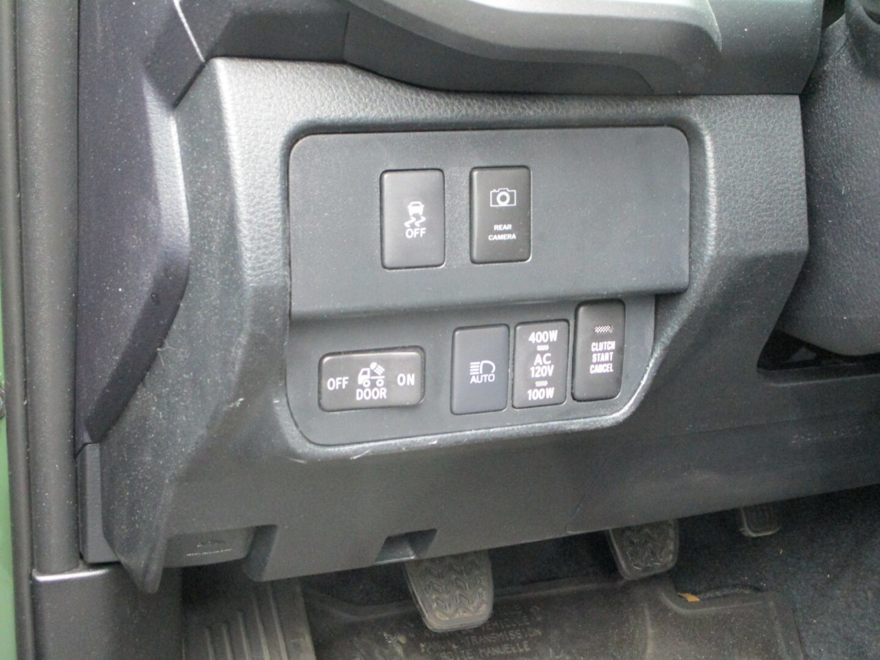

    This was the first and most useful mod that I did. Added a dash switch from Air on Board and a jumper harness (for switch illumination) from Kyle Morgan.

    Simple answer, NO, if you dont have anytime camera. If you dont have that, you will need to install it.

    you can do this easily without a harness. all you need is a toggle switch. that switch applies 12V to a "REV" wire in the head unit (it simply tells/fools head unit you are in reverse).
    easy to find wiring details in forum. i went a little further and got a fuse socket extender to easily tap the 12V where i wanted to on the interior
    fuse block. I got the info off the many posts in the forum. one caveat: with my quickie install i had to splice into that wire.
    if you go the harness route, that is not necessary.
    one additional thing: i absolutely wanted to do this when i first got the truck. now i forget i did it...i very rarely use it. ask yourself
    if it is worth it...but some things are so simple they beg to be done. your call.

    Anytime Backup Camera works great. Easy plug and play. If you off road your truck, it's worth getting the front camera too. Coming up over the top of a climb and you can't see what's in front of you, camera shows any obstacles.
