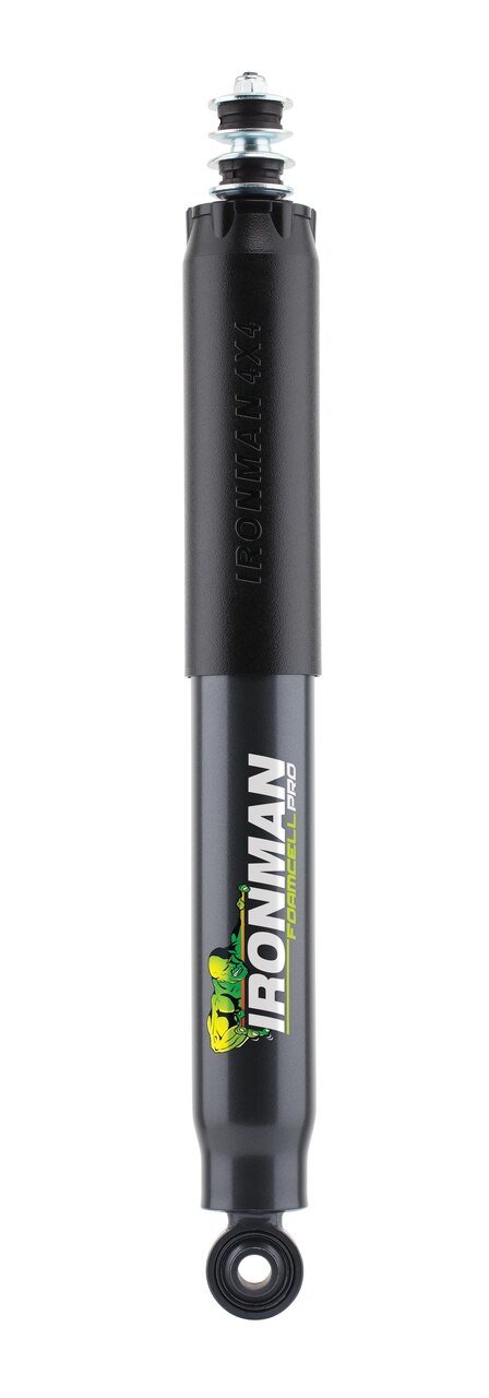

    I hear some folks run Tundra shocks in the rear to gain another inch or so of travel when lifted with an aftermarket leaf pack like Deaver, Icon, etc. What gen of Tundra shocks are we talking about? Are the mount points the same, or some modification required?
    I was comparing the Ironman4x4 Foam Cell Pro shocks and they appear slightly different where it mounts to the axle.
    2007+ Tundra on left, 2005+ Tacoma on right:

    It's way thicker, the bore of the shock doesnt fit through the top.

    AccuTune talks about their Tundra Fox shocks that are compatible with the Tacoma throughout the thread. You just have to use the search

    I'm running Tundra rear shocks on my 3rd gen . 2009 Tundra as i remember. The lower mount bushing is 1/4" wider then the Tacoma ones so you have to grind/mill them down 1/8" on each side of the bushing. I've run both Bilstiens and now on Kings . They give about 10.5" of travel to the rear . IMG_2728.jpg
