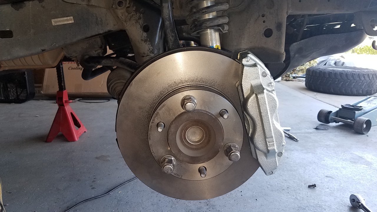

    Depending on your rim size these may or may not accommodate, but I used this kit from RockAuto on my 2001 Tacoma. Tundra Brakes. I also purchased the from Wheelers Off-Road. Everything bolts up with NO modification to the lines, bolts, wheels, calipers, or dust plate.
    My Tacoma had the larger typical five star rims on the TRD package. These Tundra calipers fit without issue. I got the smaller of the two Tundra calipers just to make sure I wouldn't have any clearance issues. The difference between the two Tundra caliper sizes I don't personally think would be noticeable on our trucks. Not starting any debates, just my opinion. However the difference between the Tacoma and Tundra brakes is huge!
