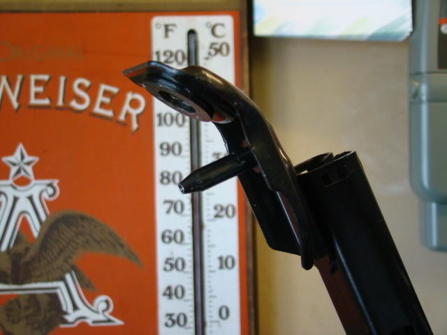

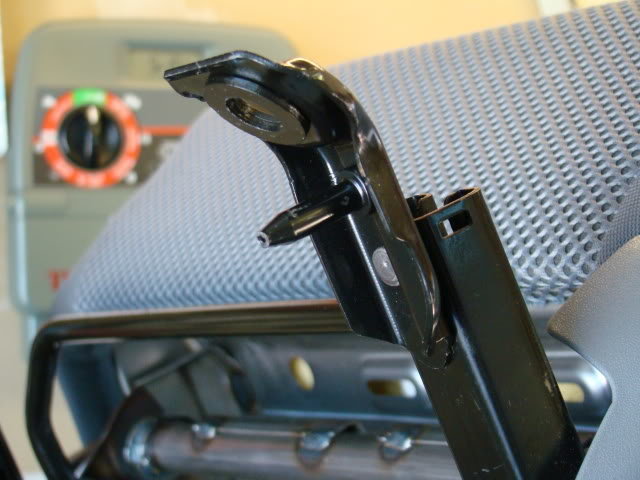

    Performed my own TSB yesterday....I had a very annoying squeak from my driver's seat. The sound was a creaking/squeaking which happened whenever I leaned forward or pressed on the break pedal.
    At first I thought it was the seat tracks or the seat cushion but I found a TSB for it so I thought I would give it a shot. I am past the 36k mile warranty so I had to do it myself.
    After finishing the annoying squeak is GONE!
    Here are a few pics of what I did and copy of the TSB so you can DIY!
    Items needed:
    - Dremel, Hacksaw or any type of cut off tool.
    - Sanding Drum or Grinding Stone for Dremel or a file.
    - BLACK Touch up paint
    - 2 Small Felt pads (not in TSB but I added them to the process, see pics below).
    1. Remove the seat from cab. There are 4-14mm bolts plus a couple connections to unplug under the seat (at least for my '06 Sport). Sorry no pics.
    2. Place the seat on workbench or floor.
    3. In these pics you can see the 2 pins on the seat track. These need to be removed. They are only there to ease installation of the seat during manufacturing. They serve no other purpose so they are ok to remove.
    4. Cut off the pins with your cut off wheel. I used a Dremel with a Fiberglass Reinforced Cutting Wheel. Cut as close as you can to the base of the pin without scratching or cutting the seat track.
    5. Sand what's left of the pin getting rid of any sharp edges. I used a Dremel with a Grinding Stone attachment.
    6. Clean the area thorougly then apply touch up paint to the bare metal areas.
    7. I added this step just in case the pin still touches the floorboard on the truck. I used 2 felt pads and placed them on floorboard covering the holes of where the pin used to insert to. Not sure if it helped but it doesn't hurt to have some additional padding.
    8. Install the seat back into the cab and test for squeaking. If it didn't get rid the squeaks you just wasted about an hour of your life. :p
