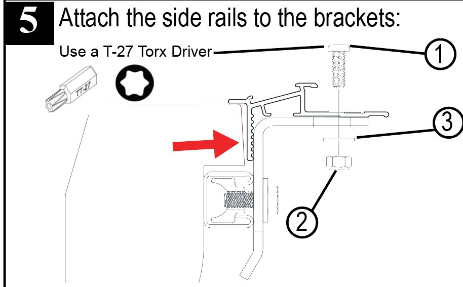

    I don't think the OP is on the sight anymore, but I remember another thread about the Truxedo covers where they changed the extrusions a little to prevent what the OP's problem was. I bought my cover in January of 2020 and it installed flat and only leaks a tiny bit at the front of the bed. I could probably seal it up with a little RTV sealant, but it's not enough for me to worry about. I picked up a half dozen cement bags the other day in a rain storm without any problem.

    From the pics, it looks like yours is also raised a bit on the back end and not flat. I got mine this month. Anyway to check if they sent me an old version or a new one?

    On the bed side rails the foam weatherstripping is smashed down equally from front to back, it doesn't have the same issue that the OP's cover had. The raising at the front and rear of my cover is from the large rubber seal that sits on the tailgate or front rail. I pulled the images below from the Tacoma Supplemental directions, and the rail in the picture is not the rail that my cover came with. My rail doesn't have the ribbed flange at the bottom. I don't know how to tell the age of your cover, but if you bought it new, I can't imagine it being older than mine which was built the month that I ordered it.
